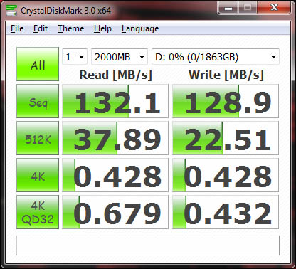

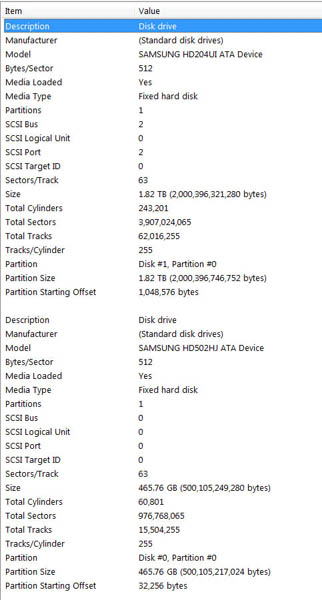

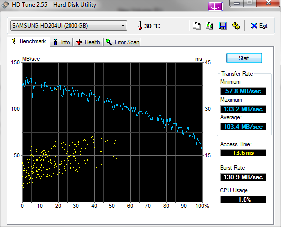

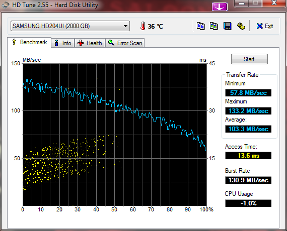

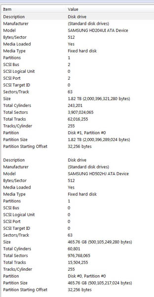

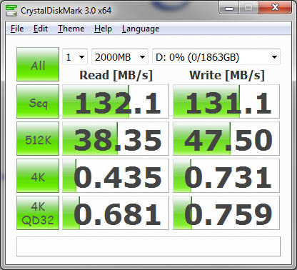

I think we have enough info to put its suitability for unRAID to bed.  Here is what I did.  On my benchmark, I tested the HD204UI with an aligned partition (2048) and with an unaligned partition (63) for a 4k drive.
I ran HDTune and Crystal Disk Mark each time.
The HDTune results are almost identical whether aligned or unaligned.  Either way it was 103.3 MB/sec average transfer.
However, CrystalDiskMark brought out the difference.  Sequential read/write was almost the same aligned vs unaligned.
However, the 512k and 4k random tests brought out the difference.  The write speeds were roughly half when misaligned.  This was similar to what was observed with the EARS drives.
And to compare the two (EARS vs HD204UI), I would have to say that I think the EARS drives come out on top.  Compared to my benchmark on the EARS, the HD204UI had a sequential transfer rate about 10MB/s faster.  However, the HD204UI is much slower at the random data.  Even when aligned, the 204 was about 20 MB/s slower on 512k writes, and about 10 MB/s slower on reads.  The 4k transfer on the EARS drive is about 5% faster vs the HD204UI.  Overall, I would say the EARS is a slightly faster drive.  For the same money, I would rather have the EARS (strictly from an aligned perspective).
