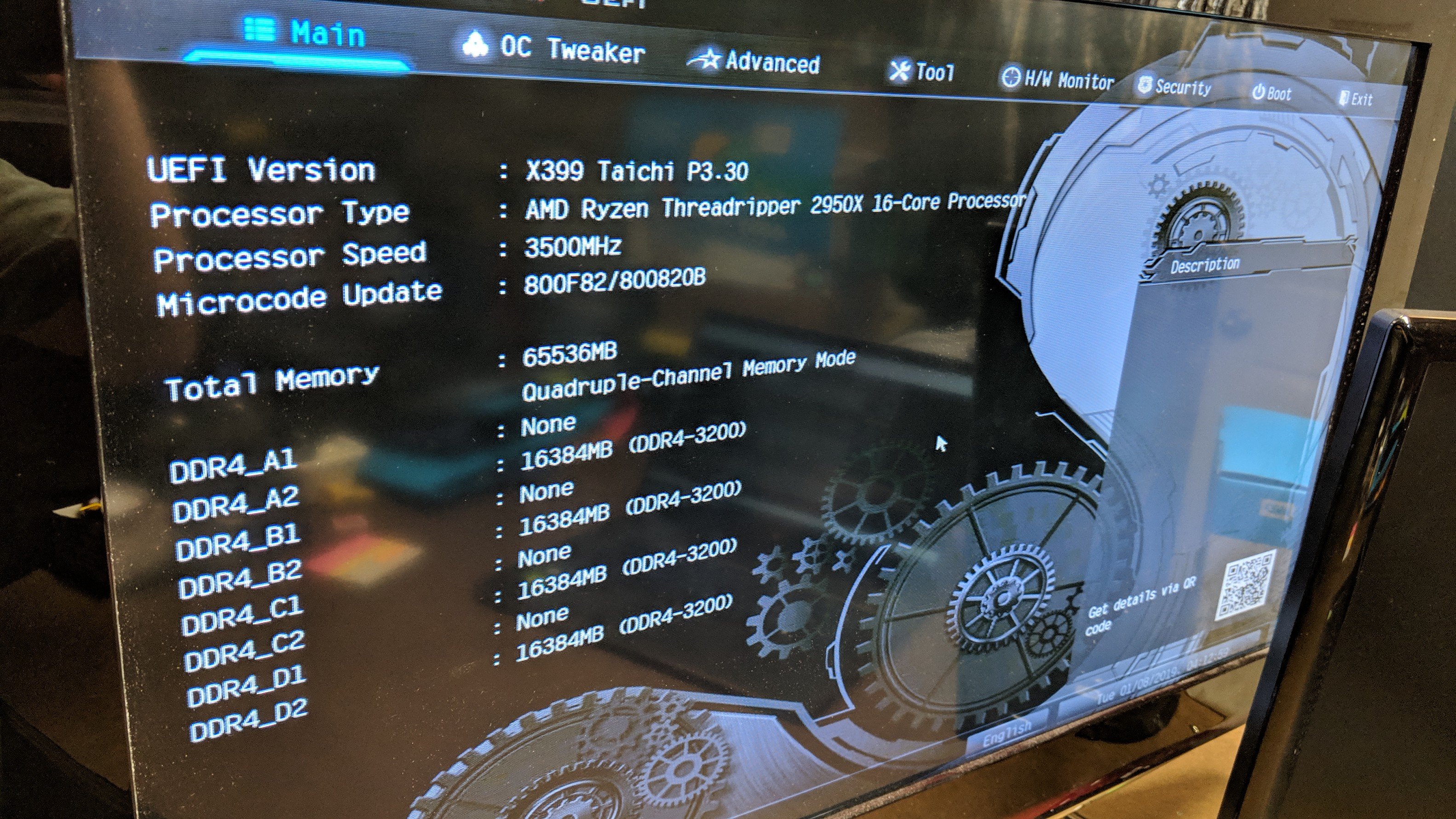

BIOS is showing Quad Channel now and it was freezing like crazy on POST, so I went in and switched the Memory profile to "Auto" and it seems stable and showed DDR4-3200 for the speed.
Does the information attached (txt) support what BIOS is reporting? Is there a better setting I should be using?

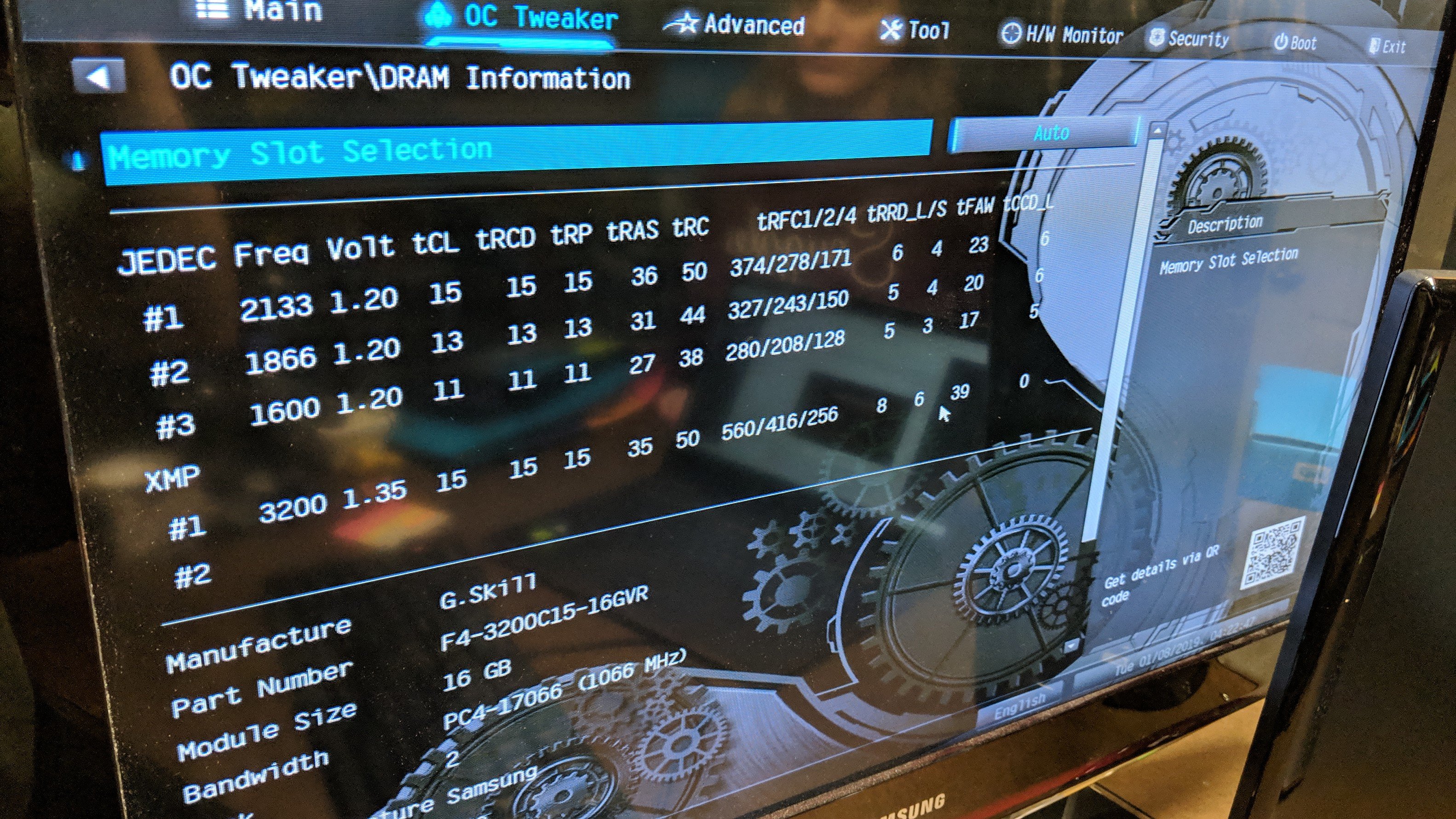

In your 2nd BIOS pic. bottom, it show (1066MHz) and match DMI txt show 1067 MT/s. ( That is 2133 )
Some report also say DMI info. not always correct.
Regard your stick haven't JEDEC 2400, 2666 middle profile.

Sorry misunderstand you have 8 stick now, that's weird 4 stick can't run in stock freq. According manual, 4 stick in A2/B2/C2/D2 was correct.
Could you confirm they run in 1.35v (XMP) or try manual set memory voltage to 1.35v.
Pls also verify timing parameter does correct recongize and match with XMP profile.

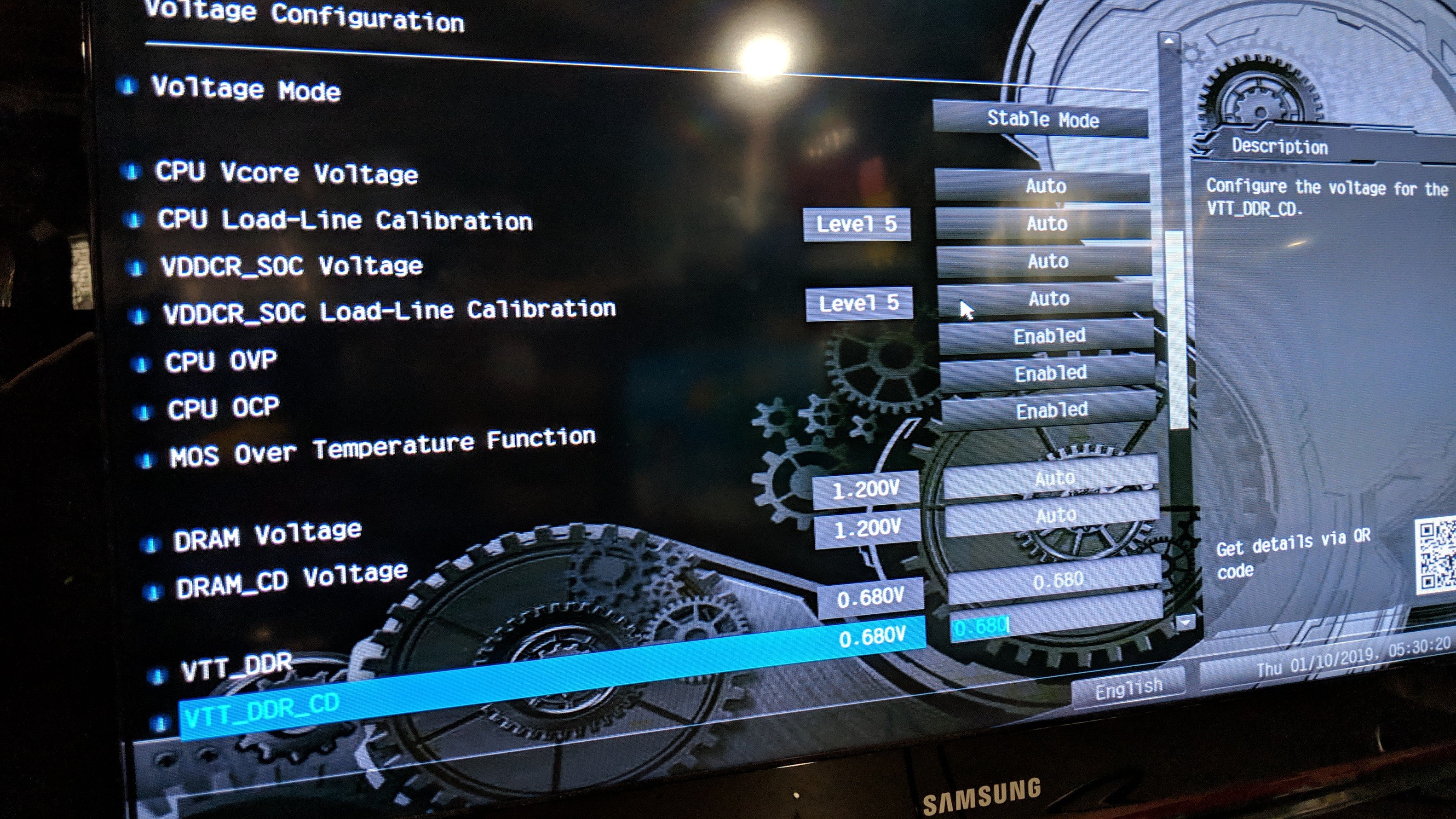

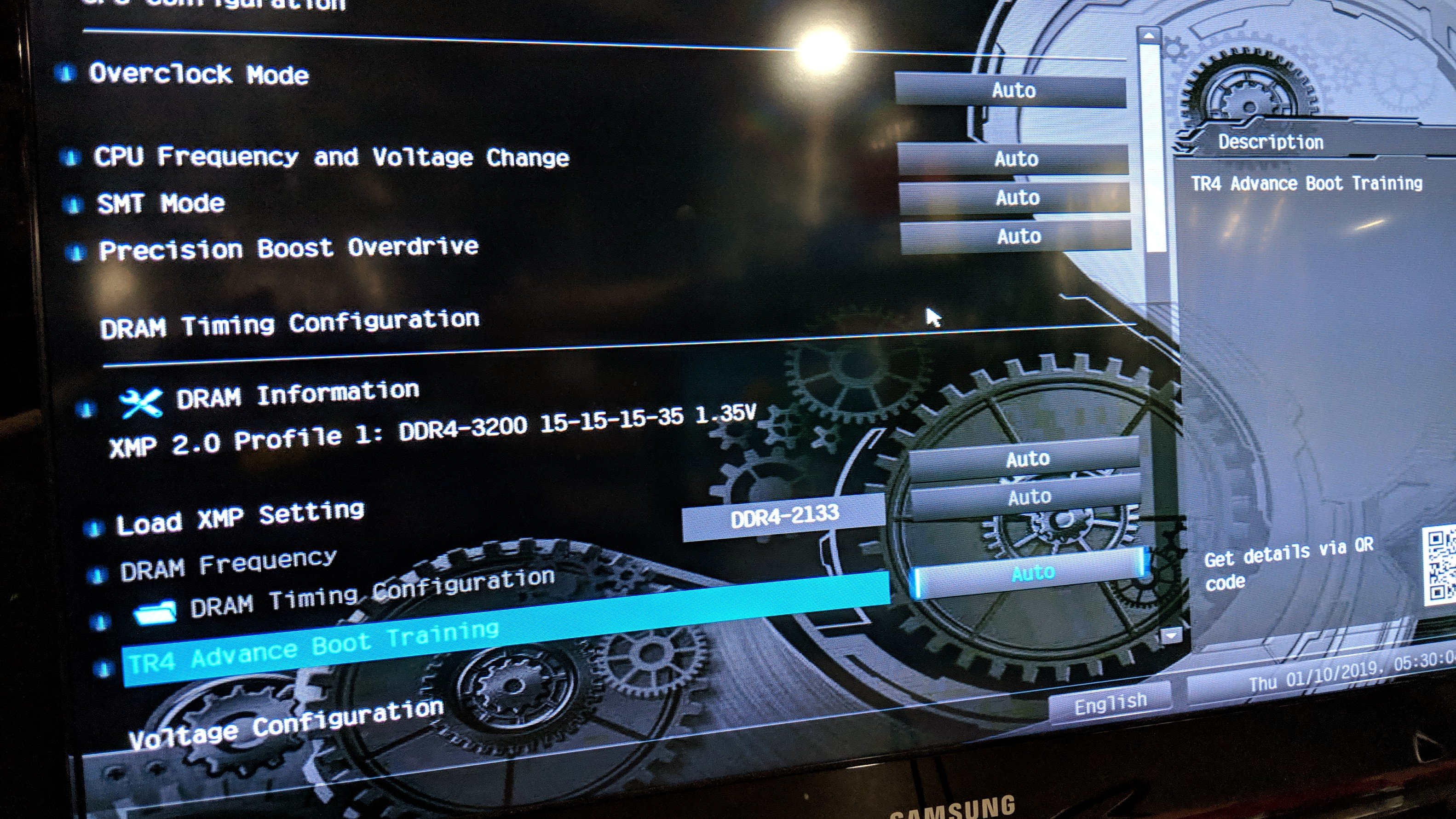

No I'm running 4 sticks. Let me take some new pictures from BIOS. That second picture might have been prior to switching profiles now that I think about  it.
TR4-INFO04.thumb.jpg.5c81d1f8f5bbbb97c34abcc300c98669.jpgTR4-INFO03.thumb.jpg.e103802cc6abaa8caeb094248e352e40.jpg
Edited by blurb2m
Added pictures
Suggest set memory to 1.35v first ( avoid freezing like crazy on POST ), then tweak "Load XMP setting" from AUTO to other i.e.3200, and change/check other memory relate setting if need.
Your memory now in 1.2v
Edited by Benson

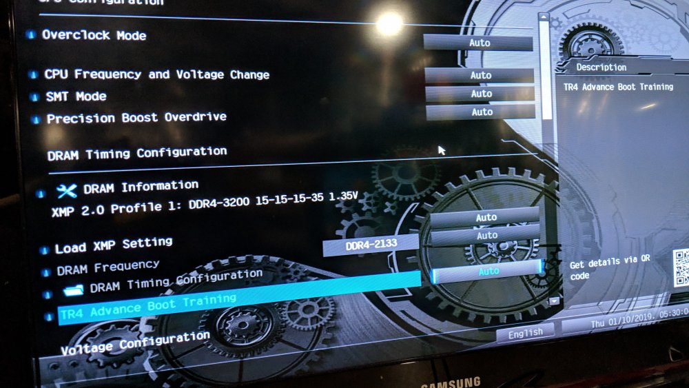

Changed Load XMP setting to XMP 2.0 Profile 1 (3200) and voltage to 1.35.
Voltage auto-set when I changed to XMP 2.0 Profile 1.
Unraid froze about halfway through bootup.
Stopped at:
sev command 0x4 timed out, disabling PSP
SEV: failed to get status. Error: 0x0
So, I think when I changed to AUTO it had not updated yet the other day to show 2133 and 1.20v. It has been stable for a day at those lower clock settings.
Not sure of what else to change to get it to run 4 sticks at 3200.
What my limited knowledge has gathered so far:
2 sticks @ 3200 and 1.35V = stable
4 sticks @ 3200 and 1.35V = unstable
4 sticks @ 2133 and 1.20V = stable.

I have been slowly increasing the clock speed and got up to 3066 stable on the 4 sticks. If I try going up to 3200, it freezes up on me after about 10 seconds into unRAID boot.
I'll stick with 3066 for the time being until I can learn more about clocking these monsters.
