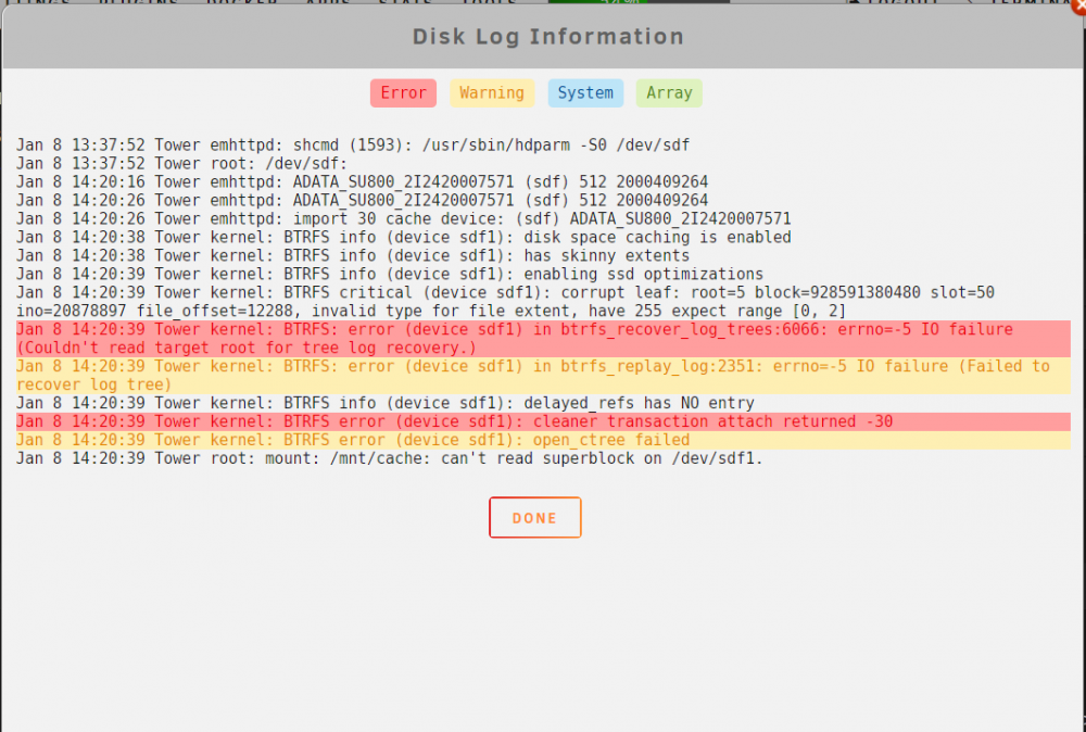

I noticed my 1 GB SSD cache drive was showing "Unmountable: No file system". I tried to use this guide I'm not sure I'm doing it right and I'm concerned I may screw something up.  Can someone ELI5 how to do this?  Here is my setup  I've also attached the diagnostics and the error log from SSD.  Thank you in advance.
tower-diagnostics-20190108-1935.zip

I've tried the guide, but I'm not getting anywhere.
can anyone help me with this guide and walk me through what each item should read
mkdir /x  what should x be?
mount -o recovery,ro /dev/sdf1 /x     I used sdf1, but again not sure what x should be
thanks a lot
it can just be x or any other name you want, it's just for a temporary mount point
Thank you for the quick response, I just tried that and got this error
mount: /x: can't read superblock on /dev/sdf1.
Do I need to have my array in maintenance mode?
I really appreciate the help!
That means the superblock is damaged, try the mount -o recovery option and/or btrfs restore with a backup superblock, though a damaged superblock implies severe corruption, so recovery not so likely.
