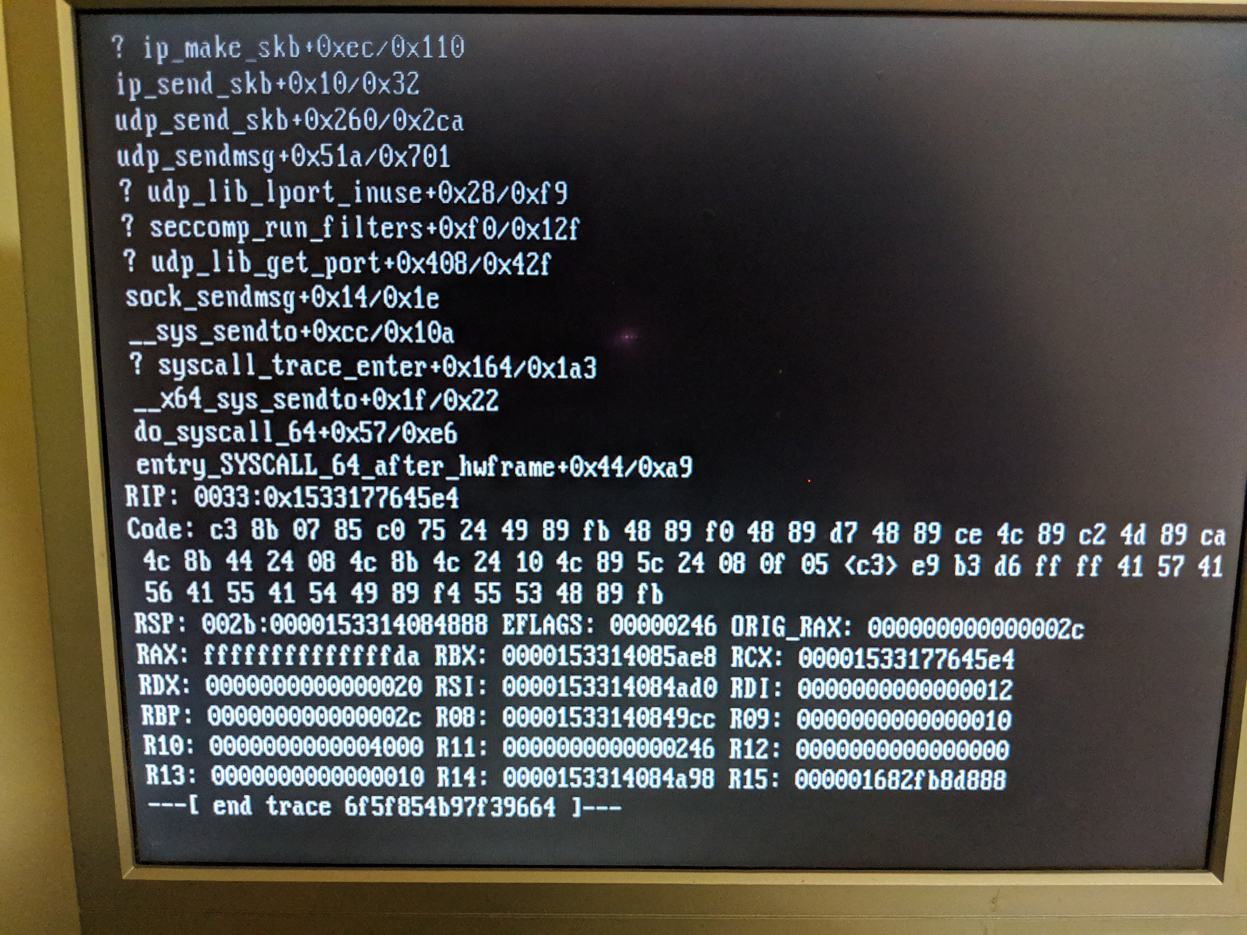

first thank you community for helping me so quickly with my previous issues! It is much appreciated.  Unfortunately I need to rely on you all again as I stumbled on this issue with my server last night. My Unraid server was unreachable, I connected a monitor to it and took the picture you see. I had to reboot the server twice. and then drive sdf had about 700 errors on it. I ran a smart test and it passed. I did an xfs repair on it and I am now re-adding it to the array. I have attached the photo and my diagnostics zip file. I am very curious as to what caused the issue on the server. Also I am concerned about the health of drive sdf.  Any help would be much appreciated.

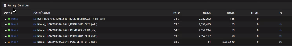

The errors I saw was on the Main tab of unraid where it lists the read, writes, and errors.
(Current screenshot, won't show error number as I am re-enabling the disk)

The Reads, Writes, and Errors columns reset when you reboot, so that is why Errors are zero, not because you are rebuilding. Those columns are actually good indicators of the rebuild. Errors should always be zero, but when rebuilding, the disk being rebuilt will get a lot of writes, and all the other disks will get a lot of reads. Just as you see in your screenshot.

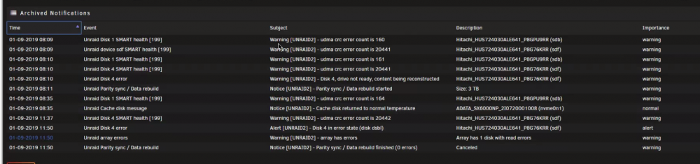

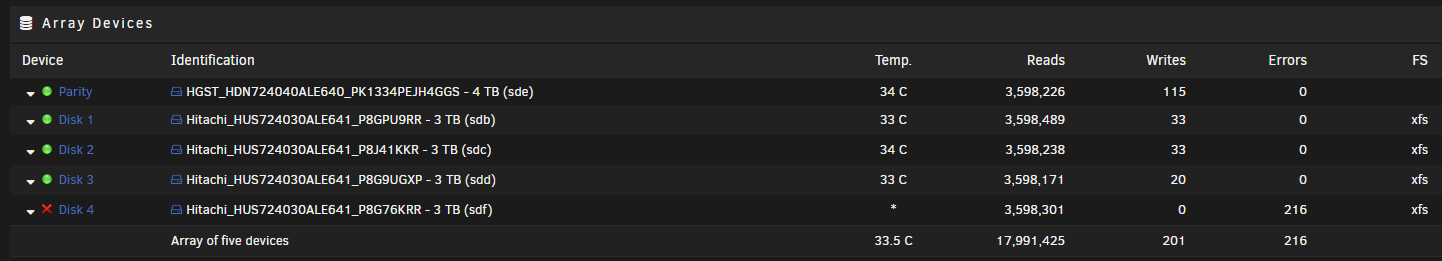

Ok so this just happened now, During the parity check/Disk rebuild of disk 4. It cancelled and gave errors on Disk 4 and disabled the disk. I downloaded the smart report again for disk 4.  I also attached my diagnostics zip file.
Usually diagnostics will include SMART for all disks so you don't have to get them separately. However, in this case, your diagnostics don't include SMART for that disk, and the SMART you attached has no information. So disk4 isn't communicating for whatever reason.
Shutdown, check ALL connections, power and SATA on ALL disks. Reboot and post another diagnostic.

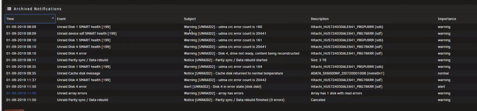

also here are the notifications thus far:

Just to be clear the Disk 4 is disabled and is not spun up in the current array state. It will not let me run a smart test in this state. Last time when I rebooted unraid it remained disabled until I re-enabled it following the process I attached earlier. Just an FYI.
Disk dropped offline, rebooting should bring it back online, though it will remain disabled, change the SATA cable when you reboot and check power cable
