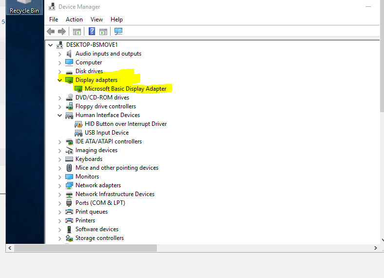

hi guys
still having problems
I have downloaded extracted the bios from the card but getting the same error image.png.4177c75f51e7463094d03e5965c956b9.png
any other suggestions?
OK so I can remotely access the VM via RDP but the card is NOT showing in device manager
