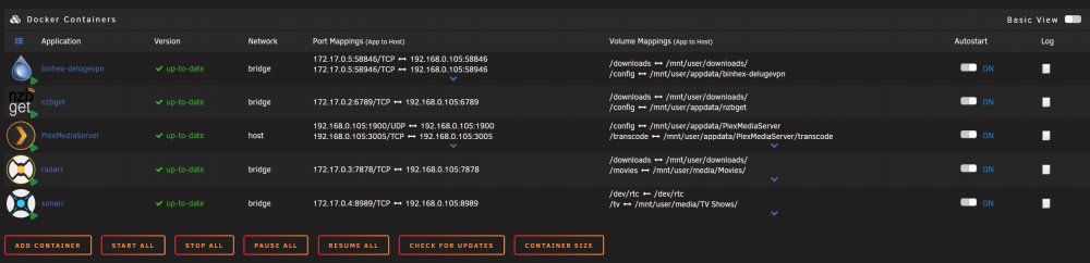

On 1/9/2019 at 11:24 PM, trurl said:
plugin probably not but 4G RAM may be a bit tight to do a lot with dockers. Which dockers are you running?
 I've attached a screenshot of my docker setup.
1 hour ago, Squid said:
I would limit radarr & sonarr (not sure about deluge -> if it runs via mono or not) to say 512M of memory and then see what happens (or ideally, add more memory to the system)
https://forums.unraid.net/topic/57181-real-docker-faq/?page=2#comment-566088
Thanks! I've applied the settings as per your suggestion and already can see a big improvement in available free RAM. I'll keep monitoring the situation over the next few days and report back if I keep running into memory problems.
