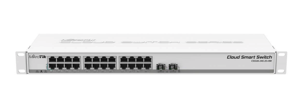

Review: MikroTik CSS326-24G-2S+RM 10gbe switch
I don’t typically write reviews, but there have been some enthusiastic discussions about MikroTik’s switches lately, especially since they are much cheaper than expected. So I thought I’d share my experience with their CSS326-24G-2S+RM, a 24 port gigabit switch with 2 sfp+ ports.
1423463646_ScreenShot2019-01-09at5_29_53PM.thumb.png.5d2b23c7789fc20fa0bd7f5f4786f20d.png
Originally I wanted to purchase a CRS305-1G-4S+IN but they are either currently sold out everywhere or 50 dollars over MSRP. [UPDATE: I bought one... review is here:
So the switch arrived. The metal appears a bit thin and the paint job isn't really durable. Putting in screws into the ears (with plastic washers) already removed the paint around the screw holes.... The gigabit ports feel "loose" to me vs my quanta, or even any other d link/comparable consumer switch I've had, and I've had to readjust a gigabit cable seating once or twice as it didn't show connected on the simple lighted panel below the ports. It's cheap and feels like it. But for me, that's ok if it works. And it sort of does?
I followed the directions to access the web gui. Nothing happened. The directions were simple: “go to 192.168.88.1 and you’re there.”(more details on everything I did can be found on their forum here: https://forum.mikrotik.com/viewtopic.php?f=17&t=143728   I don't fee like rehashing it al here, but long story short, nothing will allow me to connect to the web gui. ) The switch was operational, as in, I could pass traffic through it, but not modify any of the limited settings or update firmware due to lack of GUI access.
So I returned that switch assuming it was defective and another showed up. Same issue.
I contacted email support who informed me that when the switch is placed in a network with a DHCP server, it will get an IP and the web gui will be there. Protip for Mikrotik: That would have been nice to know in the one page of documentation that came with the switch AND/OR online anywhere…. Except, that didn’t actually work either. My router would offer an address and the switch would not respond to the DHCPOFFER. None of my other devices on the network have this issue, so I know it's the switch.
Support also told me I could use a serial cable to find out what ip the switch was using, except this model doesn’t have a serial port….. thanks again for the assistance. This switch also currently “works” but without the ability to adjust any settings like before. I’m very tempted to return it and change all my devices over to 10gbe ethernet since I already wired my house with cat 6a. It would cost more, but work most likely work properly. I have been so let down that I haven't even really tried to push the sfp+ ports to see what their real saturation numbers are yet.
So, you get what you pay for I guess. I’m currently waiting for a followup from support and as of writing this, only one person has offered some advice on the their forum but it did not lead to a resolution. And digging through other posts on that site, it seems that their products are hit and miss, and more times than not, software updates break things.
A bit disappointed.

A chance comment on the Mikrotik forum lead me to a discovery. While I had changed my ip and subnet to be in the same range, I had not thought to change the gateway to the default ip of the switch (as I’ve never had to do this before with similarly configured devices.) Nowhere does this requirement appear in Mikrotik’s documentation or anything I read online.
After making this change and putting my ip in the same range of the default ip of the switch again, I was able to finally access the web GUI.

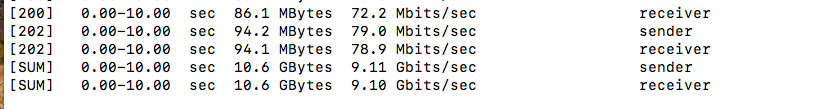

Ran some iperf tests on it, from an osx vm on one unraid server using a solar flare card (passed through to the vm) to another unraid server running iperf via nerd tools, 10 threads:
switch showed similar speeds in the web gui
This is on 1500 frames... so some room for improvement if I bumped up to 9000, but I may also have a bent dac cable causing lower speeds.
Before posting, for fun I changed the threads from 10 (above) to 100 and pushed it to:
still on 1500 frames.

It has no fan and is quiet, but runs quite warm within its parameters. The specs say the switch is rated up to 70c. Mine hovers around 64-66c. This is even after pulling the top cover off and letting air circulate over the heatsink. So I do have a few concerns about longevity if it's hanging out at the top of it's range. There are no (visible to me after a quick look) places on the board to add on a small fan. But hitting it with multiple runs of iperf didn't really move the needle on temps. So who knows....

SO I've been using this switch for a little over a year. It has given me no issues running about 16-20 ports of gigabit lan fro the house and a 10gbe trunk from my server. Quite pleased, really. I don't really know what else to say... I guess we'll check back in a year from now (if I remember...)
