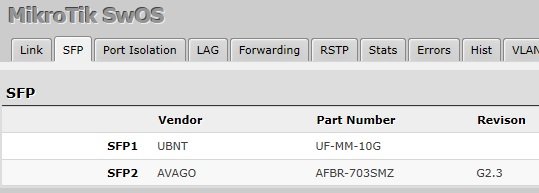

I was afraid of this.  swOS sees the transceiver just fine.    Reports the correct brand, part number, serial,  tx bias, power and rx power.

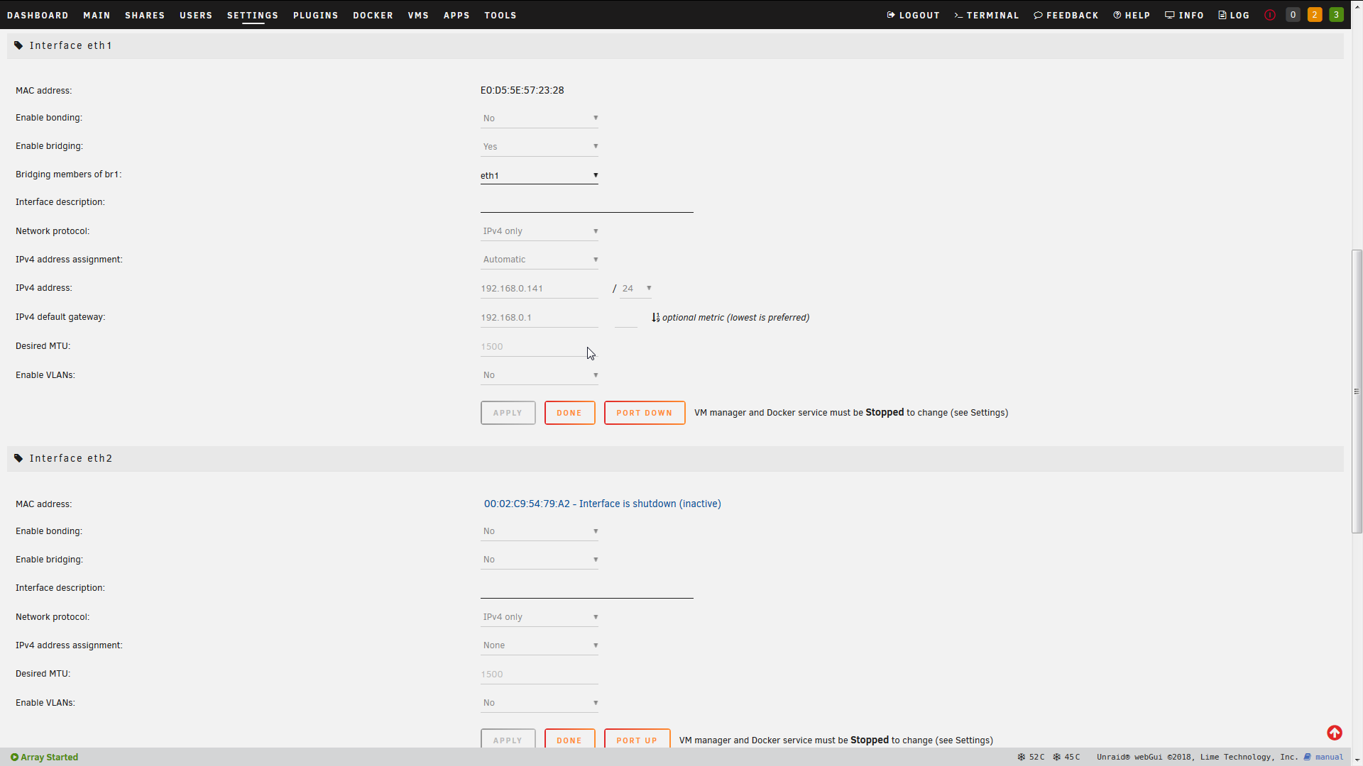

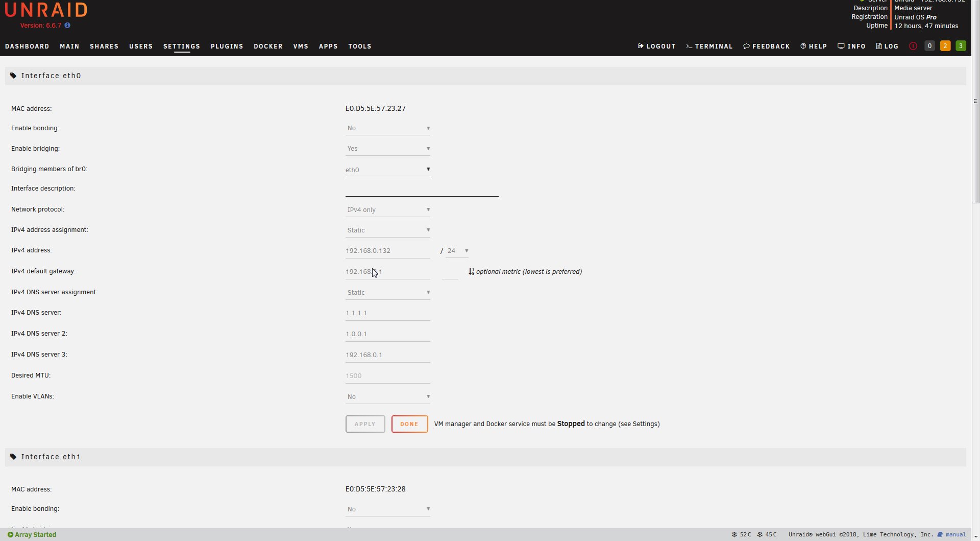

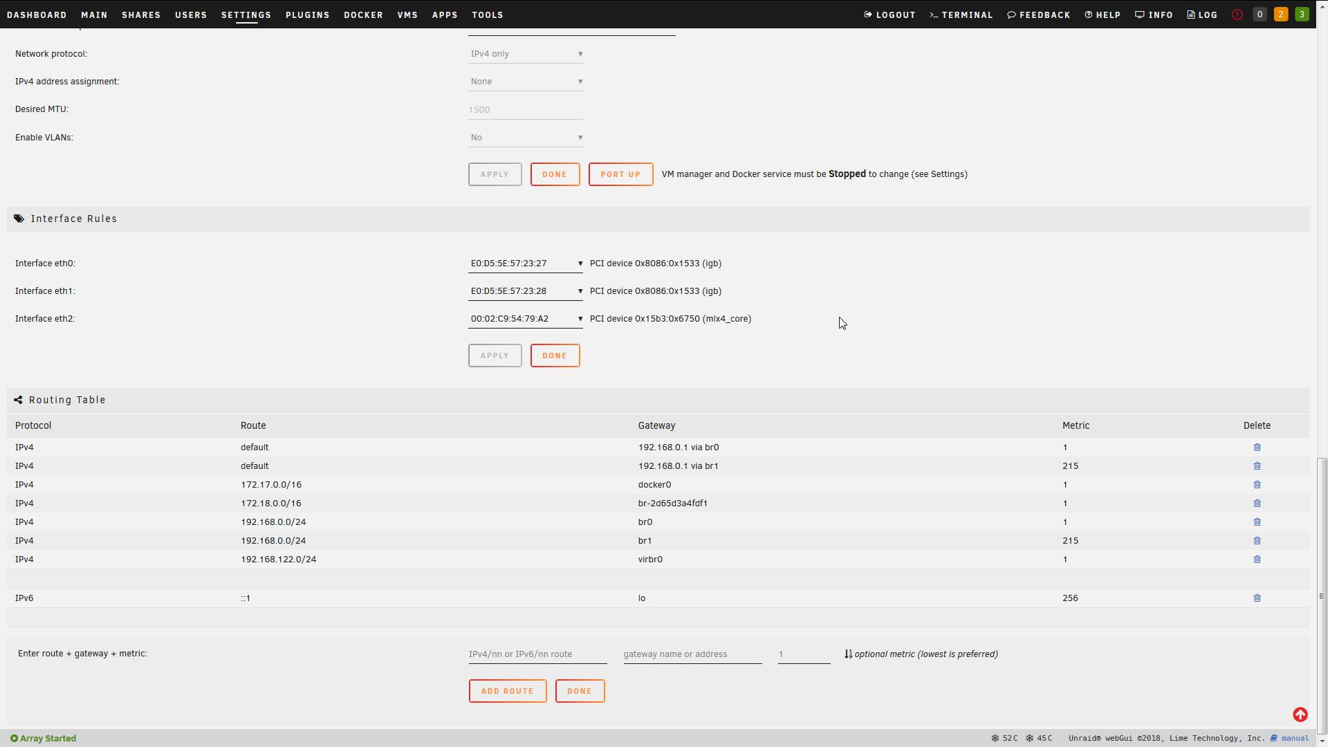

The card is visible on unraid.  In fact, I can select it for my windows vm, as it appears available as a network nic.
Attached are screen shots of network settings page.   What do you need from the diagnostic?

Pls click "port up" on eth2, if you no need 3 NIC then config the 10G NIC be 1st or 2nd interface.
Edited by Benson
Tried to enable the port but get the following message: Interface Ethernet Port 2 is down. Check cable!

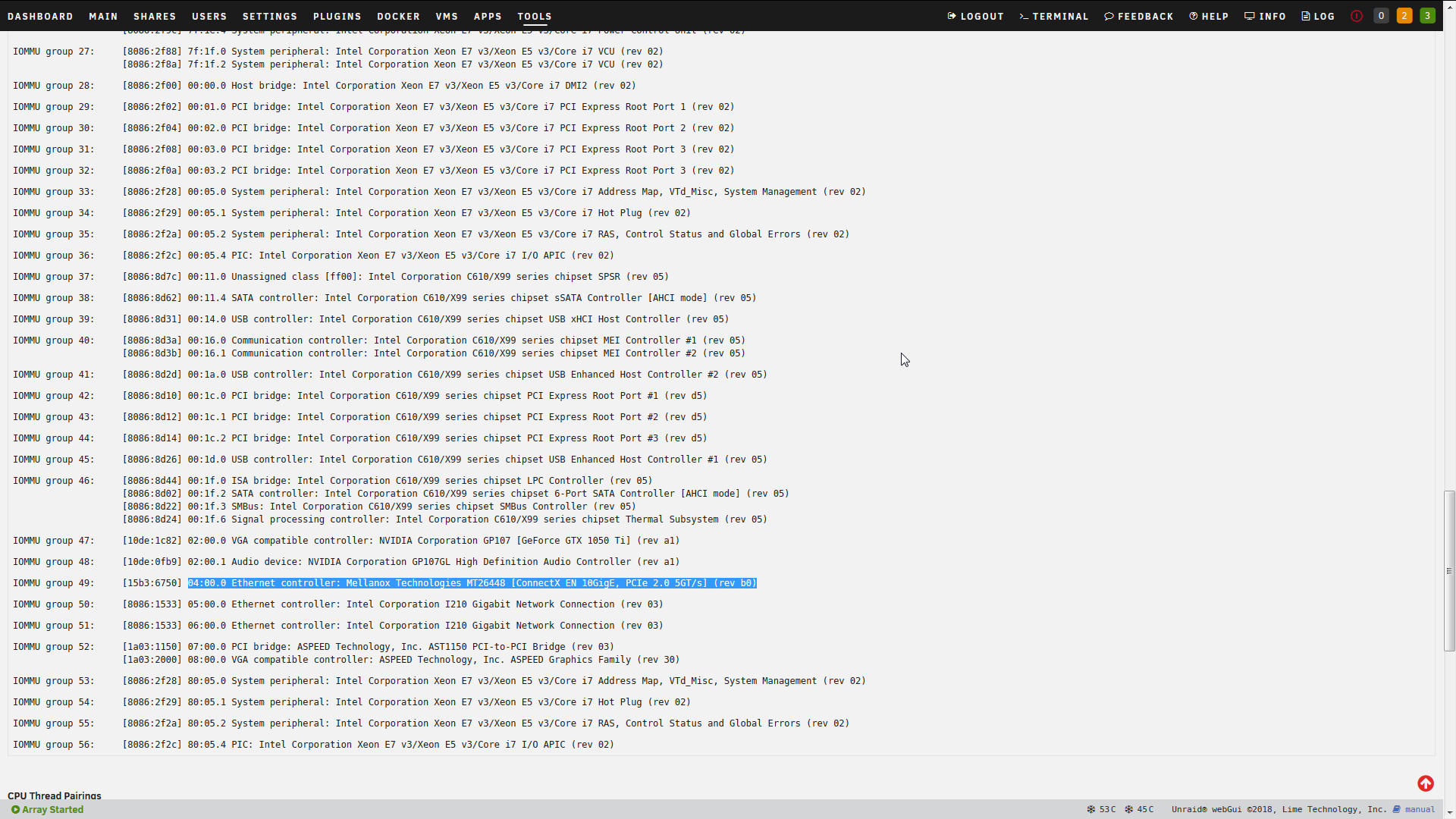

The NIC passthrough or used by VM (vfio-pci) ?
04:00.0 Ethernet controller [0200]: Mellanox Technologies MT26448 [ConnectX EN 10GigE, PCIe 2.0 5GT/s] [15b3:6750] (rev b0)
    Subsystem: Mellanox Technologies MT26448 [ConnectX EN 10GigE, PCIe 2.0 5GT/s] [15b3:0015]
    Kernel driver in use: vfio-pci
    Kernel modules: mlx4_core
In, ethtool.txt, ifconfig.txt, no show of this NIC.
It is selected in Window 7 vm, but does not see the nic as mellanox, but as a virtual adapter.
