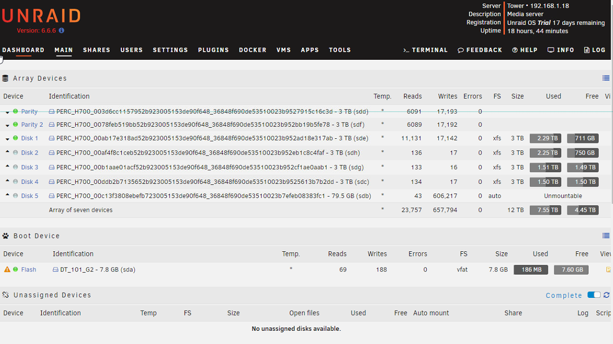

New user here in trial period. So far I'm pretty impressed with Unraid and think I will be moving to the licensed version. After comparing FreeNAS I think Unraid is the more flexible solution for my needs.
I've sucessfully created an array with 4x3tb drives and dual parity. I have a separate SSD intended for VMs but I think I incorrectly added the SSD to the array which would not be the recommended approach? Using the unassigned drives plugin is the better method? I do not use the SSD for cache, this is purely a media server.
So now I need to remove the ssd from the array, but I'm confused as to the best approach. My ssd is not mounted yet so do I have to rebuild the parity since it shouldnt be affected? I looked at the options here and am unsure of the best procedure:

I wouldn't bother with "Clear Drive then Remove" method. It isn't going to save any time and can be difficult to get right. Just rebuild parity.
Tools - New Config, Retain All. Then unassign disk5, DON'T check parity is valid box, start array to begin rebuild. You can deal with SSD after parity rebuild completes.
