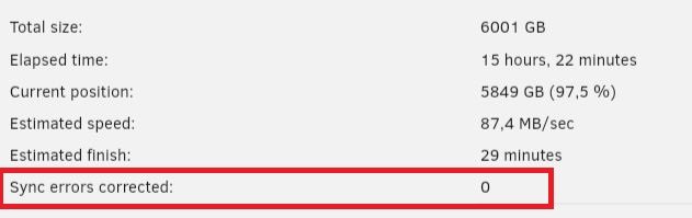

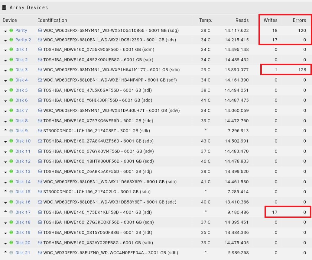

Sorry, but I do have a hell of time interpreting the wordings around parity checks and disk rebuilding on a dual parity system. Please have a look at these three images. I took them during and after a correctional parity check:
- Img1: During correctional parity check parity-disk1 and data-disk3 throw read errors. This kind of error is mentioned in this thread already.
- Img2: Status during parity check says "0 sync errors corrected".
- Img3: Result after parity check says "0 errors found".
I don't get that. On the same "Main" page I see "248 Errors" that are not corrected and lead to no errors found. Really?
If I look closely I do see 17 writes to disk17. That was an image I did copy during parity sync. If I do ignore these I see one write access to disk3 (the data-disk with the read errors). This write access is not written to parity-disk2 but written to parity-disk1.

It will retry and sometimes succeed so the errors might have eventually resulted in correct data.
After retries if it still can't read a data disk it will get the data from the parity calculation and then write it back to that data disk.

I see the errors in syslog but SMART attributes for both disks look OK. I would do an extended SMART test on both.
In this case read errors were correct by parity, so all is well, except parity and disk3, parity you already knew it was failing, disk3 appears to be failing as well.
