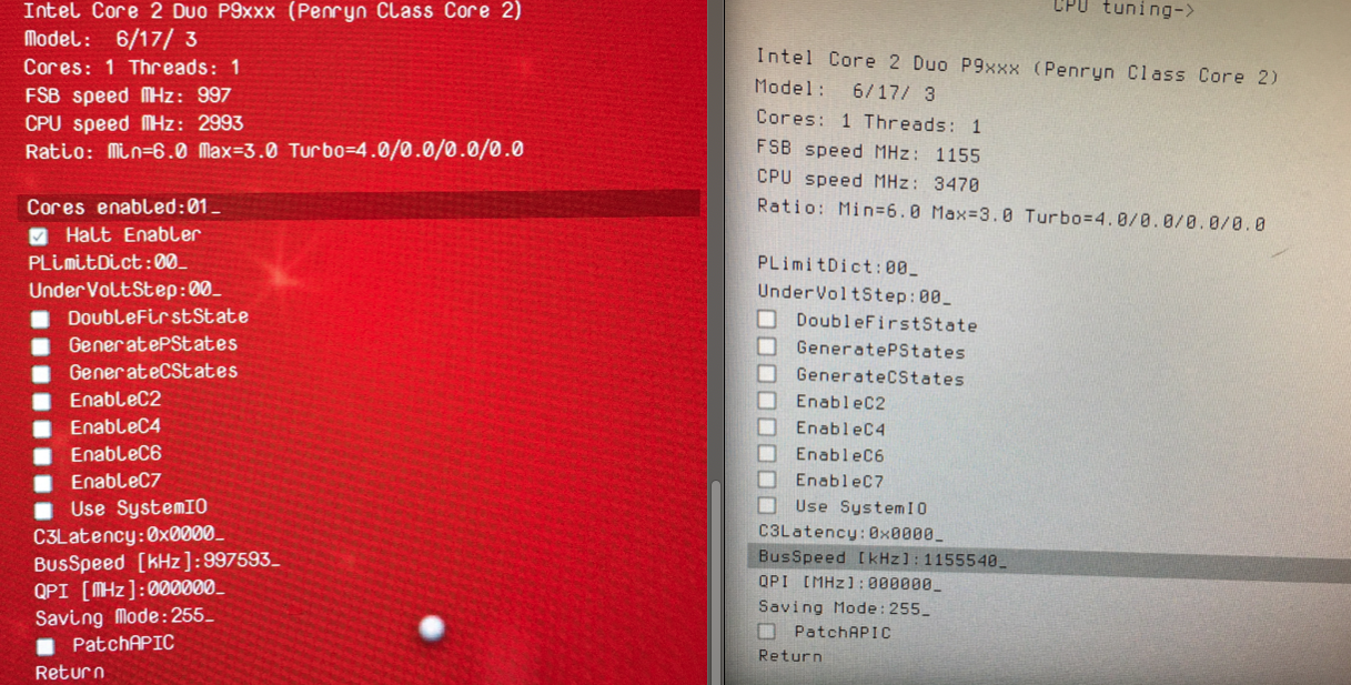

Hey All! Glad to be a part of the unRAID forums, best OS ever. Anyway, was hoping one of the experts over here could help me out. I managed to get an OSX virtual machine running really well with GPU acceleration and everything seemed to be working well until I tried to play audio. Using voodooHDA, my bluetooth and onboard audio devices have this really horrible crackling and distortion, it's totally unlistenable.
Here's my build:
Asrock X399 Taichi ultimate + TR4 1950x +16GB G. Skill Ripjaws (I know, not enough RAM) + gtx 1080/960.
My windows vms work great, as do the limited linux vms I've tried. I've followed numerous guides to fix this issue, starting with Gridrunner/Spaceinvader's latest guide to build a Mojave/HS vm.
From there, I tried:
https://www.tonymacx86.com/threads/audio-realtek-alc-applehda-guide.143757/ - This didn't work, as I couldn't figure out how to make any of the applicable fixes work on my x399. Didn't seem compatible.
I tried - https://forum.amd-osx.com/viewtopic.php?f=24&t=4880 - made a post on this thread but didn't get a response.
also tried - https://forum.amd-osx.com/viewtopic.php?f=23&t=4642 - basically the same thing but without a script to potentially break things.
When following the second guide, I receive the following error in terminal:

Did some CPU tweaking, but after rolling back to stock CPU and RAM clocks in BIOS/clover and setting the VM to cores 0-3, 4-7, 8-11, and 12-15 did nothing to fix audio on VoodooHDA. I tried adjusting the bitrate through Audio midi devices, but usually testing with System Preferences just made the whole VM crash and require a full reboot of the system since I can't properly reset my audio device.
As for native audio, I did manage to make some tweaks and get my audio device recognized as HDEF:

Welp, didn’t originally have my CPU cores isolated. Doing this helped quite a bit, after isolating cores 4-7 I managed to combine Some tweaks with Audio Midi Devices and clover config to get my 3.5 audio in a *workable* state. I even ran lstopo to ensure I had the cores closest to my GPU and RAM and minimize latency.
Still tweaking FSB speeds, as there’s a measurable loss in quality when leaving it blank.  Seems to be a sweet spot somewhere between 99.44MHz and 99.99MHZ. That’s a LOT of reboots and EFI mounts to work out, but sounds better than bare metal installing Windows just to run CPU-Z for FSB speed.
That information is available in the clover boot menu under options>cpu tuning. this image shows 2 different ones I run on 2 different servers. I don't notice any improvement in changing bus in cinebench or in Geekbench.
1191449766_ScreenShot2019-01-21at9_21_44AM.thumb.png.76ec28886aedbd14675fbd82b25fb265.png

On 1/21/2019 at 6:03 AM, 1812 said:
Are you passing through a bluetooth usb device or a usb card? (looks like usb device from the previous xml) if only the device, might try looking into passing through a usb card, or passing through a part of your usb bus. there are  several usb cards that work with macos and are pretty cheap.
Actually I’m using the internal Bluetooth/WiFi, but it is USB-attached. From what I’ve read the wi-fi isn’t compatible with MacOS so maybe I just got lucky on Bt, kind of?
