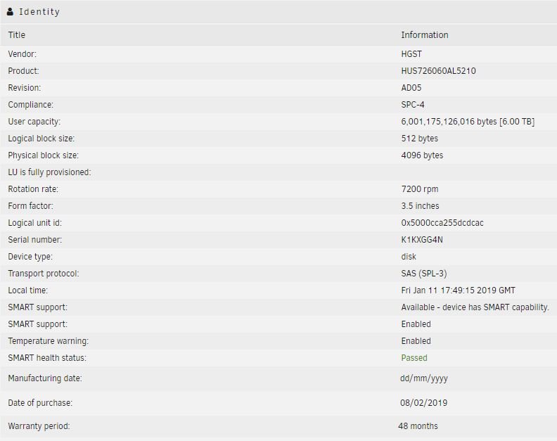

I have an LSI SAS 9201 8bg/s Controller Card and I have connected 4X SATA Drives on 1 Port and 1 X SAS Drive (12gb/s) on the other.

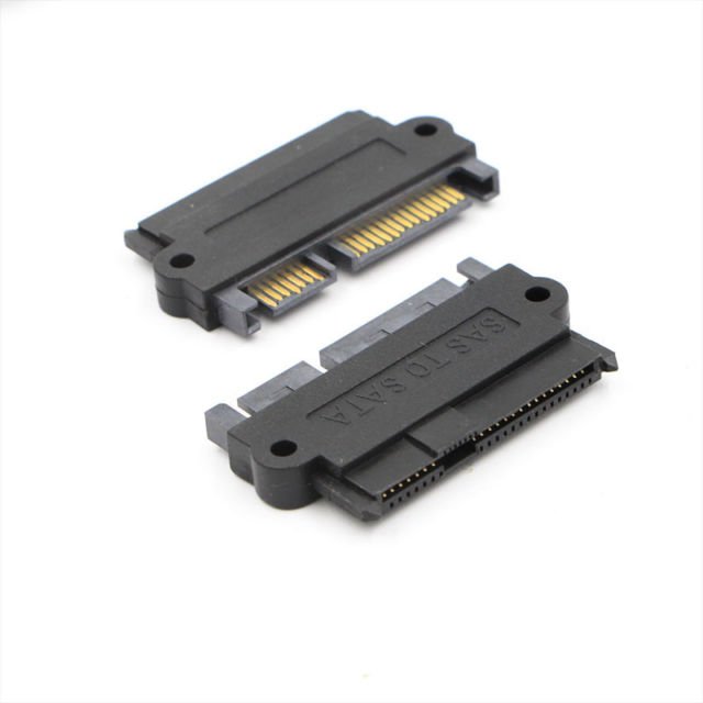

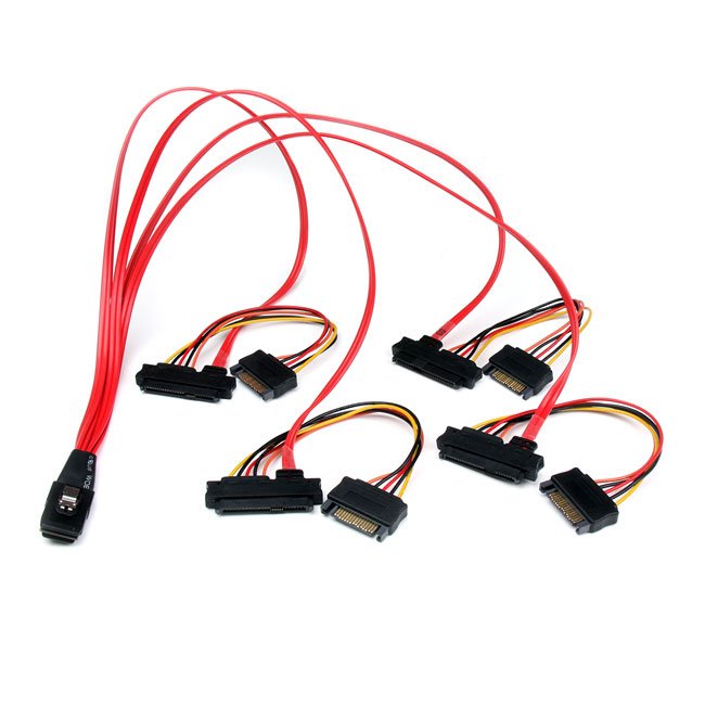

I have connected the 4 Sata Drives using a mini sas to 4 X Sata Connectors and the SAS Drive using another the same with a SAS to SATA dongle adapter.
My Question is will I be losing any benefits of the SAS drive conneting this way?  I am looking for a 12gb/s Controller at the moment but can't help but wonder if I am using the correct cable to connect the SAS Drive?
There shouldn't be any problems, though in some rare cases a problem with a SATA drive can cause issues on the the remaining drives, like timeouts, including on the SAS drive, but this would also happen if your were only using SATA.

There are 2 ports on the 9201 SAS Card, 1 port = 1 cable split to 4 connectors
I currently have 1 port with 4 sata drives & the other port with 1 SAS drive, if I were to add SATA drives onto the same port with the SAS could that cause any issues?
Many Thanks again for your time taken to reply!

2 minutes ago, mbc0 said:
Can I ask if there would be a problem mixing Sata & SAS?
Same as the above reply, it's no different if they are on the same miniSAS cable or the same controller.
