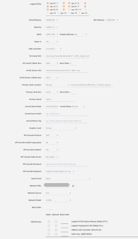

I'm trying to get GPU passthrough working on Windows 10The VNC connection was used to setup the virtual machine, which worked fine (installed the virtio display driver). When switching the VM to display through the video card, after the setup through VNC, the UNRAID login command line interface disappears and the screen turns black. Nothing happens after that.
What's interesting is that when I use the GPU passthrough with a Ubuntu 18.10 server VM, the command line appears for that VM on the screen.
Heard trying to switch from QEMU to SeaBIOS could work. However, the option to switch the BIOS is greyed out.
Solved: Turns out that the VirtIO driver hates the GPU, so rolling back the driver to the windows basic display driver through the VNC connection fixed the problem.
