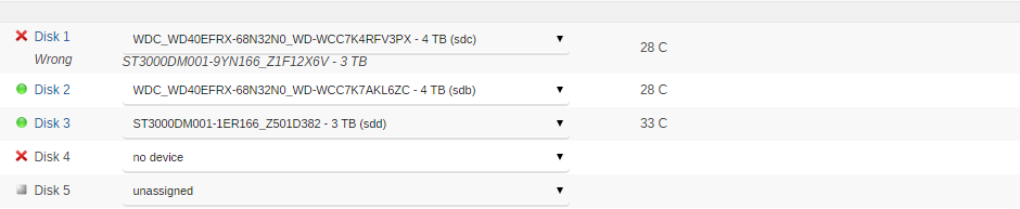

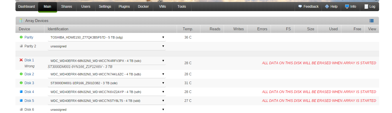

I had two drives fail back to back so I replaced them and added a new third drive.  It's my understanding that I can only rebuild one of the failed drives (since I only have one parity drive) which I am OK with.   The option to start the array is grayed out and to the left it says "Stopped. Invalid configuration."  I can't sem to find anything that will fix this.  I am running Unraid 6.3.5.  Another thing I've noticed is that the Preclear utility is not seeing the drives.
You can't replace a disk and add more at the same time, replace the failed disk first, then add more drives.
Thanks for your response!  So I removed two of the three disks and still have the same issue.  I noticed that to the right of where the Start button is it says "
Too many wrong and/or missing disks!"  and it shows that Disk 4 is missing.  Is there a way to force it to start so I can rebuild Disk 1?

With one parity you can only have one missing or disabled disk. Only one disk can be rebuilt and it requires parity PLUS all other disks to rebuild. Parity by itself can't do anything. If you're trying to replace disk1 then you will have to have disk4 and all the others.
