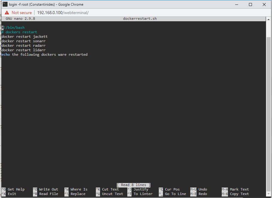

here's the script also

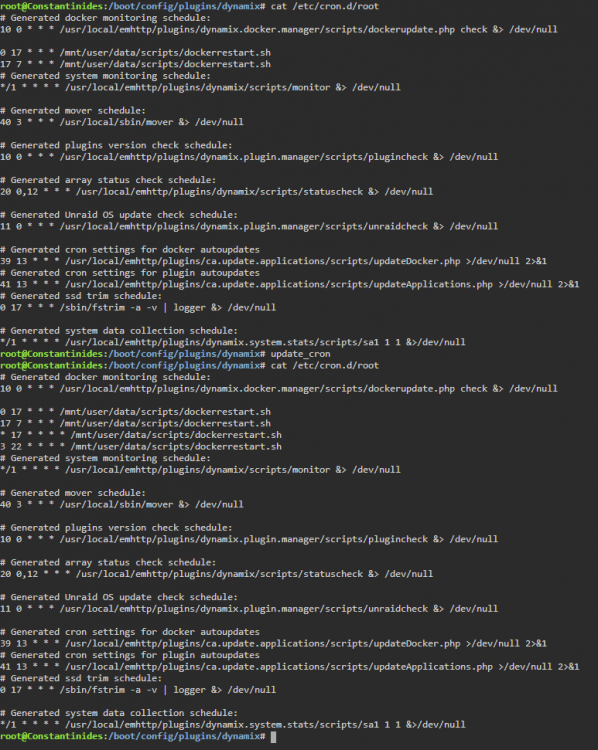

? Why. I have no cron job set for this time and why does it output an error?

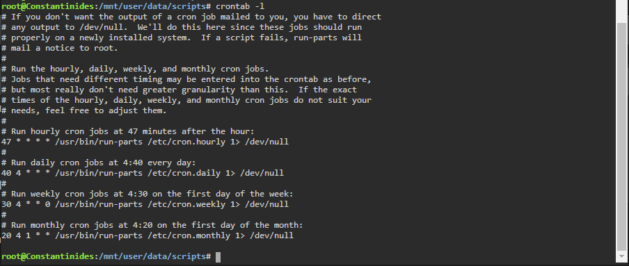

What is the output of
crontab -l
and
cat /etc/cron.d/root

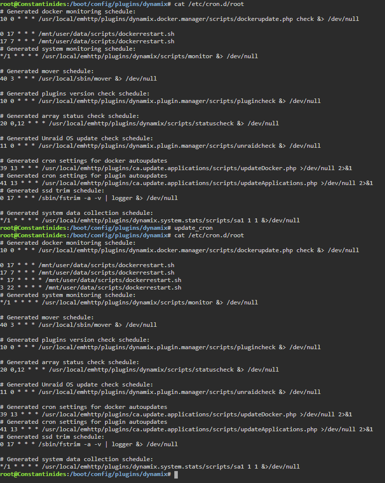

crontab -l
and
I think i will be able to fix it i will remove them and update cron. i will update you tomorrow
I just remove the 2 lines before # generated system monitoring schedule it save fine but when i update cron they come back

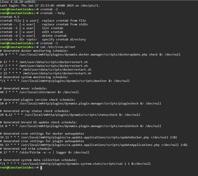

Snip
Still not fixed
Then you've added multiple .cron files (maybe in other directories) that are still the old version
🤦‍♂️i made other cron file name docker rather than dockerrestart
I updated cron and they are gone. hopefully, its fixed now.
