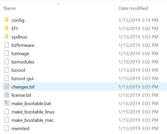

1 hour ago, Squid said:
pull the flash drive and upload the file from another computer (its in the logs folder)
OK, i've tried this twice and it's not generating the log files or if it is it's not putting them on the flash drive. This is what the flash drive looks like when I pull it:
That suggests that the flash drive is not being mounted correctly during the boot process.

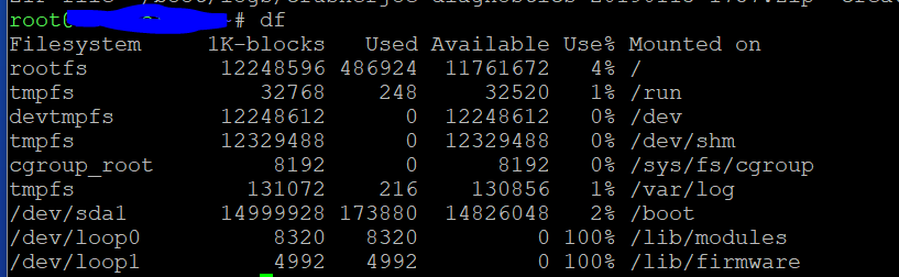

if you can log in at the console then try using the ‘df’ command.   This should list the mounted devices.    If the flash drive has been correctly mounted you will have /boot listed as one of the mounted devices.   If it is not showing up then we then need to try and work out what is stopping the flash drive from being mounted correctly during the boot process
This is what my that shows:
Well that shows that the flash drive IS being mounted.   Unfortunately that means that there is some other problem.
