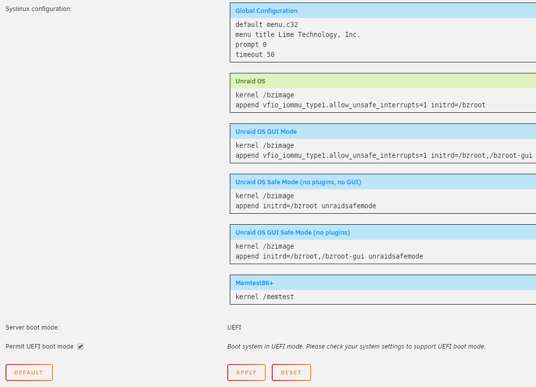

Have you tried legacy boot mode for unRAID?
Is that a setting or do I have to reboot unraid and choose it during startup?
Click on Flash on the main menu and you will see the setting at the bottom
Which option, the UEFI boot mode?
yea uncheck it and reboot then try again. Also i would add "kvm.ignore_msrs=1" to the syslinux config.

Must be something with the amd cards. I have two nvidia cards and both passthru without issues. I asked about the uefi mode because i have had issues passing thru my cards in that mode. Have you tried using a vbios file with the cards?

A couple of things, I don't have AMD or Threadripper myself, but some things to keep in mind, GPU passthrough usually requires UEFI boot process...  That means for the host you should not enable "Legacy Boot", since turning that on disables UEFI boot (for extra measure I even disable the "Compatibility Support Module" in my motherboard bios that even enables it to legacy boot since it just causes problems usually)...  For the VM, you should use OVMF, not SeaBios to enable UEFI in the VM...  And use the Q35 machine type since i440fx has to emulate the older PCI to be able to passthrough PCIe...
Try those, and if that doesn't work, then we will need more details, like the Diagnostics files from the system, and the VM XML file...
Edit:
Also, unless you have a specific reason to have it enabled (and there may be one for AMD motherboards, don't know), you should disable the "allow_unsafe_interrupts" option you added to your boot config
