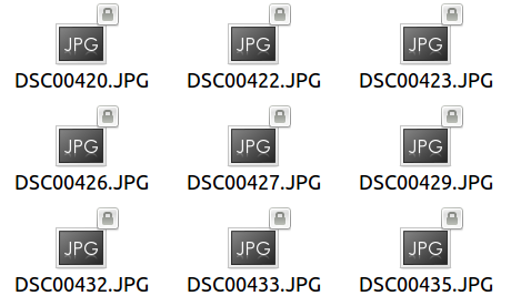

When using my desktop OS to view the unRaid shares some files show up with a lock on the icon.
I am 95% sure some files are missing.
What OS is the desktop? Can you give us a screenshot? Can you copy one of the locked files to your desktop?
The OS Ubuntu  16.04.5 LTS (Xenial Xerus) 64-bit.    Screenshot attached.
Yes, I can copy a "file with a lock icon" to my local machine and view it.

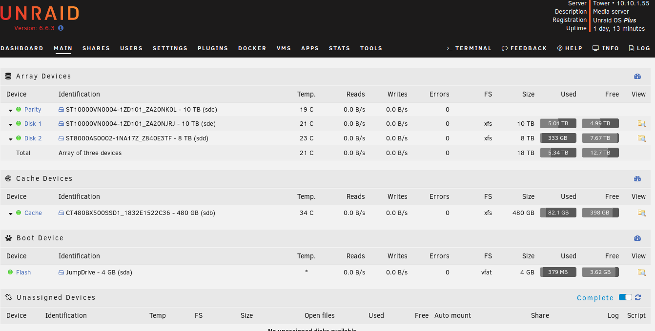

Just to make sure everybody is on the same page, can you please take a screenshot of the Main GUI page with the array started and post it here?
Sure, no problem.
unRaid 2019-01-21 11:40:25.png
I was going to comment on that screenshot, but instead let me ask for a different version of that screenshot.
That screenshot is showing us the speed in the Reads and Writes column. It would be more relevant to know whether or not you (or anything else) have written to the array at all since putting the disk back.
Just above the "View" label in the column with the folder icons is another icon. Click on it and it will show us the total number of reads and writes instead of the speed as you have it now. Give us that screenshot.

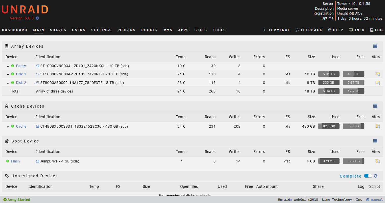

Hi,  I have been keeping the array stopped as much as possible.   I have copied data off the array but I don't think I added anything major (I can't think of anything I added....  but never say never).  I would assume there have been some writes.  The array was stopped.  I started the array to provide the screenshot requested by Jonathanm.  I then stopped the array.   I started the array to obtain another screenshot for Trurl.
unRaid 2019-01-21 14:59:19.png
OK that doesn't look too bad as far as writes. Of course, those numbers are reset on reboot so I don't know if those are all that has happened in the array since the disk was modified (repaired) in another system.
