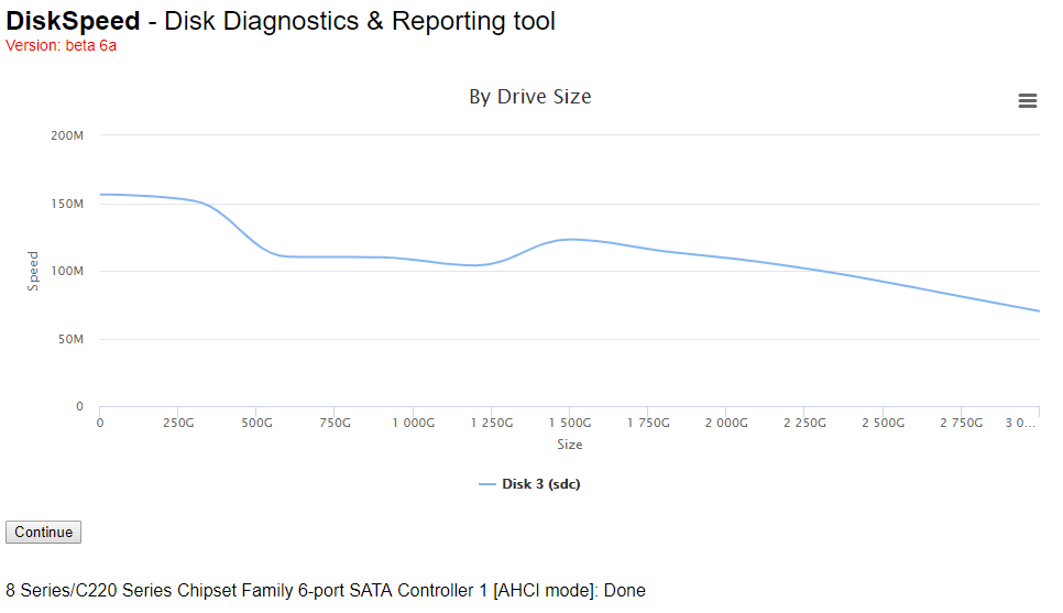

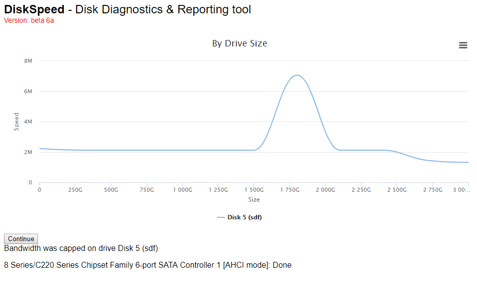

Alright. I did a test on disk5 and a test on disk3 (same brand/model, same sata controller)
Disk 5
Disk 3
So disk5 seems to be doomed right? Even if SMART doesn't report so. Should I try and do anything with that drive or replace it and recycle it?
Regards
Yes, you should replace it.
