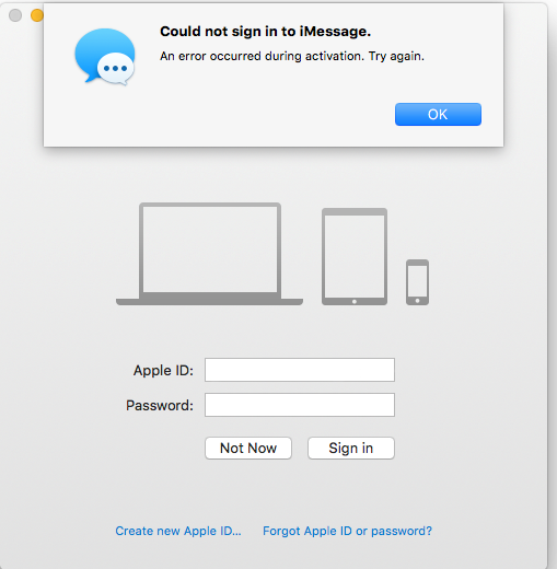

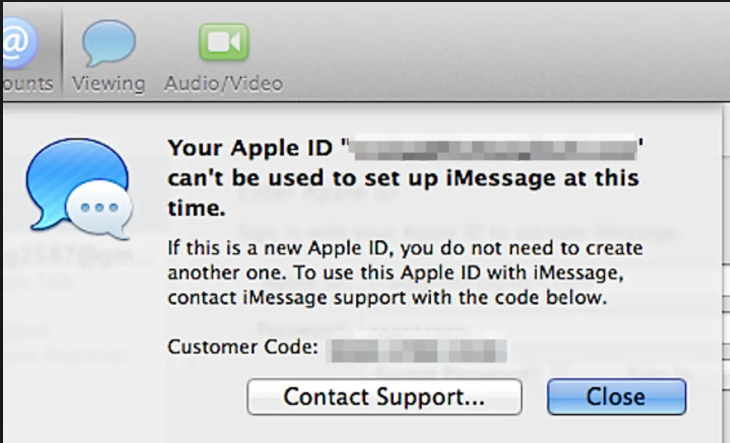

Finally, iMessage. I was able to sign into iCloud using a created Apple ID. But when I went to sign into iMessage and send a test message, I got stuck. Here are the two error messages I recall seeing, I scoured these from internets
447854009_contactsupportwiththiscode.png.6c523157e24ce0da8782a202c2d1666f.png1294256935_ScreenShot2016-03-07at5_51.33PMcopy.png.e83f032005464fdf0238833076ff6c58.png

So, if iCloud is working, and you're still getting these pop-ups, try actually doing what they tell you and calling Apple. I got that from this reddit. Another good guide to fixing imessage also here at tonymax86

So what did you say to Apple? I have Mojave installed, with icloud working, but imessage and FaceTime are no joy. Both are showing "an error occurred during activation" like above. Certainly you can't say, "I'm trying to boot this in an image, I have built a hackintosh, but this thing won't authenticate with imessage server".  Many thanks for your post.

I ended up calling Apple again. I Googled a picture of the iMac I was supposed to be working on, and just played dumb. The guy had me do a couple things, including creating a new apple ID with yet another email address I had floating around. But what sinched it up, was when he got his manager on the phone. She was also very nice, put my little customer ID code that iMessage generated into some field on her end, badabing, up and running.
