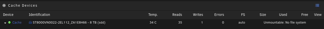

I want to make it my cache disk, but it's telling me, "Unmountable:  No file system".

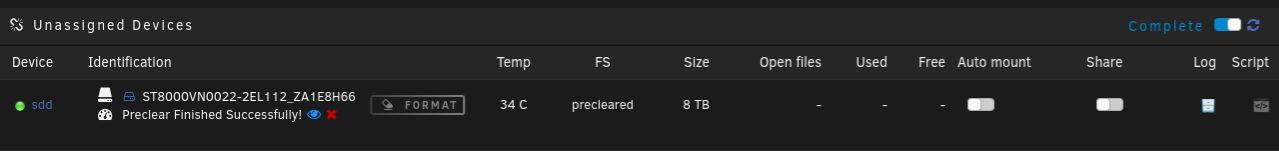

1404109610_Screenshot2019-01-16at6_46_31AM.thumb.png.c4df5b89c2fb73653eb6393b3c21411f.png
...so I think to myself, "cool.  I just need to format it" but the "format" button is greyed out.
What am I missing here...???
That's weird, try rebooting, if still the same post diags, maybe something visible there.
That did the trick.  Thanks!

On 1/16/2019 at 6:14 PM, trurl said:
That screenshot is showing the Format button for an Unassigned Device. Totally different thing than formatting a drive assigned to a cache slot. Not what you needed to do but to format an Unassigned Device you must enable "destructive mode" in Settings for Unassigned Devices.
What you needed to do was get Unraid to format the disk AFTER you assign it to a cache slot. The checkbox to enable format in that case is in Main - Array Operations.

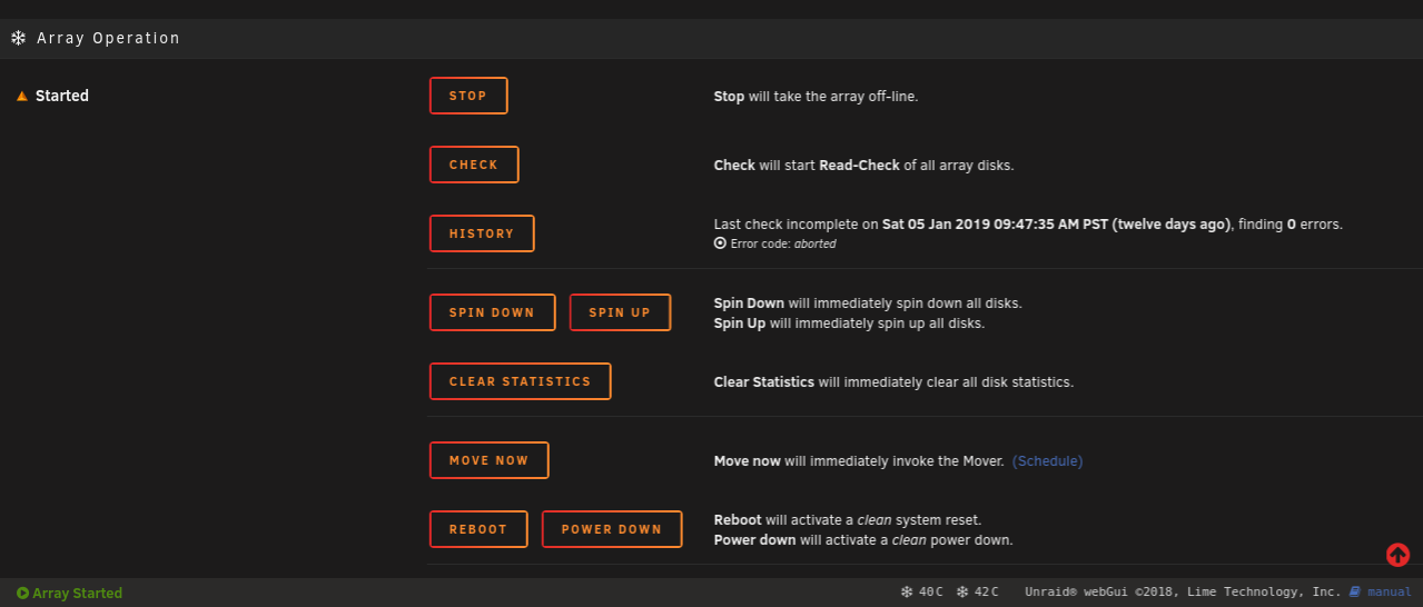

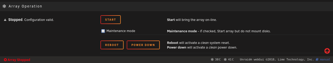

Array stopped:
369977189_Screenshot2019-01-17at8_51_57PM.thumb.png.1b7d0212477b6e78613c3fbaeec6bebd.png
Array running:
1407285705_Screenshot2019-01-17at8_53_16PM.thumb.png.2edceb4ae1f47d6d89fd7ccbeec88047.png
Am I missing something?
Do I have to start in maintenance mode?
17 minutes ago, rmp5s said:
Not seeing a format checkbox, though.
Post a screen shot of the Array Devices and Cache section of the Main tab

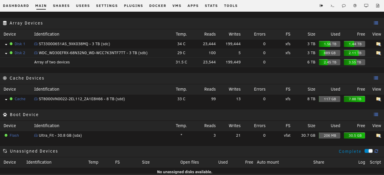

604656686_Screenshot2019-01-18at7_14_24AM.thumb.png.94e27a11e69c9cefd6dc43e80c18c94c.png
9 hours ago, trurl said:
Parity and cache have nothing to do with each other. The whole point of cache is it is not part of the parity array.
Also, 8TB is an unusually large disk to assign as cache. Do you perhaps really intend to assign that disk as parity?
Oh...I thought the two were the same.  Just looking for some fault tolerance and I thought the parity drive had to be as big as your biggest array drive.  Mine (for now) will be 8TB.
No - they are completely different.    The parity is about protecting the array disks and you are correct in it needing to be at least as large as the largest data disk,
Cache disk is about providing higher performance storage for running apps/VMs and for the initial write of new files.  If you DO want a cache disk then it is typical (although not required) to use a SSD as this gives the highest performance.   A cache disk has no minimum or maximum size requirement - you determine what meets your basic usage pattern.   If the cache disk is a single drive then it has no redundancy (many are happy with this).   A cache can also be run as a 'pool' of multiple drives which gives redundancy if that is important for the files that you place on there.   However be aware if running a pool with more than one drive that this requires the cache to be formatted as BTRFS and that has proved more fragile and prone to corruption that XFS.
Not sure what you have put on the cache disk so far.    If you want to repurpose the current cache disk for use as a parity disk, then you make sure that the VM and docker services are stopped; set any shares that might be using the cache disk to Use Cache=Yes (if this sounds counter-intuitive turn on the GUI help to see what the actual affect of this setting is) and then run mover to get any files currently on the cache disk moved back to the array.    After doing that you can stop the array; unassign the cache disk; re-assign the drive as parity1; start the array to start building parity  (it will probably take most of a day with a 8TB drive.).   At this point you can re-enable the docker and/or VM services if you use them.  You could then later add a smaller drive as cache (assuming you want one).
And side note, the reason you weren't seeing the format checkbox is because the 8TB is already formatted
