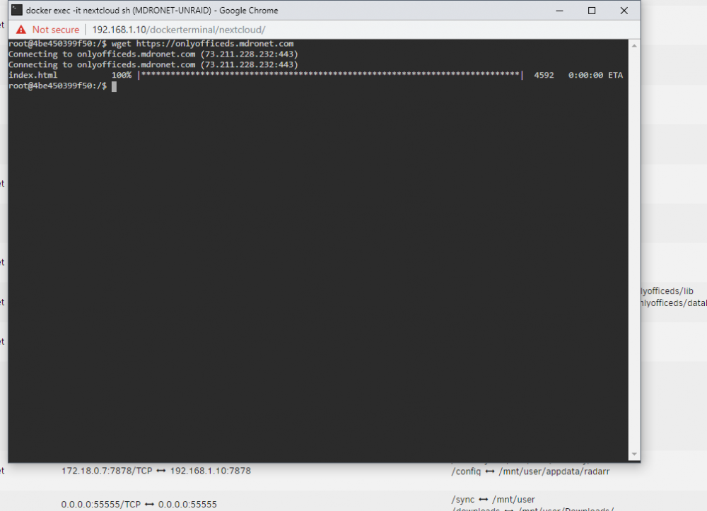

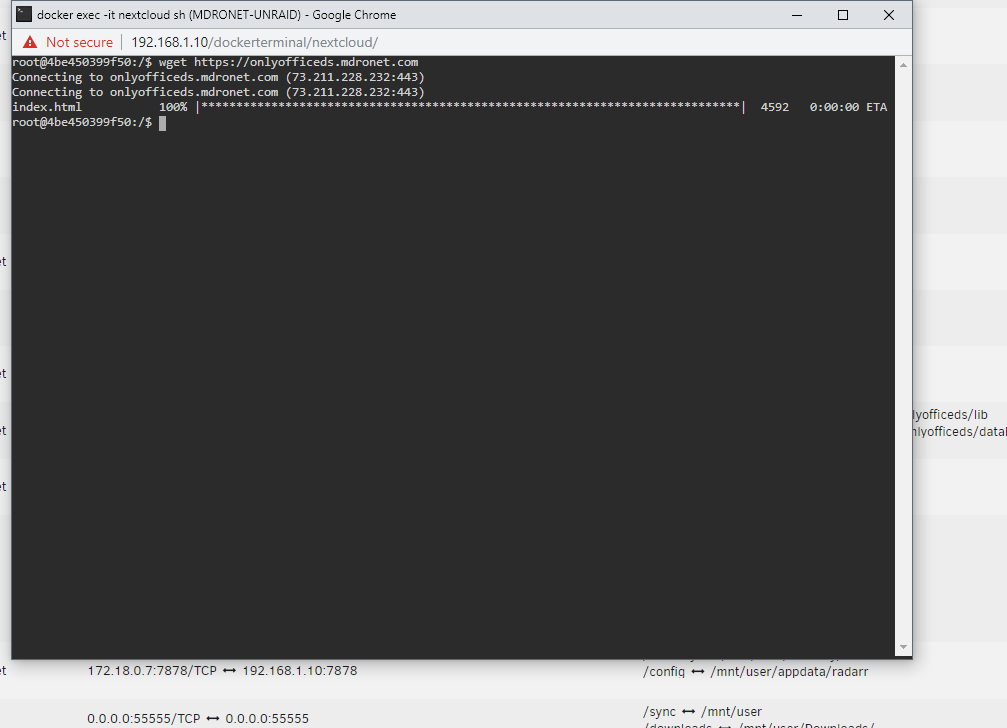

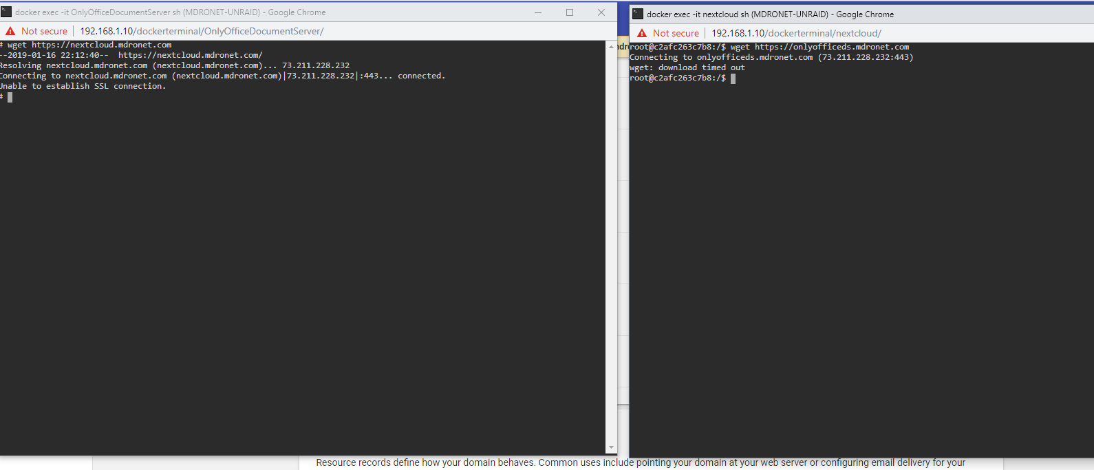

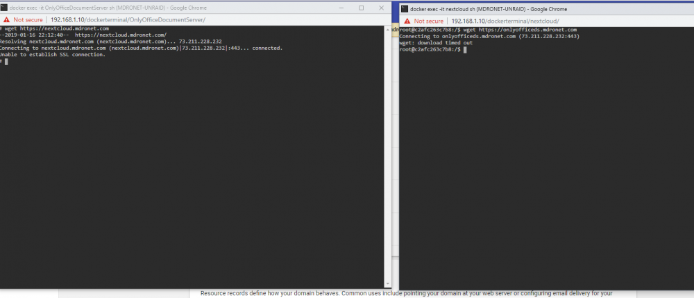

Running wget commands from nextcloud for example gets the below attachments.
Nextcloud to DS > just shows connecting, no resolve like it doesn't even see the port being available.
DS > nextcloud > resolves but then gets stuck on connecting and never goes any further.

Thanks for the reply. I am pretty familiar with the reverse proxy setup as I have it working with tons of other things. My friend has the exact same code setup and it's working and as a matter of fact i am routing it through orginzr so I know even on my end the code works. You can connect to the URLs just fine from the outside and inside the network as well. Its just went i try to connect these two services to each other they do not connect. wget is my way to test the connectivity and I should be getting a response with wget not a "loading" or "connecting" and then a timeout. I don't know why that is occurring! Even from other dockers to these ones they do the same.
if i eliminate the reverse proxy it's the same result. I took my firewall and mapped 443 direct to the document server and still have the same issue.
