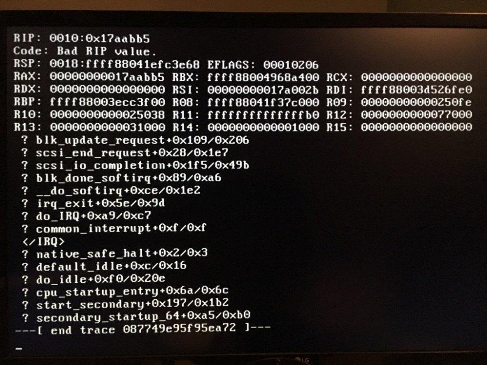

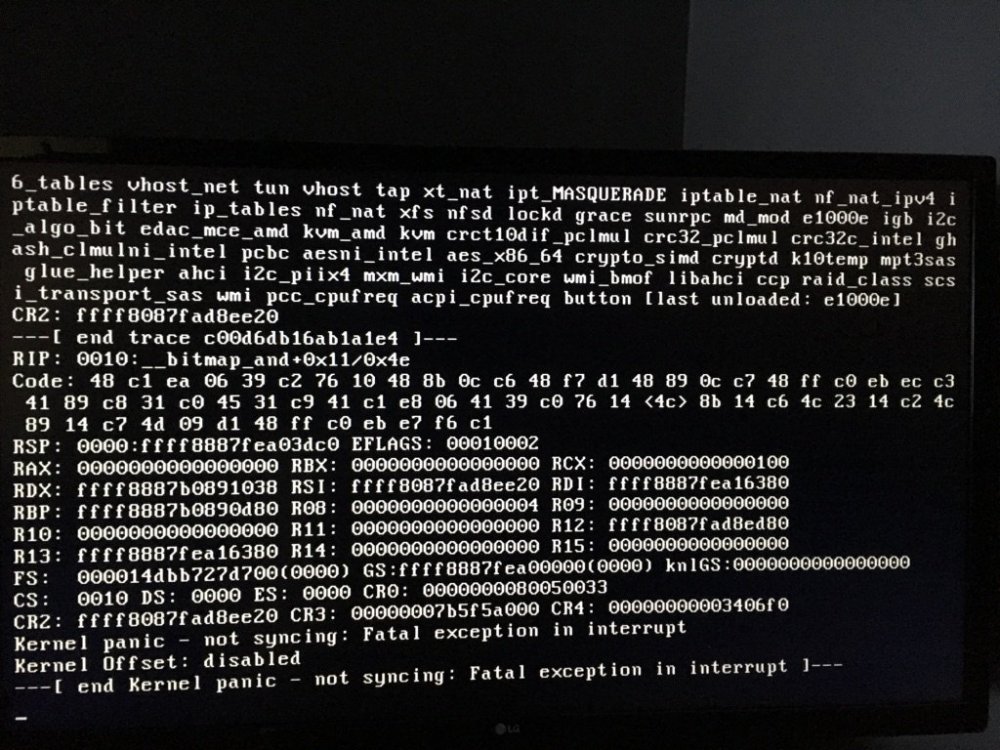

All, while testing out Unraid (haven't paid yet) as a potential replacement for my QNAP's I'm getting the below infrequently, but frequently enough that I won't be able to use this as a NAS / VM or whatever else I need to do if I don't fix it. I have disabled c states and am running latest BIOS 4207 with Agesa 1006.
I think it's a soft lockup as the keyboard lights were still on, but actually didn't 100% confirm.  I did get a hard lockup the other day, but that was before I disabled c states in the bios.
Can anybody help with any ideas / suggestions?  If it's a hardware fault, I 'should' be able to return it - I assume the AMD warranties are fairly decent in length.

It just happened again overnight - where I suspect it was near idle.  I've added the rcu_nocbs=0-15 because I read this was still required and rebooted and now it crashes before it even boots up.  So will have to remove that.  But the question remains, what's crashing the system and how do I fix it.  Any other options you can think of?
So I added the rcu_nocbs=0-15 parameter slightly wrong I think, which was causing the crash.  Fixed now.  Will see how that goes.

Updated to 6.7.0-rc2 and it has already crashed again.  That's probably going to make it easier to track down - I'm suspicious about disk io now.... this can't be specific to Ryzen or it would have always been happening.  I have added a Dell Perc H310 card though and probably now I'm actually beginning to write to those disks.  Hmmm

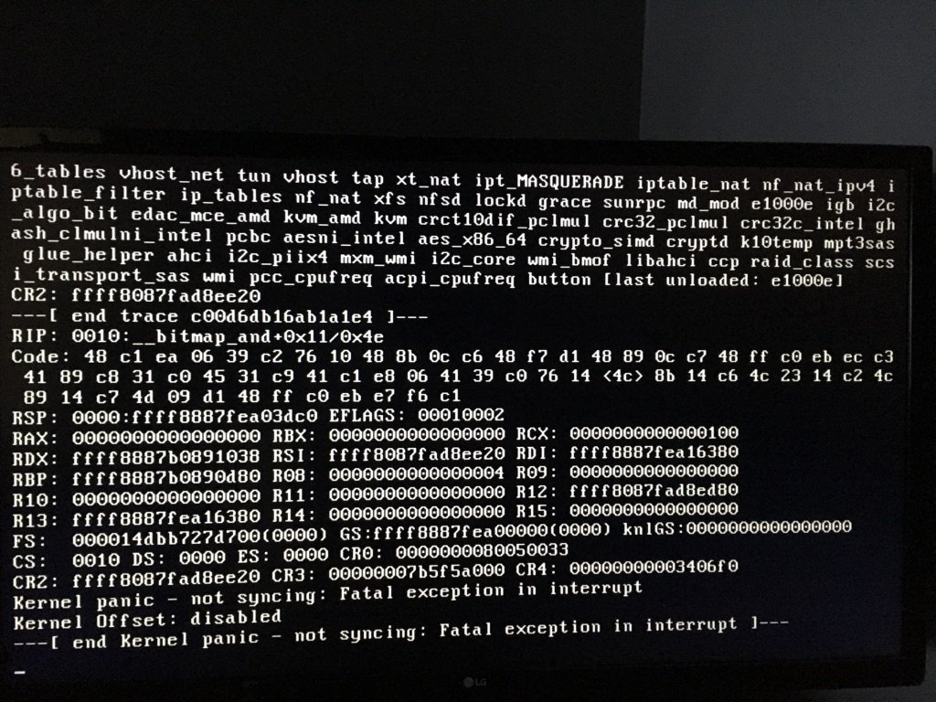

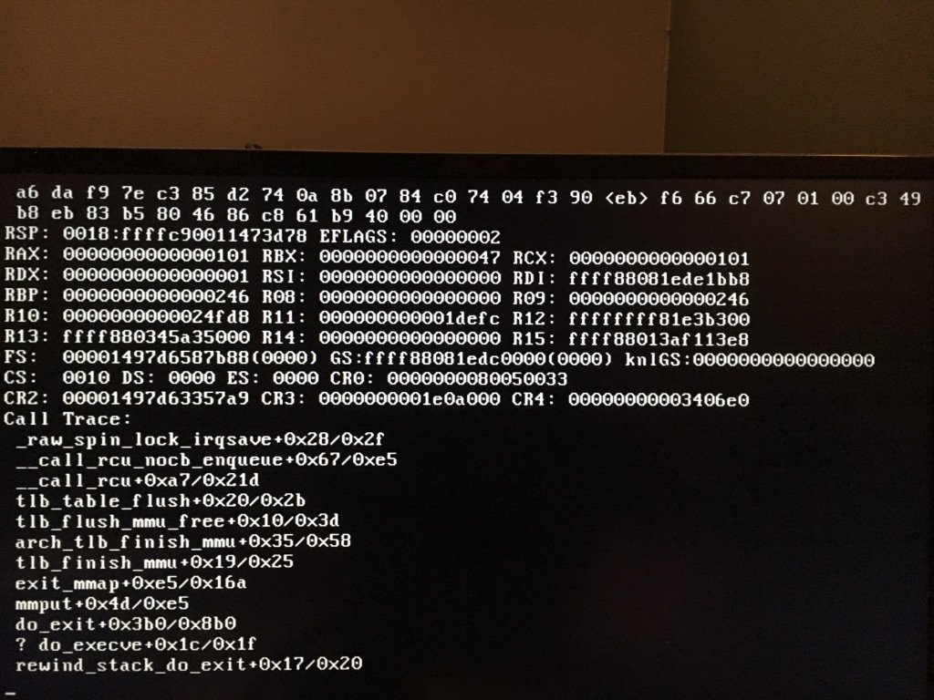

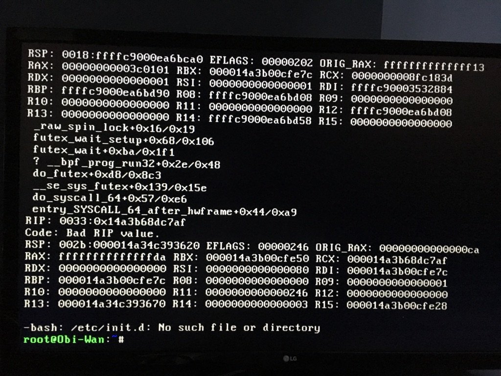

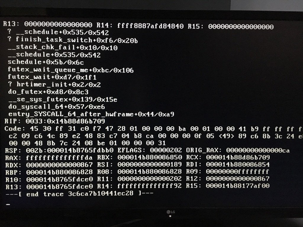

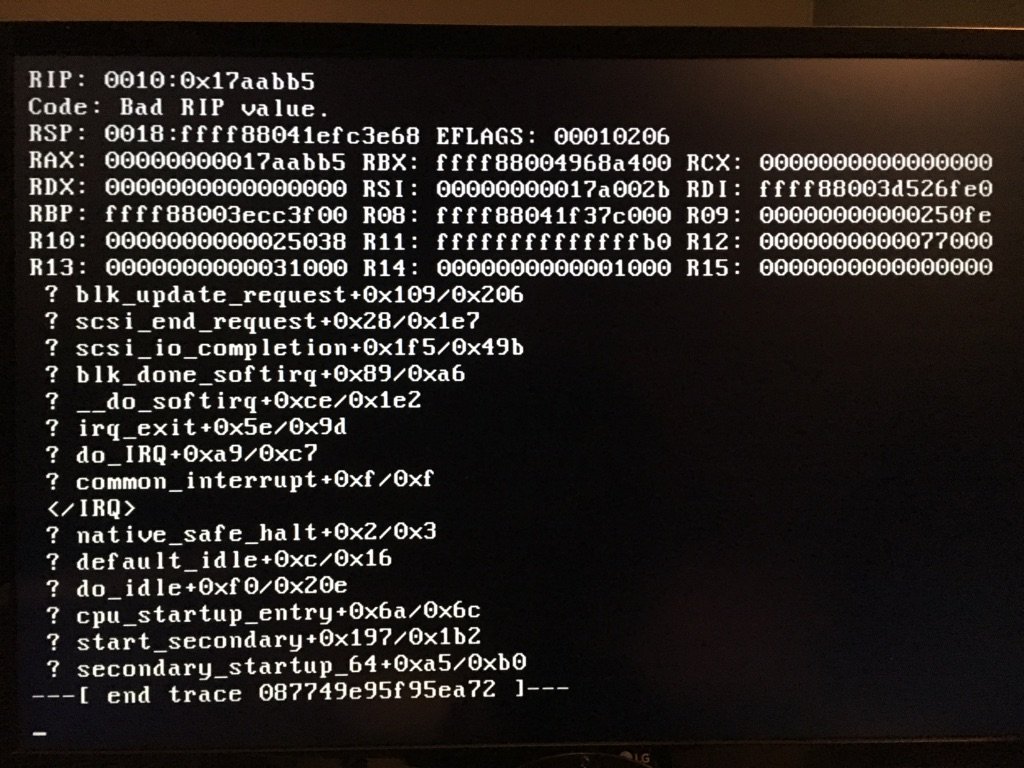

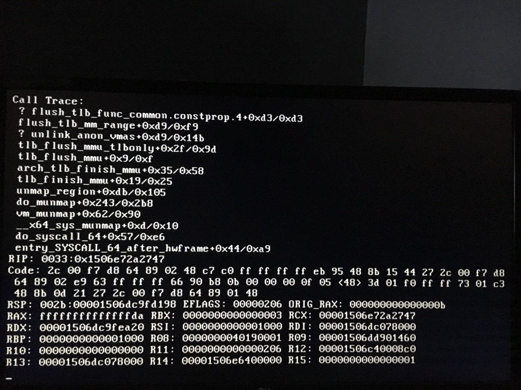

Sadly, two more.  It always happens when I'm doing high IO.  Maybe it's network.  Guess I'm going to have to properly figure out how to read kernel exceptions.
I also removed the 2nd NIC a few days ago.  However, I woke up this morning and it had crashed.  Maybe it's running on bitcoin lol.
I'm really struggling to get good logs on this one.  It lasted for a few days longer, however as I had seen before this seems to happen more quickly at times of high I/O which has not been happening lately.  Hmmm, I wonder if I have one of those Marvell controllers.
Seems the logs are wiped at every reboot.  Surely not, but that's what they're telling me.
