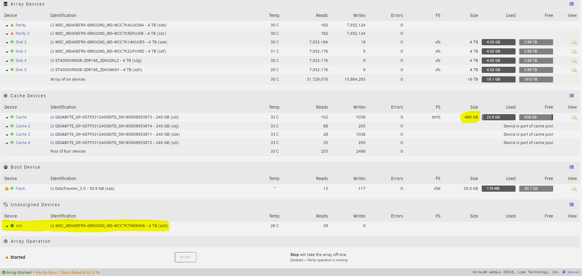

1. i cant use disk (sdd) in my array i have tried to unassign parity drives, save, add sdd disk but still wont initialize
2. why can i only see 480GB SSD cache when 4x240GB SSD Drive is selected to be cache?
see img.
In a cache pool, there is redundancy.  You see 480GB because 2x240GB is available to be used and 2x240GB is the backup in a RAID1 mirror.
How are you trying to use the 'sdd' disk"  As an array data drive?
Edited by Hoopster
You have to wait for parity sync to complete before you can make any additional changes to your disk assignments.
The default for cache pool is btrfs raid1, which mirrors all data in the pool. That is really probably a good idea and you already have plenty of capacity for most purposes in your cache pool with that configuration. Other configurations are possible though. See the FAQ pinned near the top of this same subforum.

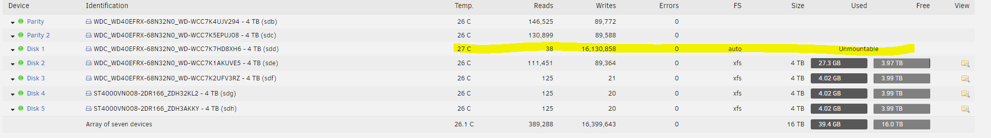

i got the last added but it cant be mounted
what can i do to mount it?
Format button, next to the array start/stop buttons.
