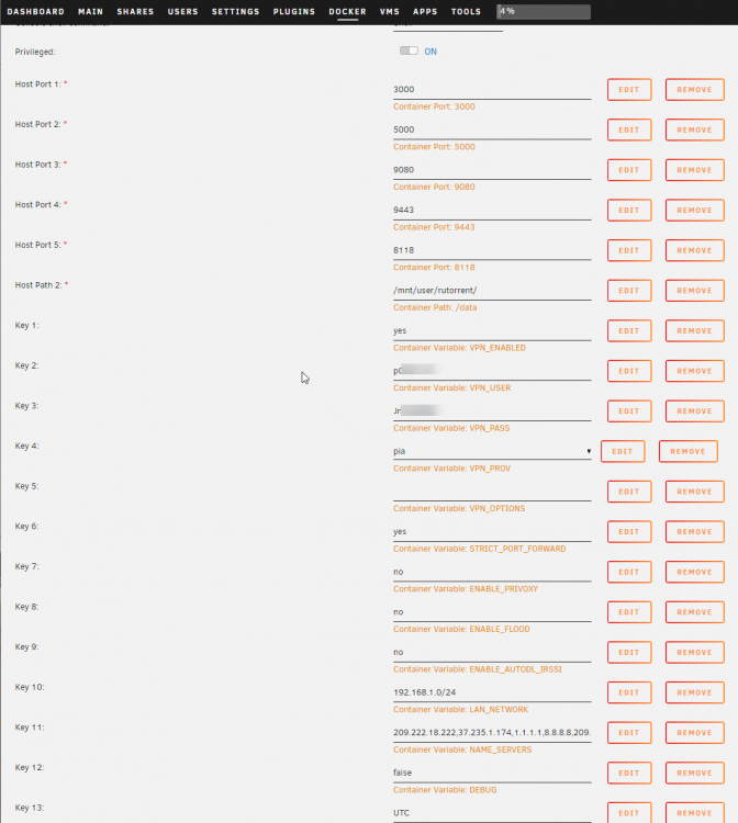

I've noticed when I reboot, my docker apps seem to lose any custom settings I've set inside the application. For example, the latest one I've noticed is "binhex/arch-rtorrentvpn" VPN and everything works great, but if I were to change some of the rutorrent settings inside the app such as ratio groups, max upload speed etc, I'll lose it later.

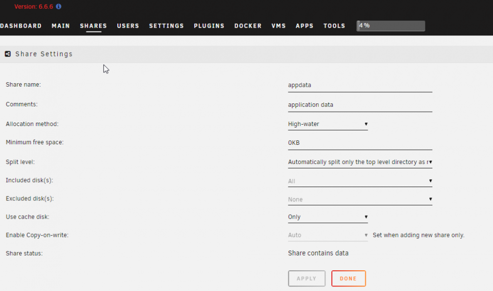

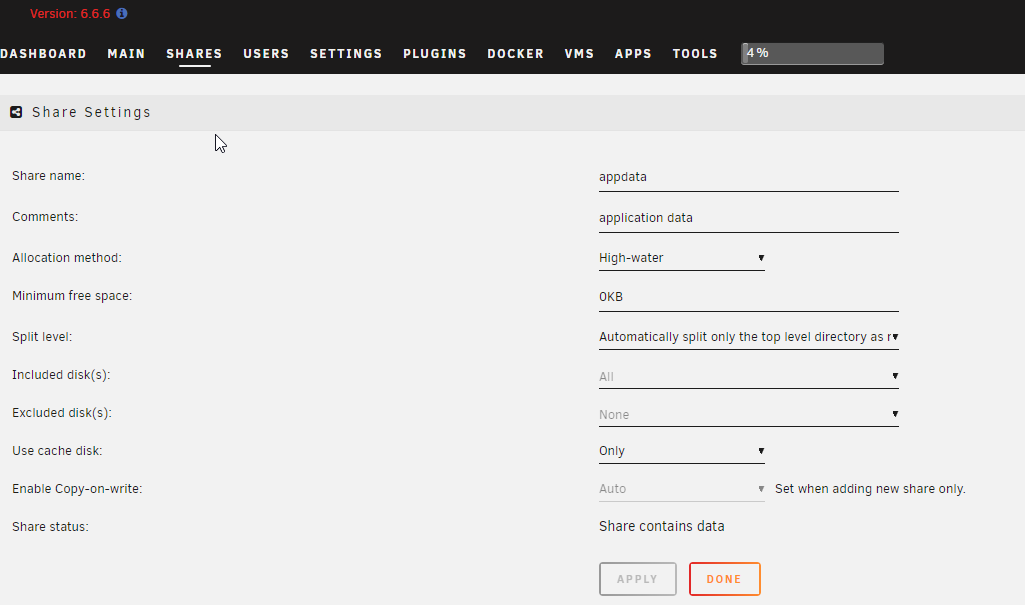

I believe I have it all set to run off cache for performance.  Here is my appdata share:

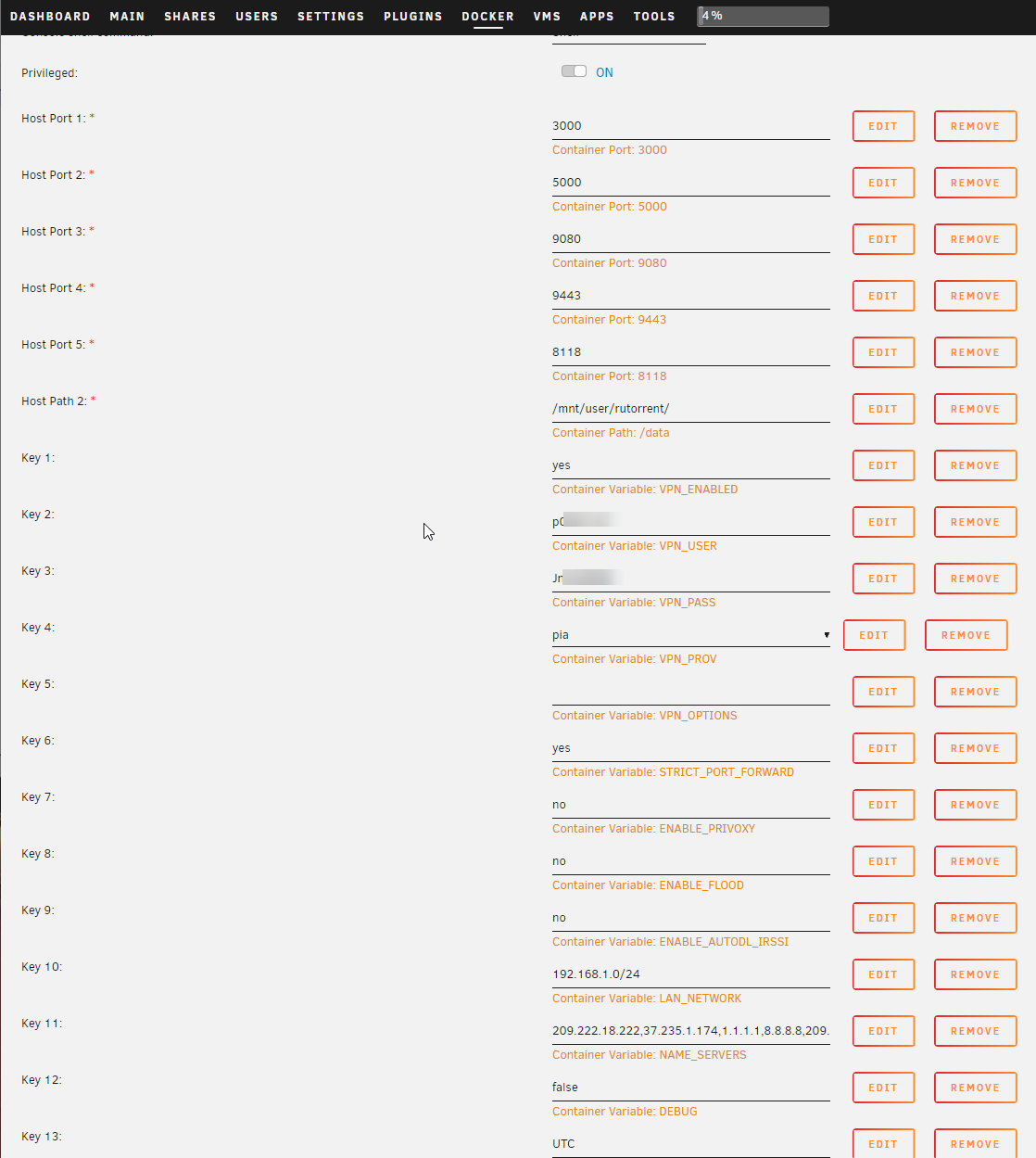

docker settings for rtorrentvpn

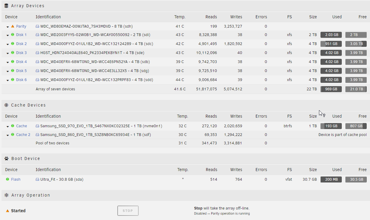

My array, parity is still building.
Attached is my syslog. Any ideas? I'm am new to unraid, only been running it for 2 days and still working on transferring everything over.

You did not show where your container config is mapped. You probably have set it wrong somehow.
Post your docker run command as explained in this very first link in the Docker FAQ:
Might be worthwhile for you to read other articles in the Docker FAQ.
Thanks, guys! It was mapped wrong. I had my apps setup before I set them to be on the cache drives.
Once I changed it from /mnt/disk2/.... to /mnt/cache/.... it works as it should
Appreciate it!
