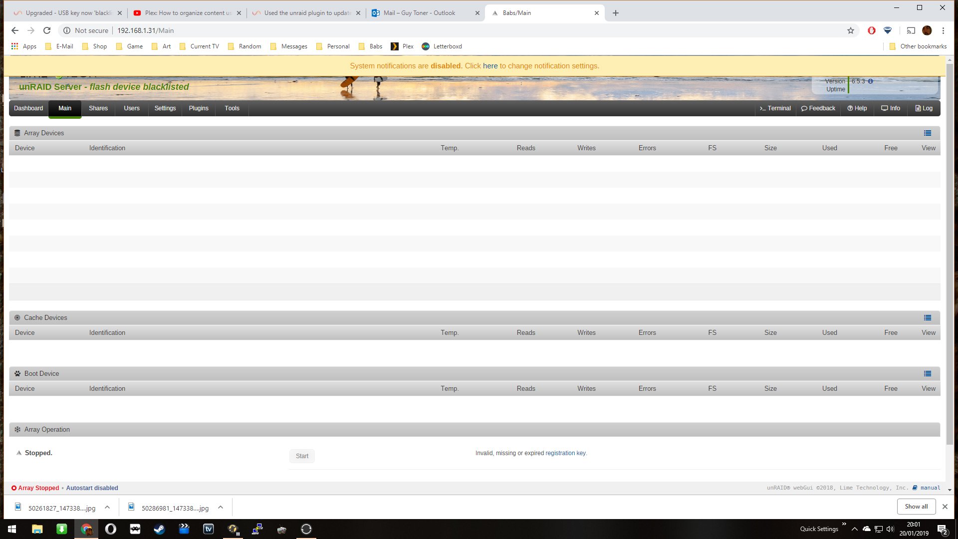

Hi all,
Fairly new to unraid and my knowledge is pretty limited (actually its pretty amazing I've gotten as far as I have!)
I've been using it for a while now, quite happily, however recently I've been trying to set up a VPN which has required me to update my Unraid server from 6.0.1 (been on this since i started) which i tried to do using the plugin screen. Everything seemed to go well until i rebooted where by it then told me my usb was blacklisted and i can't seem to do anything on it now (assuming because it's blacklisted) everything is accessible but for some reason when i click on something (like power down or reboot) it doesn't actually do anything even though it says it is doing something (rebooting or powering down etc)
I contacted customer support and they suggested i post here and also supply my diagnostics.zip. Unfortunately because of the issue above it won't actually allow me to download my diagnostics it just refreshes the page when i click download. I'm also concerned that if i have to put my key back in that it won't work for the same reason(s)?
Any ideas?

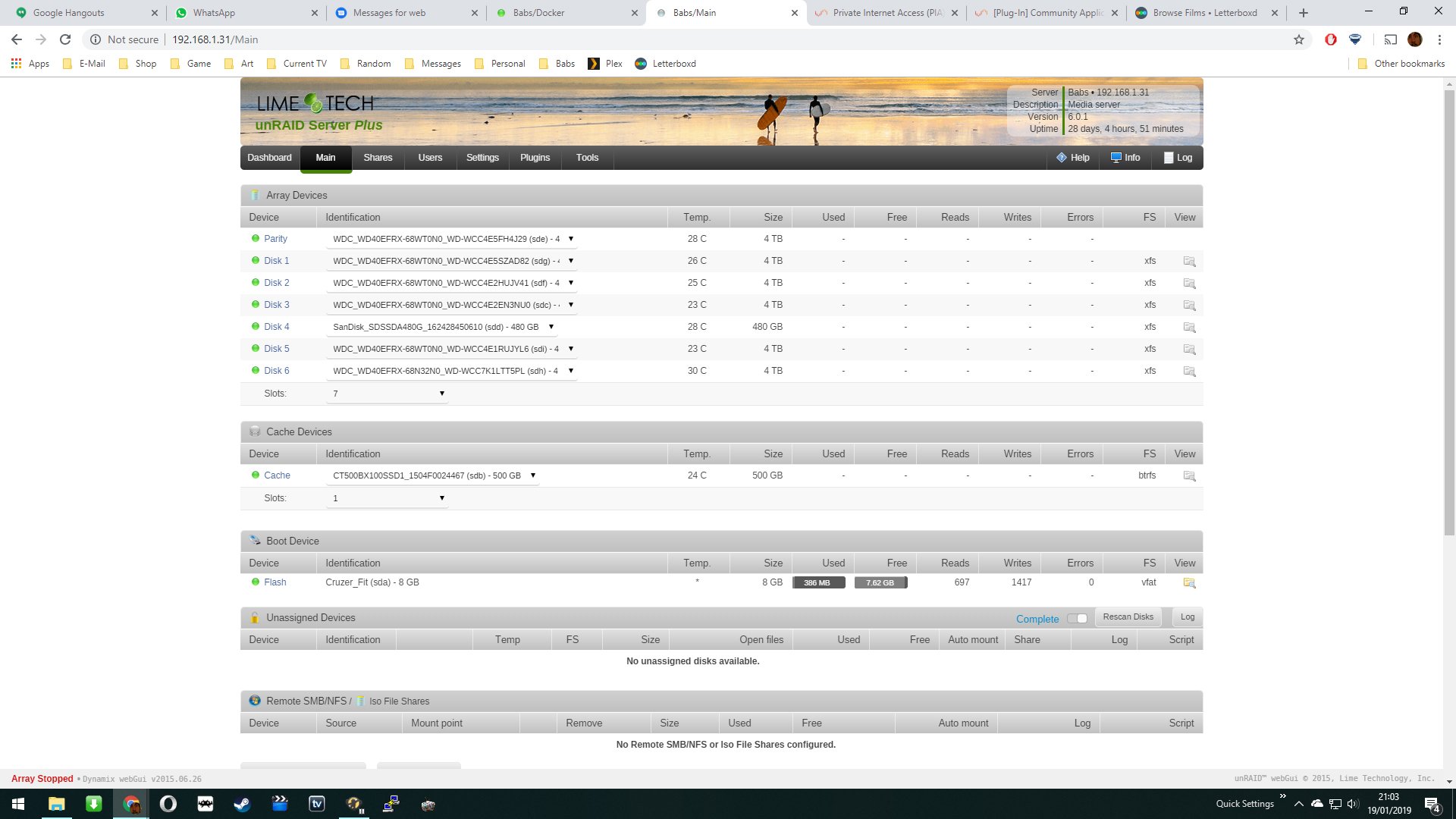

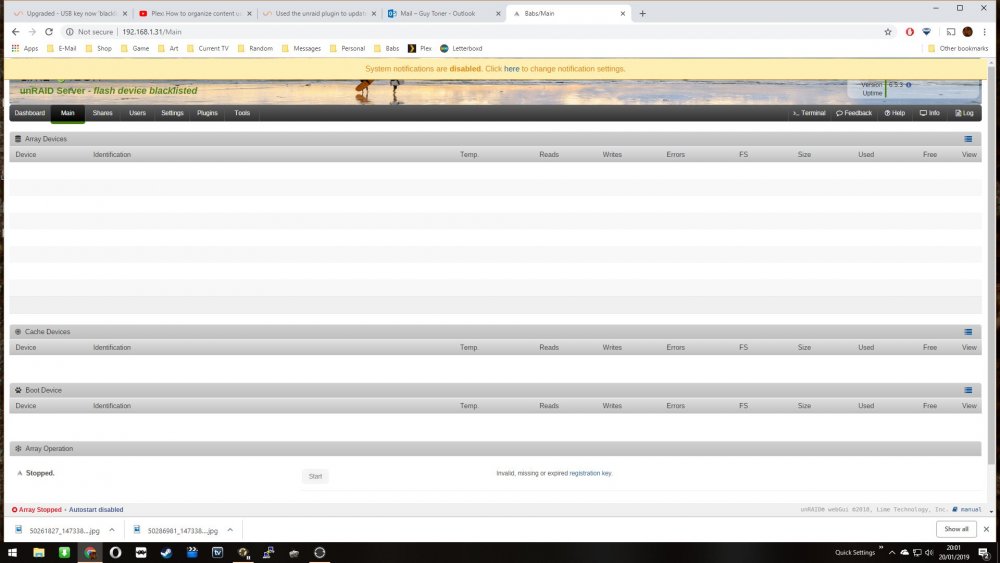

I can revert back to 6.0.1 using the previous version folder on my flash drive and this does then allow me access to everything again, but then i'm back to square one and I would very much like to update if possible.
included a couple of screenshots, one showing what it looks like on 6.0.1 and another on the latest version...as you can see the array has completely disappeared on the latest version, but again I'm not sure if this is because its "blacklisted"
Thanks in advance

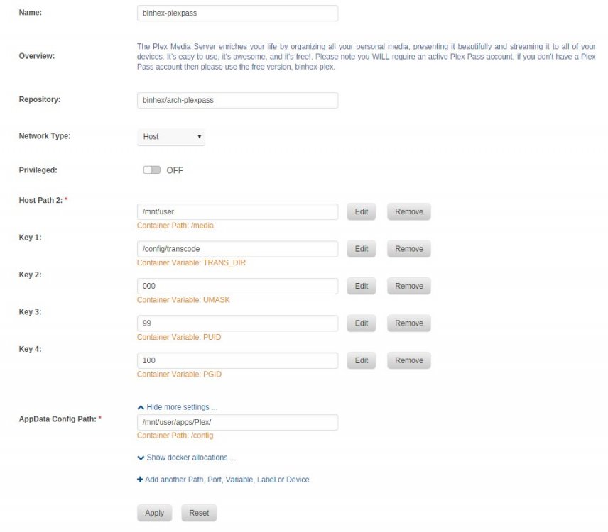

I have an "apps" folder which has a folder for "plex" inside which i assume is for the database and I also assume, as a plugin, it had access to the entirety of mnt/user, which is what the docker seems to default to (haven't installed it yet).
I'm thinking now i may of not totally understood shares when i set this up, I probably should of had a "media" folder with separate folders for TV and Movies inside. Unfortunately I have two shares; 1. "TV" and 2. "Movies" and i can't see a way of mapping both in the docker app other than to leave it as mnt/user.
If i can help it, I'd rather not have to move these shares.....theres a lot of content there and sorting it all out again in plex would be a bit of a nightmare, can i use the add path link at the bottom of this screen shot to map both "TV" and "Movies" shares?
Also not really sure what the key 1 - 4 items are and if they need to be changed....
Edited by zapp8rannigan
1 minute ago, zapp8rannigan said:
Not anymore, the plugins gone unfortunately. Could try reverting back and having a look, don't recall there being much in terms of setup on the plex plugin.
Make a copy of that apps folder. That would become the appdata share, which typically lives on cache for performance. Your TV and Movies shares are fine and the way a lot of people have it. If we can get the docker to use your plex database then you don't want to change any of that anyway since it will be a lot simpler if plex sees your media where it expects it to be.

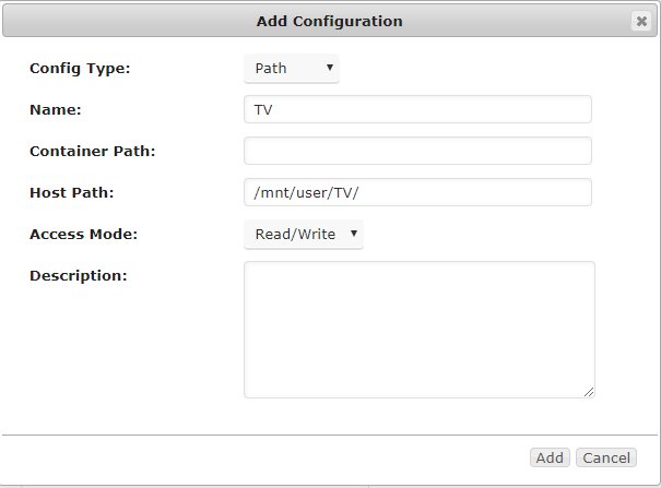

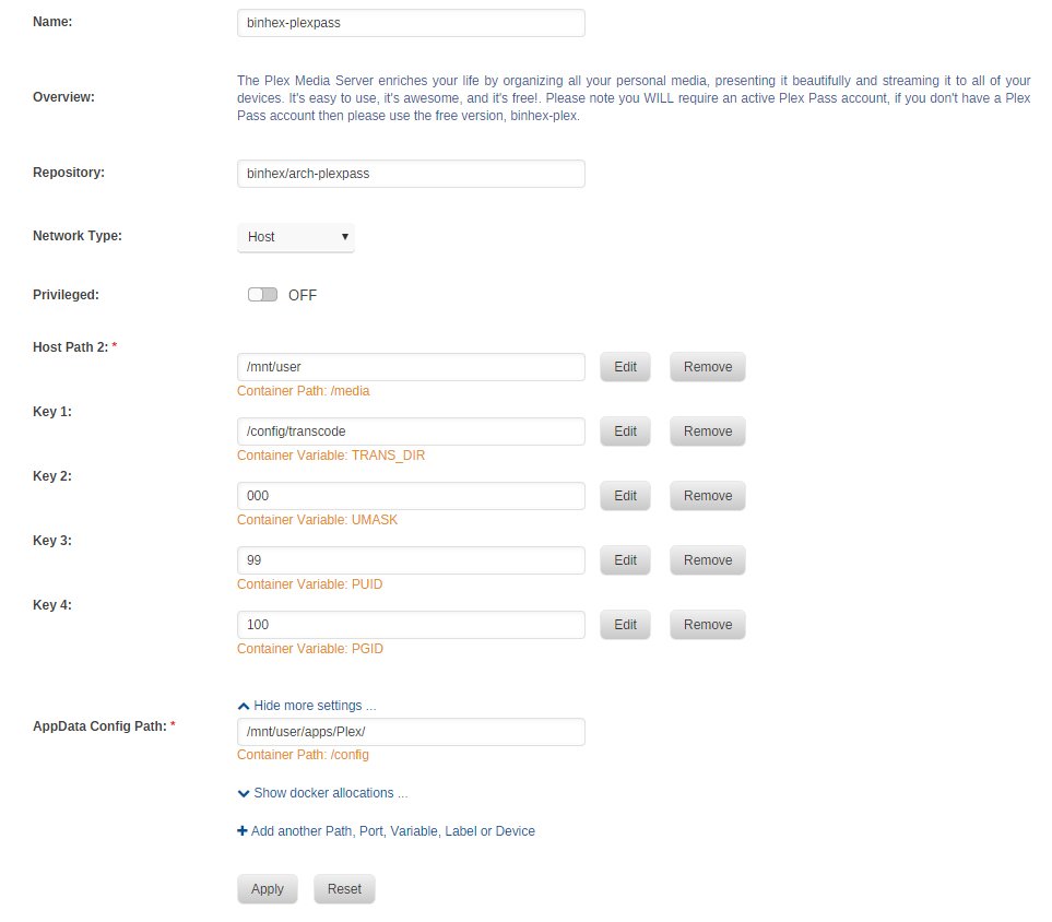

I don't know why but i have an "appdata" share and I also have an "apps" share (possibly a default option on a previous docker setup that i just ran with). The appdata share doesn't look like anything is actually inside it.
for the "host path 2" should i just change that to either my movies or tv folder? and then add the other one with the "Add another Path, Port, Variable, Label or Device" option at the bottom? That gives me this screen, but I'm not totally sure I've got it filled out correctly. Container path? Description?
Really sorry, although its become apparent I've been using Unraid, I'm very much still a noob
forgot the pic!
I suggest copying that /mnt/user/apps/plex folder into /mnt/user/appdata, to make the folder /mnt/user/appdata/plex. Leave the original in place as a backup for now.
Then /mnt/user/appdata/plex will be the appdata config path for the container. This is more in conformance with the way other dockers are used and consistency will be to your benefit going forward.
Host path 2 as it is in the screenshot is going to make your /mnt/user appear as /media inside the plex container, but the database you already have is expecting your media to be at /mnt/user. So you need to edit that mapping and change the container path to /mnt/user.
Let me know if this isn't making sense or you want to get further into the explanation. Or we could just try it this way and see what happens and explain it later.
