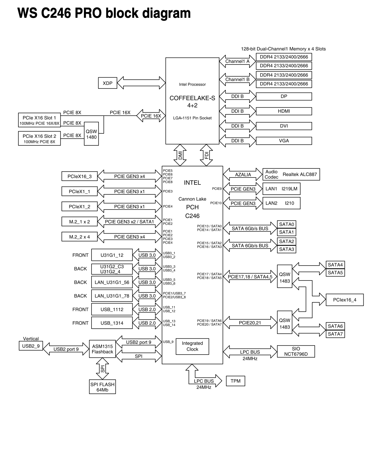

One thing, again, to be careful of.  Just because there are "slots" doesn't mean you can use them.  The CPU only has 16 lanes, so if you tried to use 8x off of the chipset your ability to use them will be completely constrained.  For example, even in the Asus there is only the following configurations avaliable:
Lets take a look at the following diagram.  What this shows is that on the Asus board, you have a single 16x OR dual 8x from the CPU.  All other PCI-E is routed via the chipset and has trade offs.  Firstly, there are NO slots that will function at 8x from the chipset....even if they are physically 8x slots on the MB.  Secondly, you have decisions to make...You get 1 4x and 2 1x slots all the time, but to use the other 4x slot will disable 4 SATA ports.  If you use an SATA M.2 you lose another one.
So there does not seem to be a way to get 3 functional PCI-E 8x slots in a C246 board, the limitation is the processor which only has 16 lanes (this is the same as the i7-8700).  To get more PCI-E lanes you would have to go with a Xeon or TR and then you can do anything you want, but you lose the iGPU.
