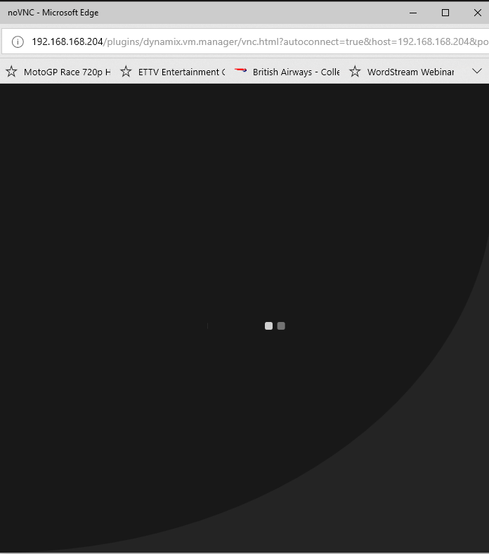

cant get any VMs to start
I'm trying to use pre-made .VMDK files to run VMs in Unraid 6.6.6  using the VM templates
I've tried win10 and win7 so far and both exhibit the same isse - I also tried an empty VM, assuming it would go so far as to say "no hdd" - but it does exactly the same. when I open VNC is just get the screen as attached (stays like that no matter how long I wait)
Stopping the VM does not stop it, I have to force-stop it. There's nothing meaningful (to me) in the VM log files  (attached) - I've also attached my diag file.
This is an HP Gen 8 Microserver with 10GB ram and an upgraded CPU (from Celeron to Xeon E3-1230 V2 @ 3.30GHz)
any suggestions or pointers would be appreciated.
I've started by converting a win10 image to RAW with qemu-img as per Jon Panozzo's instructions here (around the 2 minute mark) - but that didn't work and exhibited the same symptoms - then I read that 6.6.6 should support VMDK file so I've tried with VMDKs since.
Thanks

I've been assigning two as per Jon's video. I'll try one and report back. Thanks.
oops - a touch embarrassing that I didn't even think of it, but I've been doing all this from Edge - tried it in chrome and VNC works. Having blue screens, but at least I can now see the VMs running and try different settings.
