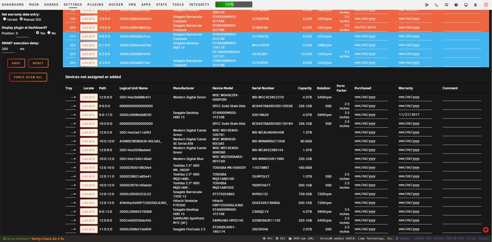

Sorry for the delay.. I have been really busy working (trying to make enough money to upgrade my dinosaur lol.) But that didn't work..  I even uninstalled and reinstalled the plug in.
As far as what you said, that makes since. But four of the drives have not been in my system in over 4 months, maybe longer. It's not that big of a deal, it's only showing in the configurations tab anyway. I'll just have to scan through all of them (40 so far. Alot more to come) to find when I add a drive to the pool.
Anyway, Thanks you again for the great plug in...
Also, to clarify, I put the drive in my hotswap tray and do the preclear then remove the drive from the system and put it in a static bag, label it and put it in a metal closet for future use or sell.  I do that with new drives (stress test before selling it to some one) and old drives (before installing os in used computers or reinstall on customers hard drive from their computer, just to make sure it doesn't die so they can't blame me ;^)  ). I kinda wish preclear was on linux for me to install on my test bench pc so I wouldn't have to use unraid all the time. But i wanted to make sure I explained what I was doing.
Hot-swapping might be the issue here, I have also "hot-swappable" trays and motherboard/controllers supposedly supporting it. But in the end, it does -work- but the data is often recognized as the first disk which was installed in that specific port. A reboot might solve the issue, then do a force scan all. My two cents though.
