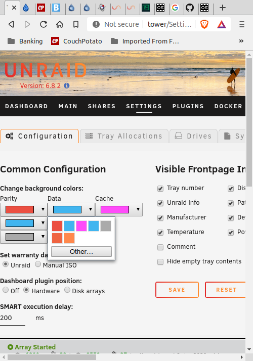

Something odd has happened to my colour picker and I'm not sure what/why or how to resolve it.
You have the same colour for unassigned and data drives. The colour picker always list the chosen colours first and in this row from the left: parity, data, cache, unassigned, empty. The extra two added ones are the default colours for data and cache (which is replaced by your custom colour). The behavior is expected :)
