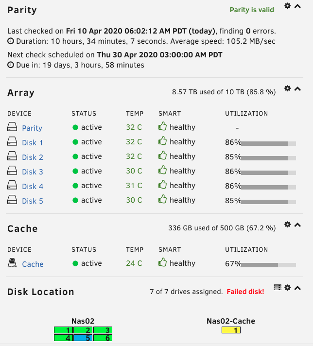

10 hours ago, olehj said:
I might add an adjustable factor in the future, I'll list it on github meanwhile.
Sounds great, thank you for the consideration! :)

Update 2020.03.04
  • Commit #139 - FEATURE: Added the ability to turn off scanning of device during a plugin update. If it's disabled it will rely on manual updates (Force Scan All) and S.M.A.R.T update schedules. (This will make updates and reboots faster though)
  • Commit #138 - FEATURE: Added possibility to adjust the size of the preview/dashboard layout.
@CorneliousJD something for you 😛

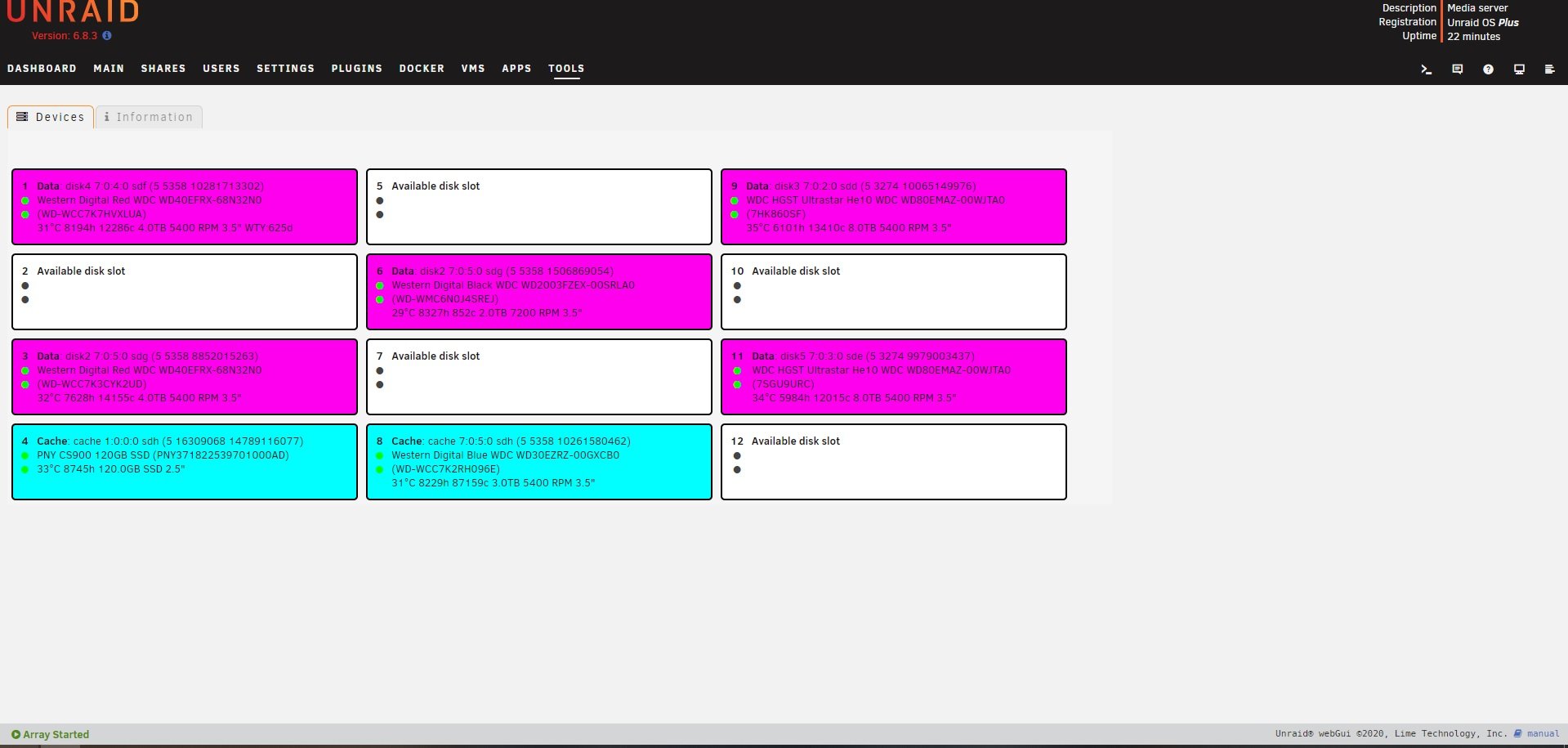

1 hour ago, jchase222 said:
Ive been trying to figure out this problem on my own for some time but and tired of messing around. I looked at the screenshots that you have on page on and I am missing the configure button and do not know how to re-add it. Ive tried removing the app and re-installing it but that hasnt seemed to work. Also it seems to be stuck with data from old drives that i had installed previously. For example in the screenshoot the 2TB HDD is no longer in my system but it says that it is active. So I need some help. Thanks
Hi
The screenshots are outdated, and the information was given in the forum at some point. Though I will update the first post later.
The plugin is divided into two sections:
Tools -> Disk Location: This is the visible and configured section of your system
Settings -> Disk Location: This is where you configure your system. "Force Scan All" button under "Tray Allocations" will help solve most of the problems.

I'm getting a "Failed disk!" message on the dashboard in this plugin section.  I'm 100% sure there are no failed disks on my system.  I've tried deleting the database on reconfiguring from scratch, but it's still there.
Any clue why it's showing this?
TY!
TY!
Check if any of the drives have a "FAIL" SMART status. The "Information" tab should point it to the related drive as well.
After doing some more research on this, I see that unraid is having problems with SMART tests against my SAS drives.  When I do a self-test from the cli, I see "Error Counter logging not supported.   Device does not support Self Test logging."   And then I also remembered that these are running on an H800 in individual RAID-0 until my new HBA arrives.  So another reason SMART isn't working.

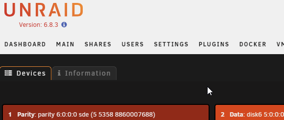

Hello Ole-Henrik
Due to a dying disk I thought is was a good idea to edit the current disks and  - I cant. The edit-tab is missing
According to the Plugins-tab the plug-in is up-to-date (2020.03.18). My unRaid is @ version 6.8.3
Any idea how to fix this - got no idea if the plug-in produces any logfiles.

16 hours ago, sjoerd said:
Hello Ole-Henrik
This plug-in is still a very desirable and must-have plug-in. Thanks again!
Did you go under "Settings" and go on "Disk Location" from there? These tabs exists under "Tools" only
