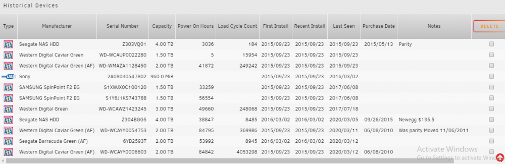

On 4/28/2020 at 4:21 PM, jbuszkie said:
I'm moving over from the server layout plugin.  First of all thanks for this plugin!
Second..  Is there a way to manually add a disk to the database?  I really like the other plugin's "Historical Drives" section.
It kinda give me a history of what was installed and when it was removed.
Yes, it can be done manually, save your data and I provide you with some SQL insertions later when I bother :P It is manual, and eventually have to be done everytime if you delete the database. So keep a backup after you added them all. I provide the details later, but as I said earlier in the last post.. Im busy doing nothing and playing left 4 dead 2 at the moment 😛

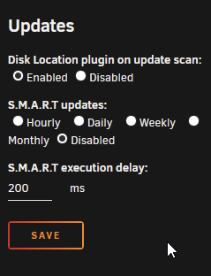

When I want to set s.m.a.r.t updates to daily (or any of the options listed) it falls back to disabled on save. Any thoughts on how to fix that?
28 minutes ago, sjoerd said:
Awesome..
I noticed there are some new features since my last active use. Great
Most likely it bugged out and created two or more cronjob files for the same task, I did experience this myself, but not sure why yet.
What you can try:
  • Press "SAVE" while it is chosen as "Disabled" before you choose anything else. It might fix it.
  • Reinstall the plugin, do wait for it to complete - it might take a while depending on how many drives you have and if "Disk Location plugin on update scan" is "on". This can be turned off for faster installation and no scanning.
  • Manual way: Check if the files exists in /etc/cron.* type in terminal: ls -la /etc/cron.*/disklocation.sh and delete them manually.
reinstalling does not remove the database ?
Fixed by reinstalling.
Thanks
