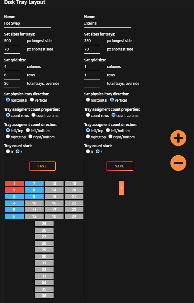

I'm trying to set up the 36 drive bay like you did in a previous post. I set my columns and rows as in your example and I get the following:
Any help would be greatly appreciated.
Hard to say when I have no idea of how you want it to look like..
First of all, try "Help" function, by pressing... Help-button for Unraid.
Other than that, the "override" use should be left alone for the most part (it's there mainly for compatibility for earlier versions, or special use cases). Rather add/use several groups. Else you specify <rows * columns> and leave "override" at blank (it will calculate itself). Override is used to add "+X amount of trays" to existing ones in that group, I don't think this would be so useful for most anymore.
So ex. 6 rows * 6 columns would give you 36 trays.

This is the post I'm trying to replicate:
As I said, avoid overrides. Create another group instead.
