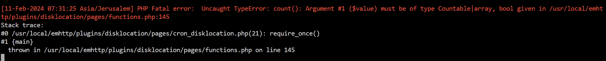

At the same time, php error log shows
10-Feb-2024 16:52:30 America/New_York] PHP Fatal error:  Uncaught Error: Call to a member function fetchArray() on bool in /usr/local/emhttp/plugins/disklocation/pages/system.php:438
Stack trace:
#0 /usr/local/emhttp/plugins/dynamix/include/DefaultPageLayout.php(760) : eval()'d code(21): require_once()
#1 /usr/local/emhttp/plugins/dynamix/include/DefaultPageLayout.php(760): eval()
#2 /usr/local/emhttp/plugins/dynamix/template.php(94): require_once('/usr/local/emht...')
#3 {main}
  thrown in /usr/local/emhttp/plugins/disklocation/pages/system.php on line 438

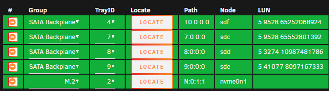

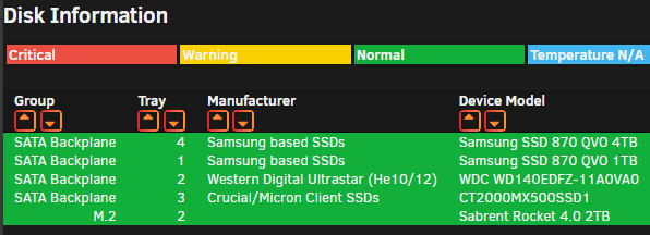

Why is my NVME drive showing as 'not present' ?
I dunno... hard to say. What did you try to do? Have you read the forum thread for possible solutions or which logs/output from commands you might give me that might be useful?
I haven't tried anything special, just wanted to add my single m.2 to the dash. I am curious how it can show device not present yet show me the SMART status and temperature. Let me know what logs you need.
Then
Then please read through the forum, at least the 5 last pages should give enough hints. I'm just gonna repeat myself over and over otherwise.
5 minutes ago, FlamongOle said:
Then
Logs attached, I do not see a resolution to my problem. Thanks.
momedia-diagnostics-20240219-1605.zip
7 minutes ago, FlamongOle said:
Why I am asking is, did you try "Force scan all"?
Yes, a few times, same result
The only difference with my nvme device is no LUN or FF is listed compared with my other drives which are all OK.
Edited by mikeyosm
As long as it has it's own serial number, you should be good to go regardless of what SMART-info it find from the devices.
The "Device not present" is just looking up on what Unraid has put it's state as. Do you see anything odd under "Main" tab looking at the drive there? Is the drive icon grey, or does it show something else?
Looks OK on the main tab
I think I know what it is. The nvme device does not give any status of if it's in standby or not, and as this is an unassigned device it won't receive the typical status from Unraid either.
I must find another way of checking the nvme devices. There's probably no reason to why it should report as active, idle or standby as an SSD. I have mine in ZFS and that gives different infos, so haven't seen or tested unassigned nvme.
I might come up with a fix later tonight, but I'll see what I manage and bother :P Regardless, nothing to worry about as the you get temps and SMART OK (which is enough to know it's present really).
I thought i might have something to do with unassigned devices/nvme, thanks for confirming. It would be awsome if you could fix it, the plugin is very useful and for me would make it 'complete'.
