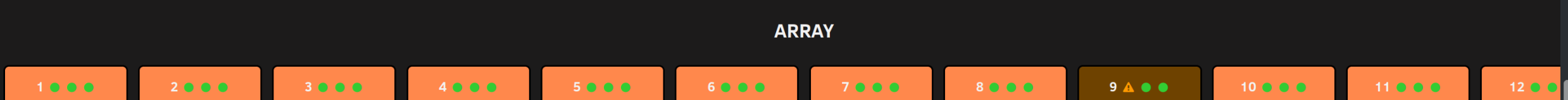

1 hour ago, itimpi said:
If you are rebuilding then all drives should be flashing as they are all used during a rebuild.
I never get multiple flashing.
And it doesn't match the system, or actual drive rebuilding...

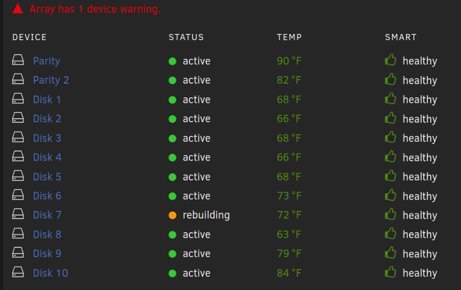

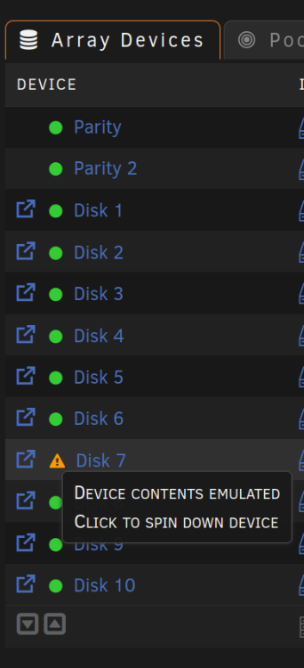

2 hours ago, House Of Cards said:
This isn't the first time I noticed this, so I thought I'd ask...
This plugin sometimes shows the wrong disk during drive swaps, etc...  For example...  I took Drive 7 offline to "no device", shut down and put in a bigger drive, restarted and applied the new drive to Drive 7.  The system is currently rebuilding, but this plugin shows Drive 9 flashing, even though 7 is actually rebuilding...
Any ideas?
Have you run "Force Update All"? It might be required. I haven't noticed what you describe here, but would like to know if this will help it.
The Overhaul '25 will work differently that a force update all will be executed during boot again, but would like to know if there might be another issue.
Is that safe during rebuild?  I got a few hours left...
I'd be happy to do it to let you know if you don't think it will affect the parity rebuild going on?
Edited by House Of Cards
Added additional information...
It will only read SMART data and store them in the database. That shouldn't be any problem.
It will process smartctl -a and lsscsi -bg, none which should impact anything. At least I never heard of that situation before. Disk Location will never write to the disks themselves unless specifically informed so. But right now, there is nothing that will do it.

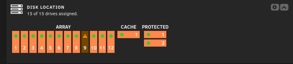

Nope.  Worse.  LOL
Nope.  Worse.  LOL
And the drive is not listed as "unassigned" in the plugin either? Maybe you need to allocate it to the tray now.
All this will be worked on when I get rid of the current database (hopefully)
The two missing are "unassigned" now, but I think it fixed itself after the rebuild was done, and/or another force update last time.  I'll see what it does.  It's nothing that matters much.  It can confuse you when you swap disks around, but I'm aware of it, so I don't pay it any mind during disk swaps.  Some others might think they removed the wrong drive and do something horrible though.
Let's see if the next version fixes it.  I'll let you know what happens when the rebuild is done.
Thanks for the plugin.  👍

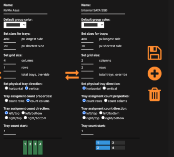

Overhaul '25 part 2 preview! Developer Edition only!
Most of the plugin now works, but still not recommended for production use. This overhaul went a bit more extreme than first anticipated, SQLite is mostly gone! Just two more (vital) "functions" to fix before it is "entirely gone*"! *The backup/restore functionality will be backwards compatible with the SQLite database, and it should be automatically backed up during install.
During all SQL conversion tests the new system will calculate quite a bit faster, we'll see how the total turns out in the end. Will benchmark it closer to release.
Some info from github: 30 changed files with 3,448 additions and 4,237 deletions.
Overhaul '25 milestone: https://github.com/olehj/disklocation/milestone/4
Correction from "part 1" post: "With that it will be hourly SMART updates on active drives.", will be every 12th hour instead. Don't want to prevent drives from sleeping. The SMART+DB update will be forced upon boot and installations from now on, like the old days. Pure SMART updates will be written to /tmp (memory).
disklocation_oh25-p2-preview.png.91f96754507f5887ad4a06972662a7a1.png Shiny new button
The News:
  • There will be a single "Save" button to rule them all for the "Disk Tray Layout", instead of the annoying single button per group.
  • Colors will be worked on, and a custom group color will be added as well (it's half-way implemented).
  • Some minor and easy reading benchmark will be added, most likely with added history so you can see how it performs over time. It will be as easy as using hdparm, so don't expect anything super-fancy.
  • Update buttons in System will have three levels: SMART (updates only active spinning drives), Force SMART (will wake up sleeping drives and update all), Force SMART+DB (this will do a Force SMART including writing to the database files on the USB drive (or wherever you have installed Unraid).
  • A hell lot of code have been rewritten and lots of bugs fixed (and probably added some too!)

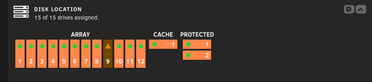

FYI...  After it rebuilt, I did a force update, and the disks were still unassigned.  I assigned them manually.
It would never assign itself automatically. New drives must be assigned manually after force update. Even after Overhaul '25 will that remain a thing, but at least it will update itself during boot, so it's ready to be assigned in the list.
There's no secure way of knowing for sure where a disk is inserted, logical paths might even change during reboots. And then if it stays stable, removing a drive and inserting a new one might create a different path. Then if you replace or add more than one, where does each drive go? Then you decide to swap or move HBA/raid card positions, creating a lot of new mess. Implementing something like this would probably just be a guesswork at best.
I have been looking into this earlier, trying to find something static, but it just can't be trusted.

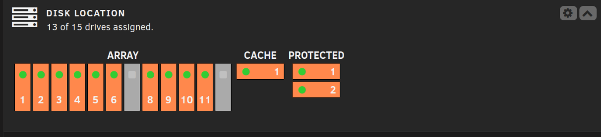

I just started my new NAS in unraid 7.0.0 and installed Disk Location first thing.
I can't seem to get any information about the drives to show up in the dashboard widget. Searching the thread, I see this has been an issue in the past but none of the solutions i've found have helped.
Is there a way to get this working?
What things?
Did you do a "force update all"? It's likely required on a fresh install. Current stable does not update during boot by default. This will be changed after Overhaul '25
1 hour ago, FlamongOle said:
What things?
Fair question! I installed disk location while my array was building for the first time. Once it was done was when I started tinkering in the Disk Location plugin. I just tried "force update all" and double checked on the installed plugins page that its up-to-date.
I'm still only seeing this on the dashboard widget. Is this all I'm supposed to see?image.png.abc4be51926ec631bc96e11a8ab848a4.png
That will just show you a quick overview with a combined "LED". The green background color might hide the "Green LED", but if you "hover" the left side of the boxes (where the gray LEDs are), you should see some summary of each drive.
Otherwise, rest will be seen at the plugin page click the cogwheel or Tools -> Disk Location
If you mean you missing drives, have you assigned them after force update?
Ah, I understand!
It seems I misunderstood what was available on the dashboard view. I had in my head that the info on the plugin page could be seen on the dashboard. Not sure where I got that idea, but thank you for clarifying (and hopefully having this interaction in the thread clears up confusion for any other new users)
