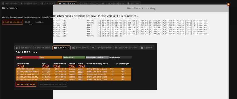

Common S.M.A.R.T Errors section added with the possibility to run "acknowledge all" - IF configured to allow Disk Location to edit Unraid config files (disabled by default). This will also be the case for device dates (manufactured, purchased, warranty).

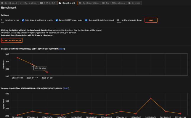

Benchmark completed, with screenshots. CSV export added.
Further bugfixes.. fixed etc. Debug function renewed and accessible from System.
This build is available now through "devel" and Overhaul '25 is now 90% complete (this might change).

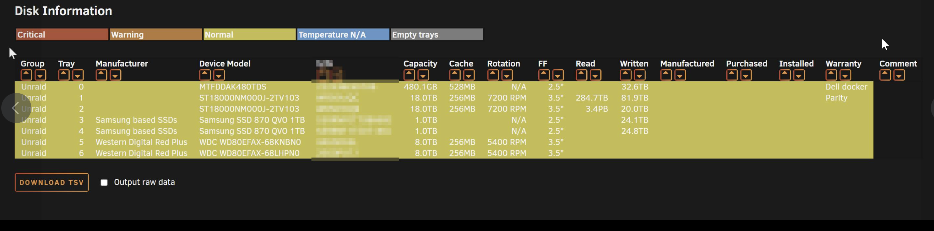

Benchmark running, preview of SMART-tab:
New Benchmark (values are expected to be flat, these values are fake):

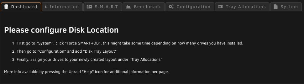

New info screen for new installations:
Edited by FlamongOle
Added screenshot of new install, modified from alpha2 to beta1

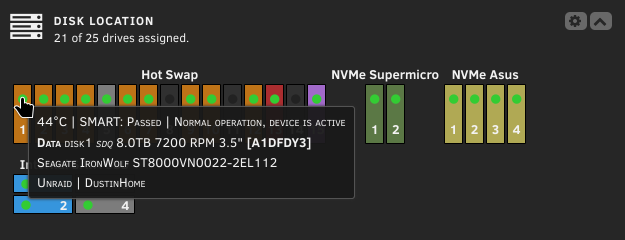

If possible, I have a minor feature request.
In DASHBOARD when "mouse over" on a drive it shows Temp, SMART, Operation, Online...
Could we perhaps have a second row (maybe optional with a setting?) with either disc name (disk 12, parity, cache_ssd) and/or the serial number of the drive?
i.e:
39° | SMART: PASSED, NORMAL OPERATION, DEVICE IS ACTIVE
S/N: K4J7NM0RB14934T | disk 12
It would give another way of easy identification.

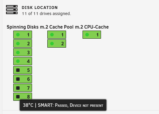

Hey, just noticed that 4 of my 8 drives are showing "Device not Present" but they are definitely there and working just fine.  Is this just a graphical glitch or does it mean something that I should be concerned about?  Drives 1-6 are all the same Seagate 16TB drives.  Drives 7-8 are WD 14TB drives.
Did you try to force update them?
Aha! I did not as I was just wondering why they would go into that state to begin with - never seen that before.
Update All fixed it.  Wonder if this is going to be a usual thing?
I also see that and have used forced update several times.
In configuration, this must be enabled, I think it's disabled by default:
"Automatic system boot and update scan"
This might/will make the system use a bit more time to boot up, however, this will be enabled in Overhaul '25 by default and can't be turned off anymore as it causes more confusion.
@Niklas probably info for you too.
To add some more, enable scheduled SMART update should also be enabled for drive update. This will also not be a thing in Overhaul '25 .. which I think is sort of ready soon. I just wait a bit after some more testing before releasing it.
i.e:
Yes!

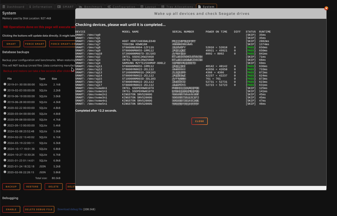

  1. First go to Tools -> Disk Location, open System tab and do a Force SMART+DB.

  • Commit #372 - FEATURE: Seagate SMART vs FARM LOG check in System tab added for checking fraudulent drives.

  • Commit #365 - FEATURE: Added selected dashboard info to LED "hover" info on Unraid dashboard.

  • Commit #352 - FEATURE: Disk Location plugin time benchmark added, but must be executed manually by entering ?benchmark=1 in the address field. Value is visible in the "System" tab.

  • Commit #277 - FEATURE: Added a small simple benchmark for read test (hdparm) with SVG graphs. Can be exported as CSV too.

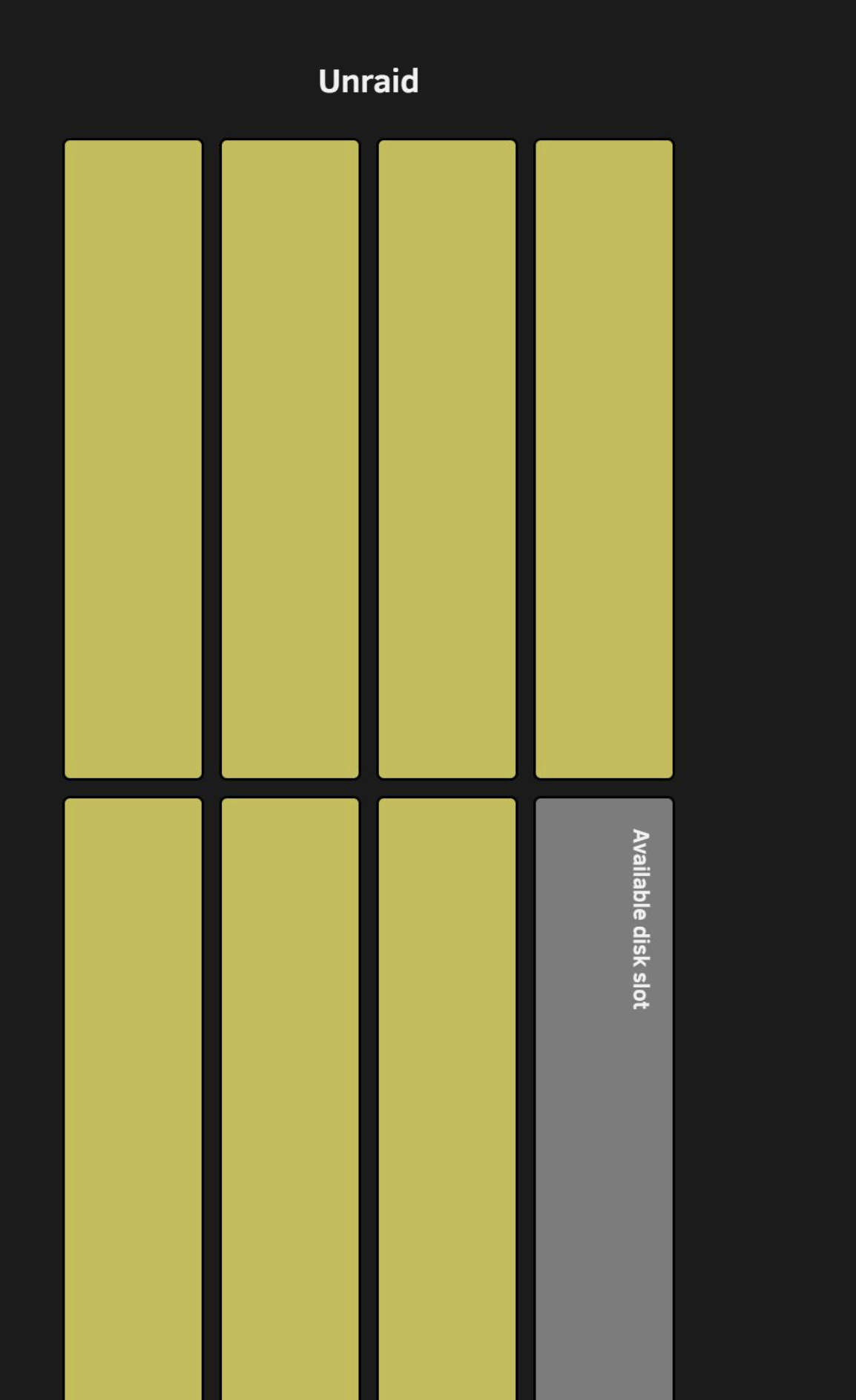

Despite disabling all of the LED options, all of the trays blink red regardless.
9 hours ago, Schwiing said:
Thanks for this overhaul!
Did you update SMART?
Was there a big red text at the start page telling you to perform it, or just all flashing red from the beginning?
Also if you open terminal and type:
ls /tmp/disklocation/
Do you see a folder called "smart"?
And if, does it have contents?
ls /tmp/disklocation/smart/
And btw. did you install the Overhaul '25 version (devel), or regular stable?
