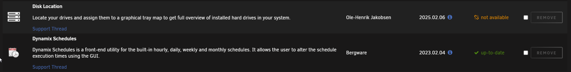

5 minutes ago, FlamongOle said:
Update 2025.02.07 - 2024-edition
  • Commit #368 - MINOR: Fixed an issue were "Fix Common Problems" would trigger a warning about unknown application in "Community Apps"
Won't show update available. Just "not available". I guess we'll need to use the url to upgrade?
It might take some minutes before its seen. Cache and stuff ;)
Like this:
Capture_ServerPlugins__Brave_2025-02-06_13-35-42_48259155.thumb.png.f1acbad273d847c79afb8970279583c6.png
1 minute ago, Niklas said:
Like this:
Yes, you must wait until CA update its database. I don't know how often it does it.

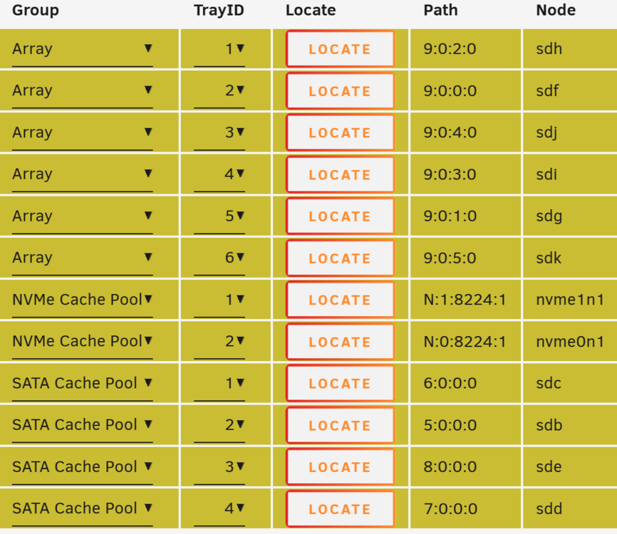

16 hours ago, FlamongOle said:
Set tray count start at 0
Hi :)
It is allready set?
5 minutes ago, DanielPT said:
Hi :)
It is allready set?
That's TrayID, not tray number. It's written in red bold text above it.

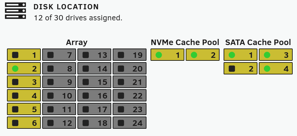

i have a lot of disks that has a black icon (device not present) as seen in the first image (from the dashboard). allt the yellow background ones should be green.
they are all very much present and working. so why is the plugin saying otherwise?
Edited by kakburken
You must do a Force Update All, if you have installed the newest stable version, this should now be fixed as Force Update All is executed at boot. What you see here is a misalignment between drives and drive PATH. Some of these LEDs might even be for wrong drives. I think I will adjust how this detecting works by using a different method. But for Overhaul '25.
i have been running the plugin for some time now, so wasnt a fresh install. and been keeping up with updates (was on the latest when i posted the question). not sure what you mean with boot, if you mean boot of unraid or boot (i.e start) of the plugin. but i havent rebooted unraid for quite some time now (since update to 7.0.0). ran a force update all now and seems that did solve it since they are all green now. thanks!
