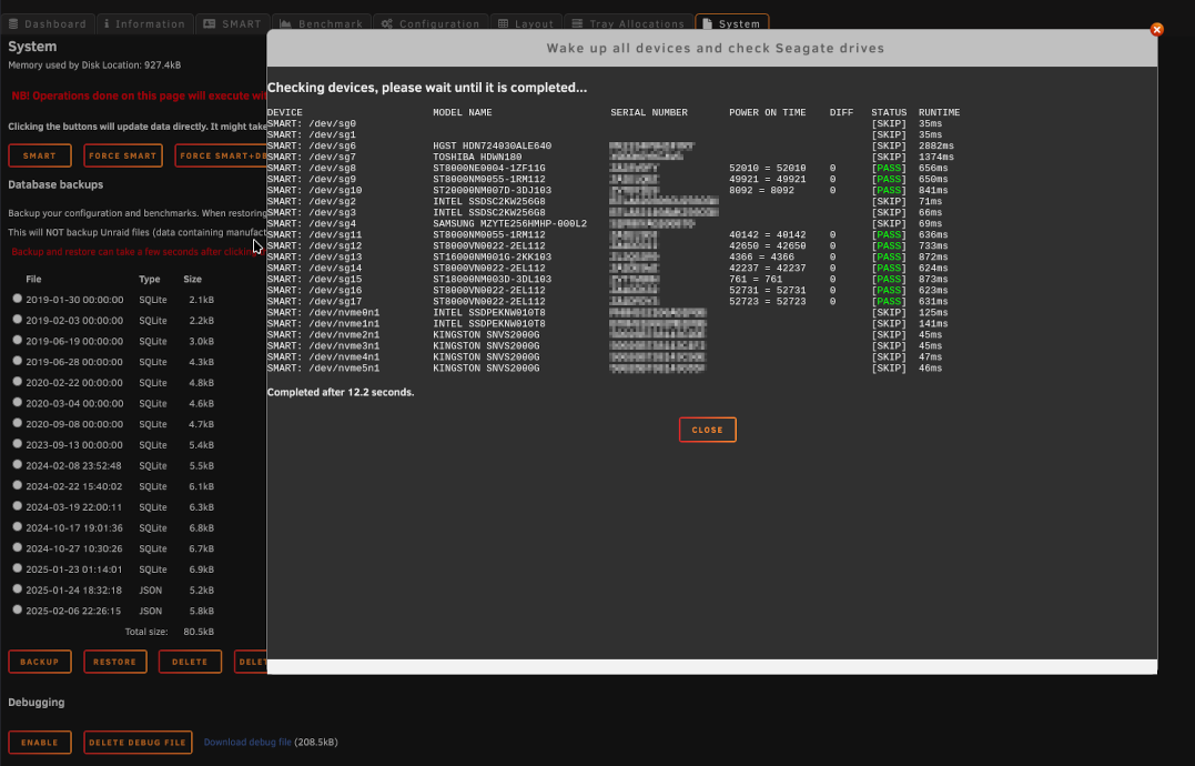

Added a Seagate HDD check in System tab due to a fraud likely caused by some miners.

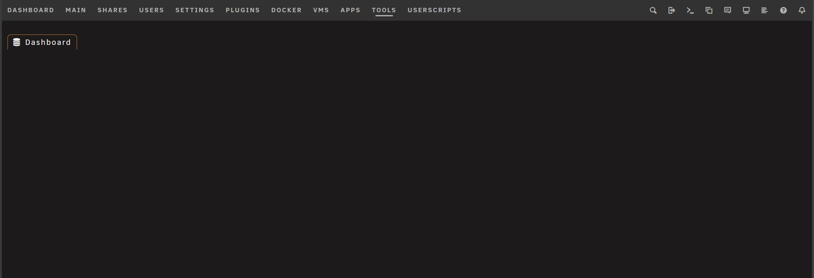

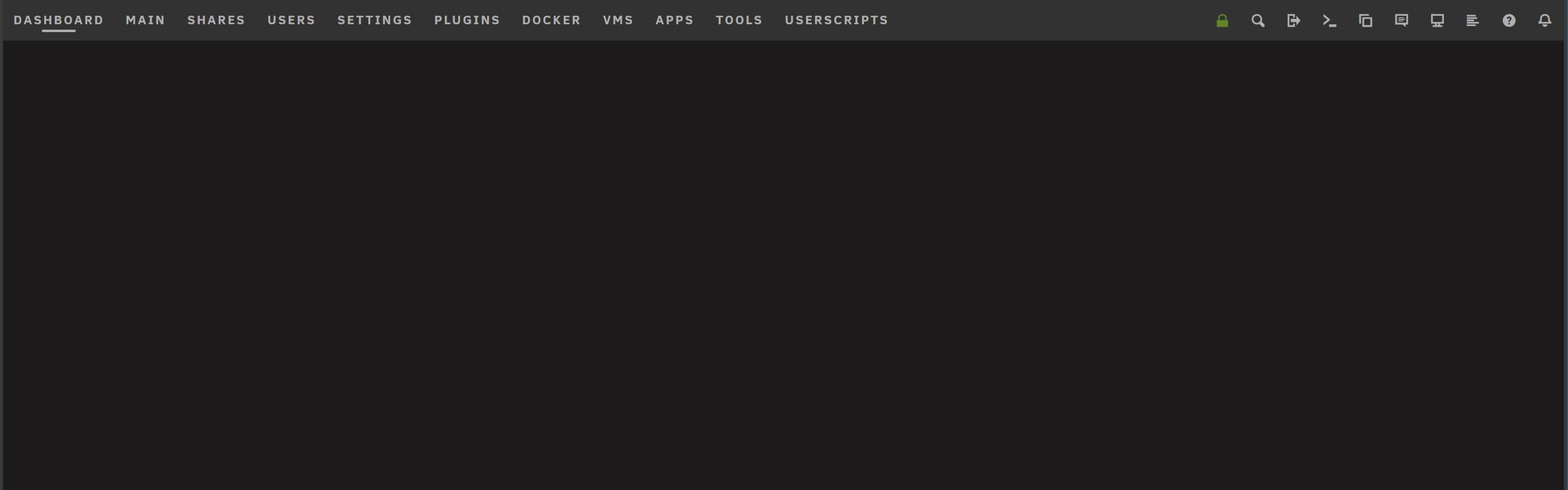

I updated from 2025.02.08-1936 to 2025.02.10-2201 RC2 just now.
My DASHBOARD page is blank and TOOLS/Disk location is also blank.
EDIT: Did uninstall and reinstall plugin. Same result..
Edited by PeterHS
Similar to @PeterHS but I updated from the non-devel 2025.02.08 to devel 2025.02.10-2201 RC2 and I also have a blank dashboard and Tools/Disk-Location page.  Spun up the array, dashboard remained blank (appears to be different than the dashboard crash issue of 7/2023).  Cleared cache and cookies, dashboard remained blank.  Tried different browsers, dashboard remained blank   Reverted back to stable 2025.02.08 everything came back normal.  Running Unraid 7.0.0.

Overhaul '25 update: 2025.02.11-1751 RC2
Same as previous, just git merge fixed.
@SShadow @PeterHS @mr2toyou
If this release seems fine, then the I will likely pull request it to master branch on 14.02 and release it as stable then.
2025.02.11-1751 RC2 did the trick for me.

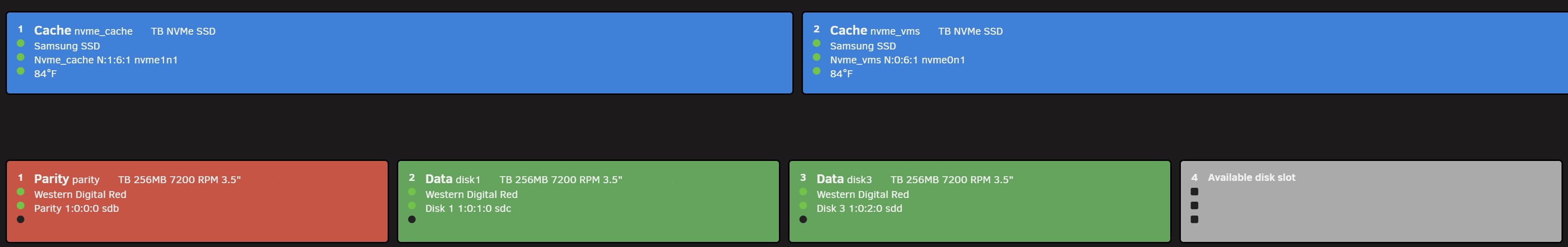

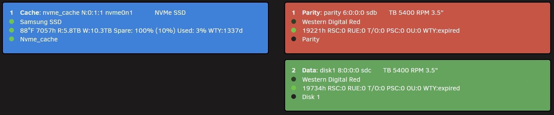

Do you have plans on adding the parameters from the 2024 version of the plugin to 2025?  Specifically these: Spare, Percentage Used, Power On Time, Data Read, Data Written, Load Cycles, Reallocated Sector, Reported Uncorrectable, Command Timeout, Current Pending Sectors, Offline Uncorrectable.
In the 2024 version I had almost every option checked as I liked the dashboard to be like a one stop shop for all important drive info.  Where I could see everything on one page instead of having to look at the individual drives.
The 2024 layout on my one server server:
The 2025 Overhaul layout on my other server:
If I had all the options from 2024 to customize the layout for 2025 that would be perfect for my use case.  Keep up the great work on the plugin!
No, the SMART errors are now just moved in the SMART section of the plugin instead. This will make it use SMART settings defined in Unraid config. I decided to not include it this time as it's more of a clutter anyway. (these: Reallocated Sector, Reported Uncorrectable, Command Timeout, Current Pending Sectors, Offline Uncorrectable incl. whatever you might have included from Unraid config).
But, "nvme_used" (Percentage used) still exists, just under another tag called "endurance" which is valid for both SSD and NVMe. Power On Time still exists, but two different formats: powerontime which gives you a calculated time "4 years 3 months" etc.. and powerontime_hours which gives you raw hours. Load Cycles still exists, but not included by default (loadcycle).
Press "help" button, and entire list will show up of what you can choose per table.
