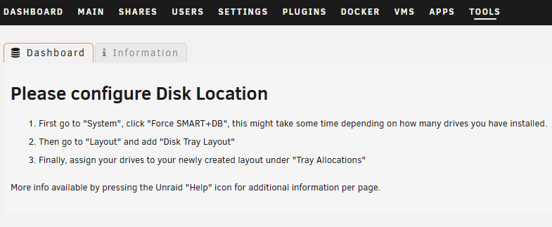

Blank dashboard after latest update
@JLKunka do you mean the dashboard tab in the plugin itself?  Like the picture below?
Both, the plugin dashboard and the main dashboard.
Gotcha, I think I did this to my system testing this morning.  In one of the tests I forgot to run Force Smart+DB very first thing.  I ended up deleting the file below:
/boot/config/plugins/disklocation/groups.json
After I deleted the file all the tabs came back and then I made sure I ran Force Smart+DB before doing anything else.  😁
Edited by SShadow
Deleted the file you specify, now the dashboard for the plugin shows this:
"Information" tab is blank. Main dashboard works again.
Edit: Hoping these changes will not delete the arrangement and tray locations I have set up !!

@JLKunka not sure, is this a new install or an existing one with backups?
Installed disklocation a few days ago, got everything set up with my disk arrangement (four sets: Front Panel, Icydock, USB, and Internal). The Disklocation updates in the last couple days broke it. Running Unraid 7.0.0 on a Dell Poweredge R730, eight 3.5" bays.
Edited by JLKunka
1 minute ago, JLKunka said:
Installed disklocation a few days ago, got everything set up with my disk arrangement (four sets: Front Panel, Icydock, USB, and Internal). The updates in the last couple days broke it. Running Unraid 7.0.0 on a Dell Poweredge R730, eight 3.5" bays.
@JLKunka as long as you have a backup you should eventually be ok.  From terminal in Unraid run this command:
ls -la /boot/config/plugins/disklocation/backup/
This should show if you have backups.  During testing today I was deleting the file I listed along with some others to test like a new install.  I was able to restore from backup every time successfully.  If you don't have a backup then I apologize you would need to recreate the config.  I did not run into your exact issue only having the dashboard and information tabs.  @FlamongOle might need to assist with the issue you are having.

There is a backup directory i found while browsing for the json file to delete. Is there a short instruction set to restore the plugin from backups, or do you move and overwrite the files in the root plugin directory?
@JLKunka if you had access to the system tab doing a restore is super easy choose the backup file and press restore.  Are you running the latest update 2025.02.16?  There was a bug in update 2025.02.15 that the system tab was blank in certain situations.
Edited by SShadow

Well I got impatient and did some experimentation that fixed this. First I copied everything under /boot/config/plugins/disklocation as a precaution. I then deleted the plugin and reinstalled. Nothing changed until I manually deleted the files shown here:
When I reinstalled the plugin, all the tabs were back. After running "Force Smart + DB", I restored the backup file and my previous configuration was still there.
Edited by JLKunka
@JLKunka awesome!  You did exactly what I was going to eventually suggest but I wanted to make sure you had a backup file before I suggested it.  Nice job!  Enjoy!
