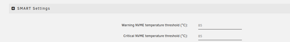

I have a question regarding the retrieving of the hot and max temps for specific drives. For me it looks like the plugin is "just" getting the information of those temps from the global disk setting "Default ... disk temperature threshold".
Issue is currently for me, that I have also configured different temps for nvme and ssd drives which are stored in different unraid attributes like "Default ... SSD temperature threshold" or for nvme drives "... NVME temperature threshold" directly in smart settings.
Unfortunately, this leads to the issue that my nvme and ssd drives are mostly give me warnings because of the warning temps for usual hdds.
It would be great if the plugin could retrieve the correct temps for a specific drive type :)

I was actually not aware that it exists a global default SSD setting until now. Plugin uses the old regular default and drive specific now. Thanks for the heads-up. Looking into it tomorrow.

Hi :)
Thank you a lot for the improvements.
But I guess there is one circumstance not taken into account or when I read it in the code commits correctly. Because there is also a separate setting for hot and max temps just for nvme drives. I don't know if its retrievable via the global var scope. Its located in UI code here -> https://github.com/unraid/webgui/blob/9126eb419ac67e8fac12ff4ddba82885a91038c6/emhttp/plugins/dynamix/nchan/update_2#L180C5-L180C12
You can find it in the unraid UI not in global disk settings but in smart settings of an nvme drive only:
There's no (visible) global for NVMe specific devices, but I saw that NVMe does not grab the SSD temps as default from Disk Settings (maybe an Unraid bug).
However, while testing this, the plugin uses global SSD for NVMe as well, except if NVMe is defined per device. Seems like the NVMe temps from dynamix source merges into the same value.
True. You are right. So when I set the value explicit it is stored in hotTemp  and it works correctly in disk location-> https://github.com/unraid/webgui/blob/master/emhttp/plugins/dynamix/DeviceInfo.page#L1380
Without it seems to be always retrieved and calculated by get_nvme_info -> https://github.com/unraid/webgui/blob/master/emhttp/plugins/dynamix/include/Wrappers.php#L180
Whic
h is also used in those settings as placeholder via makeTemp -> https://github.com/unraid/webgui/blob/master/emhttp/plugins/dynamix/DeviceInfo.page#L113
But thank you anyway for all the effort especially when you think about the non documented tangled unraid code🥶

  • Commit #400 - IMPROVEMENT/MINOR: Added cronjob to use NVME data for warning and critical temperatures (this will be collected during a Force SMART+DB update). This should now follow Unraids default settings.
@s11 I was mistaken about the last conversation about this, nvme hot and max was not part of the global variable at all, so had to fetch the data myself. This version should be more correct!
