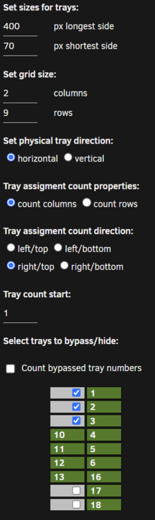

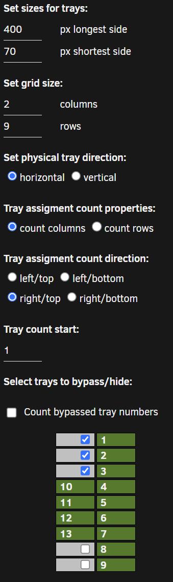

Good morning!
I've got two questions, and I'm sure they are something I must be missing...  Thanks for a very nice map that my OCD loves!  And thanks for any help/pointers!
#1 - In the Tray Allocations tab, I can't select a custom color - they appear to be disabled.  I've tried in Safari on Mac, Safari on iPad, and Firefox/Chrome/Edge on Windows.
#2 - I'm having some difficulty getting my tray configuration the way I want it.  What I'd like to see:
Here's what I get with "Count bypassed..." UNchecked:
And here's what I get with "Count bypassed..." Checked:
