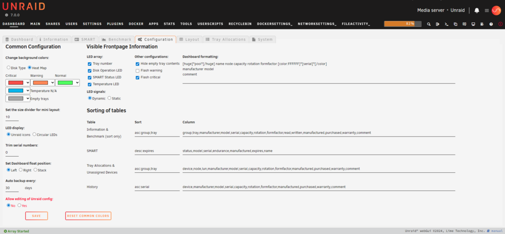

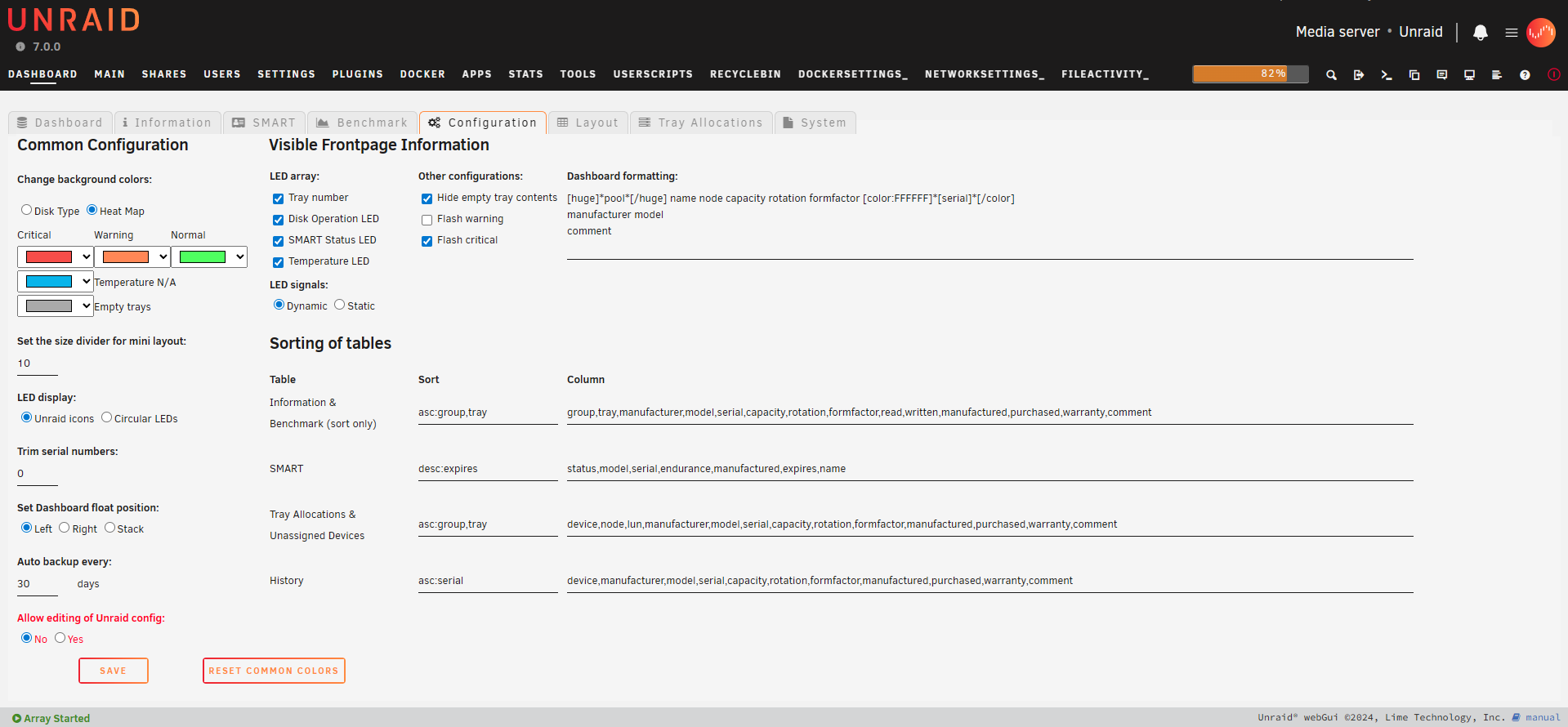

this is the config settings, and its also deleted all the Purchased and Warranty info on all the disks :(
Edited by Hellomynameisleo

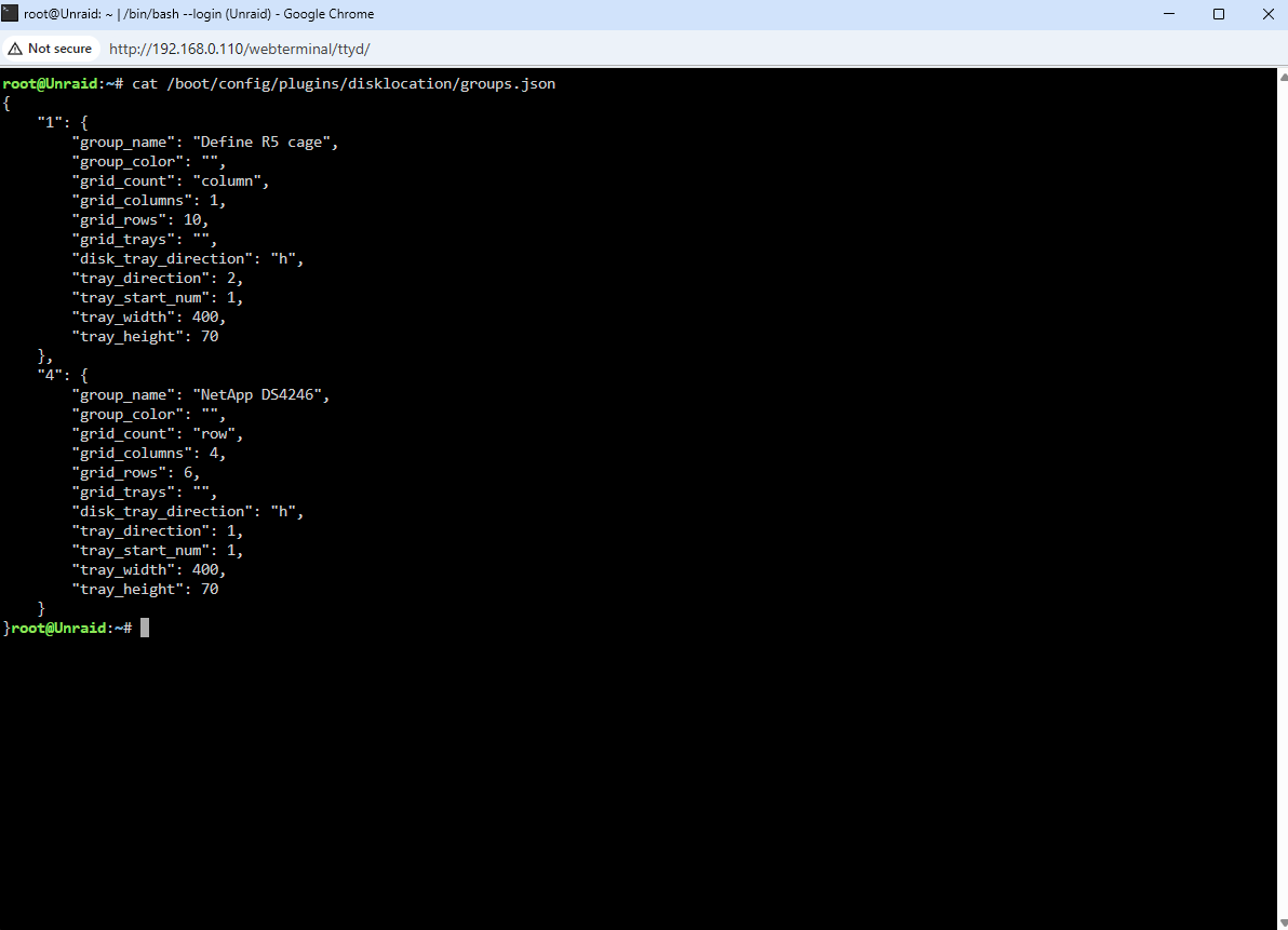

Sorry, was maybe a bit unclear. I need the Layout config. You can give me the output of this instead of screenshots:
cat /boot/config/plugins/disklocation/groups.json
Purchased and warranty is not carried over anymore from the database and should only use the settings from Unraid config itself. There's a command some few pages back where you can receive the dates (if you still have the sqlite file, should be backed up too). Then you can add them either via Disk Location (if "Allow editing of Unraid config" is set to "Yes") or the normal Unraid way. I added the post in the recommended section.

thanks heres the config:
I will look into why this happens later, but you can change your config to be more correct anyway:
Tray assignment count properties: count rows
Tray assignment count direction: left/top
