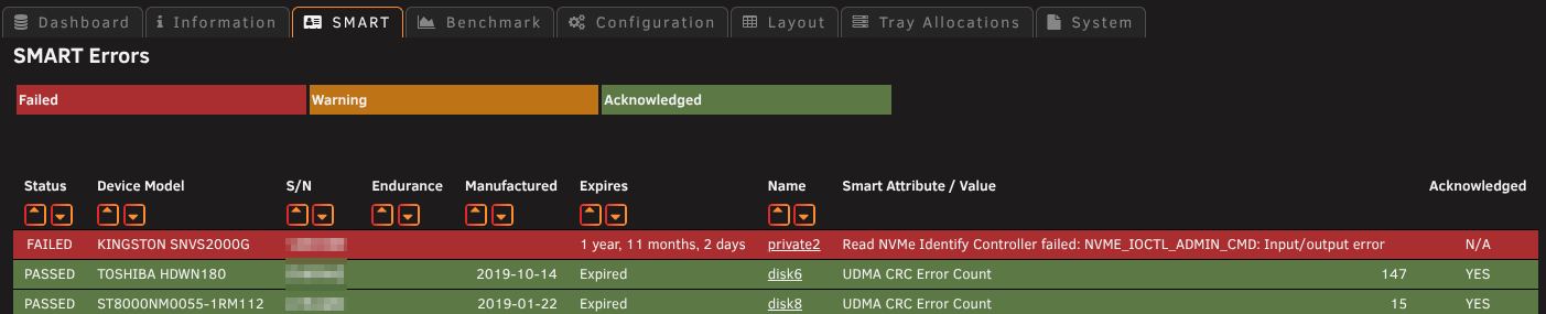

2 hours ago, Thx And Bye said:
With all drives working now, the plugin is showing the status on the dashboard as expected.
One odd thing (but nothing critical): My flash is showing a S.M.A.R.T warning while the drive itself reports S.M.A.R.T as passed based on an Attribute check.
I understand that a SATA SSD attached to a USB<->SATA adapter isn't the usual setup for the flash. Just an odd thing I've noticed.
Does it have unacknowledged SMART errors detected? Check SMART tab in Disk Location and check if the device show "NO" under "Acknowledged"
These warnings have higher priorities than the over-all health status.

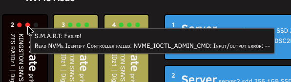

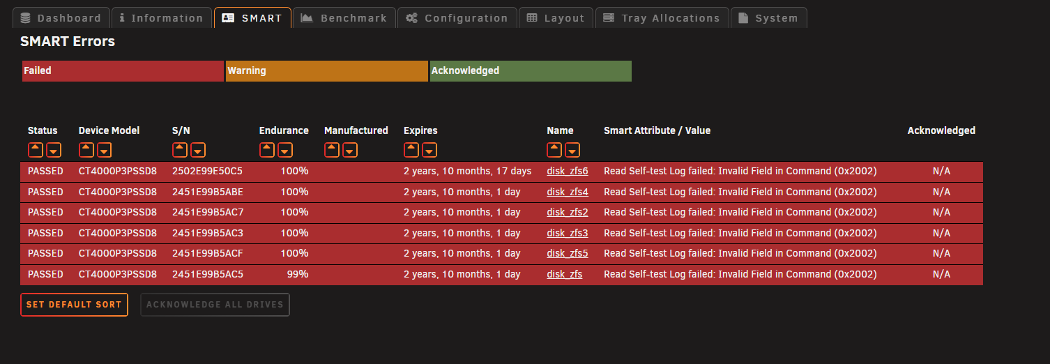

Yes, I have that kind of NVMe drive right now :P
Hello everyone,
I've got this alert and I didn't have it before, so it's not a problem for me. I'm posting a message here to let you know and, if necessary, to help.
1 hour ago, Midas_Tech said:
Hello everyone,
Thanks, I have reordered some code to prevent that. Next release will hopefully fix this and also add notification to dead drives.

@Midas_Tech this version, then a SMART update should hopefully fix it!
Happy Norwegian Constitution Day release! 🇳🇴🥳
Hello,
Thank you for your message. I've installed this latest version and can confirm that it's OK again!
THANK YOU!!!
It does indeed list one value there for the drive (Reallocated_Sector_Ct is 1) but as unRAID shows "No Attributes Available" for the flash there is no way to acknowledge the error.
This SSD is quite old already and also connected via USB. So I'm not sure if it's because of the age, the connection or UnRAID not knowing how to deal with this situation (the flash having attributes in the first place). Starting S.M.A.R.T tests for the flash also doesn't seem to work.
Smartctl is seemingly able to read the values, albeit not absolutely correctly since 109 years of power on time doesn't seem plausible to me.
Likely how it's connected or that the controller for it does not pass through Smart or something. Usually Flash is never even included in Disk Location as it's mostly just pen drives. I have no plans to implement it either.

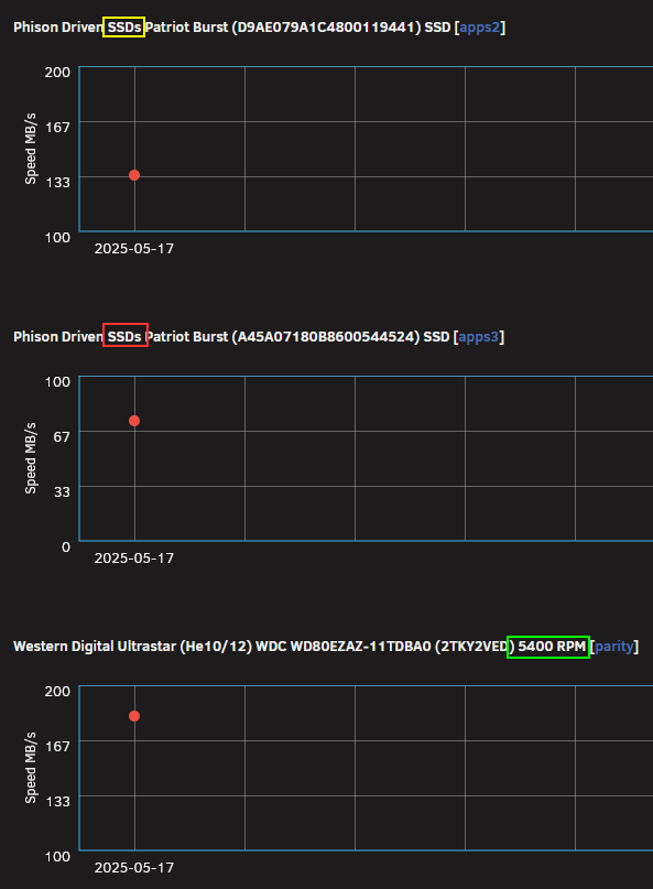

OK, gotta ask... Do these numbers make any sense at all???
How is it that an SSD is reading at ~80MB/s while a 5400RPM drive reads more than 2x that speed??
I understand that these may not be the fastest SSDs ever made, but still...
Is this an indication that maybe the drive is dying, or was it probably just in use by something else at the time of the speed test?
Can be several things. If the drive is in use while benchmarking, the values will be lower.
But likely this is the actual speed of the SSD, cache is bypassed (which you'll often see higher speeds from). Some SSDs are in fact just slow in read and write, but they still feel faster than spinning drives because of no seek time.
