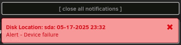

Ok, thanks. All people that reboot (or scan smart) will probably get this alert if on latest plugin until this is fixed. There's one report in the bug reports part of the forum.

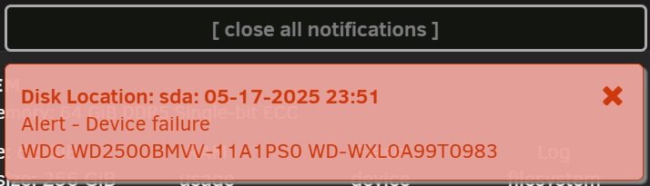

    Update 2025.05.29 Commit #446 - BUG: Fatal error in page_system - causing furious rage in the forums :P Syntax error, misplaced parentheses 😅 @Mr Q I have an idea for you. Why don't you save your o
  • You guys please settle down.  The fact that sqlite support was in php in the first place was an oversight.  We never intended that a plugin would utilize a database application and honestly, I didn't
I had to reboot one of my servers tonight and can confirm I got the alert, definitely got my attention.  I am running 2025.05.17 version of the app on Unraid 7.0.1.
I rebooted my other server and received the error but it actually showed a drive that was from the deleted devices list from the devices.json file.  This was a drive I used for initial testing but not sure why it was picked up as device sda.  That is not a big deal but I wanted to mention it in case it helps @FlamongOle with code troubleshooting.
Thanks!

Update 2025.05.19
  • Commit #425 - BUG: Flash devices etc. alerted falsely. Added more SMART checks to prevent this from happening.
FORCE SMART+DB update must be done for those affected with this bug.

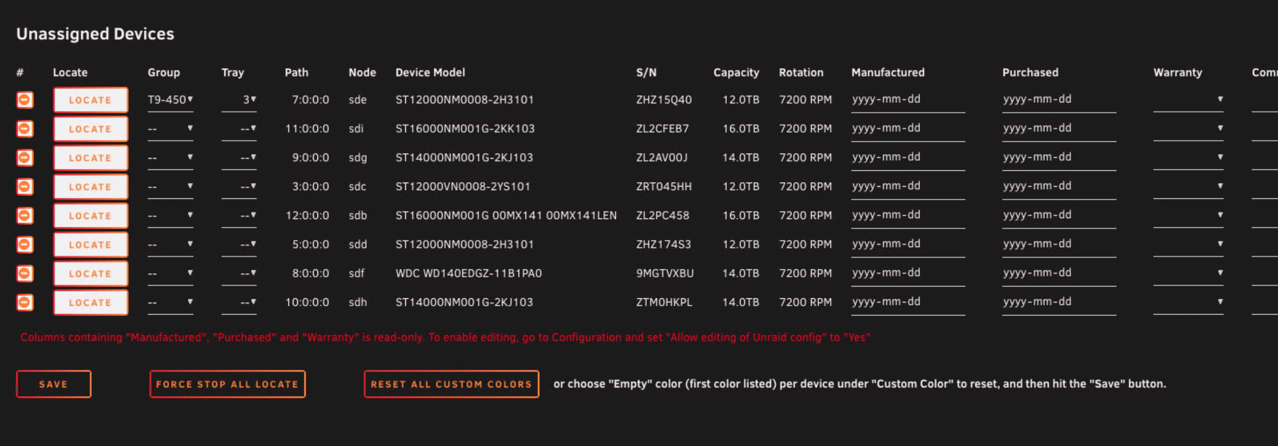

Update 2025.05.22
  • Commit #430 - IMPROVEMENT: Assignments are now done with physical tray layout, and not TrayID (it's still TrayID under the hood, but hidden from GUI).
  • Commit #429 - IMPROVEMENT: Added possibility to reset temporary files. Reset "temporary files" under System tab will now delete SMART data and others in tmp. Force SMART required after execution.
  • Commit #428 - ENHANCEMENT: Fetch more data from SMART files rather than DB. SMART files in temp folders holds more recent data, so this will be prioritized when reading increasing parameters.
  • Commit #427 - MINOR: Benchmark for removed devices visible. Hide benchmark for removed devices, these can still be retrieved by raw download.
@Frank Ruhl and @CheekyPanda (and probably others), you should be happy now (#430, if it works :p)

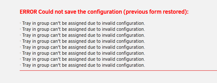

Just installed this plugin, it looks really nice but I'm having some issues. When I use the locate function, it does not light anything up on my HDDs. Additionally, whenever I try to assign any drive to a group/tray and hit save the screen goes blank (attached image) and if I click back into the plugin nothing has saved.
Please give me the relevant output of the php log.

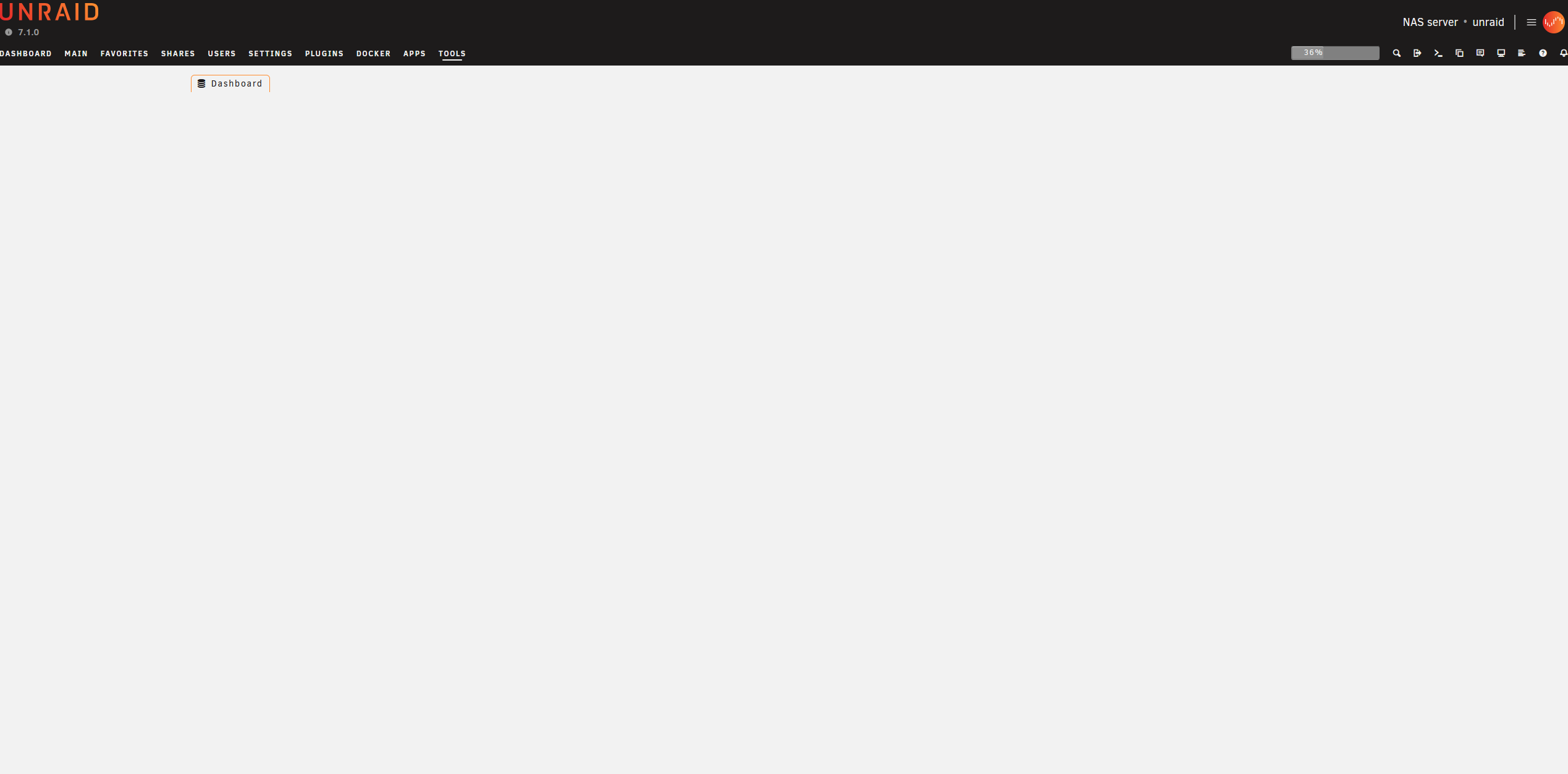

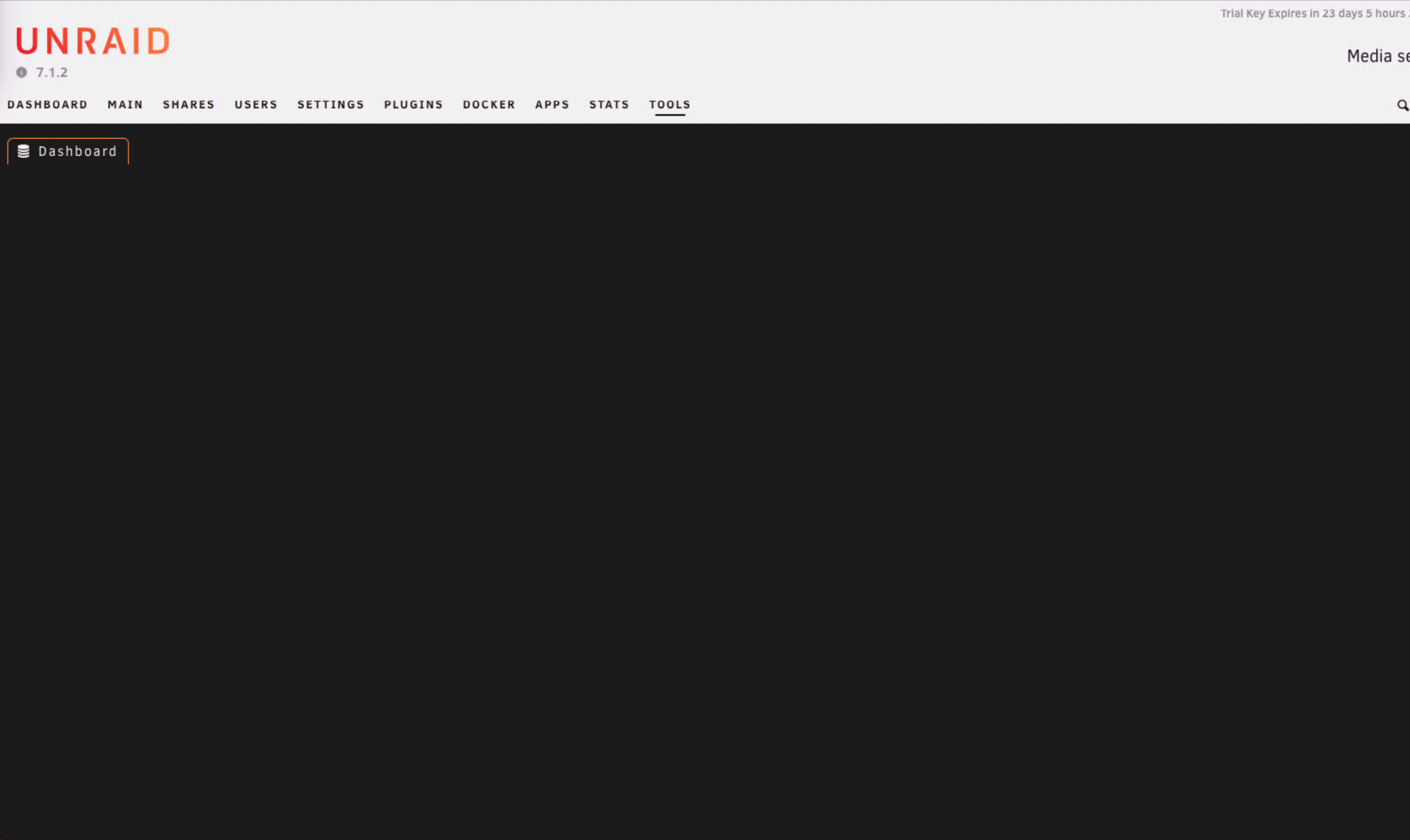

Hey everyone, maybe I'm missing something, but I can't seem to get this plugin to work.
Every time I try to assign a location for a drive and try to save I just get this black screen that does nothing. Then when I reload or go back into tools it hasn't saved the location.
I've wiped and reinstalled twice, but it's still the same thing. Am I missing something or is this a bug? Any help would be great! Thanks!
Do you create stuff from scratch, or do you expand current setup?
[23-May-2025 19:44:18 America/Chicago] PHP Fatal error: Uncaught TypeError: array_search(): Argument #2 ($haystack) must be of type array, null given in /usr/local/emhttp/plugins/disklocation/pages/system.php:280
Stack trace:
#0 /usr/local/emhttp/plugins/disklocation/pages/system.php(280): array_search('', NULL)
#1 /usr/local/emhttp/plugins/dynamix/include/DefaultPageLayout.php(854) : eval()'d code(11): require_once('/usr/local/emht...')
#2 /usr/local/emhttp/plugins/dynamix/include/DefaultPageLayout.php(854): eval()
#3 /usr/local/emhttp/plugins/dynamix/template.php(94): require_once('/usr/local/emht...')
#4 {main}
thrown in /usr/local/emhttp/plugins/disklocation/pages/system.php on line 280

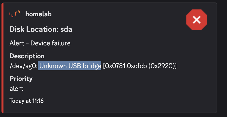

I just set this up from scratch
this is related to plugin? as my usb is healthy on Unraid
root@homelab:~# cat /var/log/syslog  | grep sg0 -A 10 -B 10
May 24 11:15:24 homelab kernel: scsi host0: usb-storage 6-1:1.0
May 24 11:15:24 homelab kernel: hub 7-1:1.0: USB hub found
May 24 11:15:24 homelab kernel: hub 7-1:1.0: 5 ports detected
May 24 11:15:24 homelab kernel: usb 7-1.1: new high-speed USB device number 3 using xhci_hcd
May 24 11:15:24 homelab kernel: usb 7-1.2: new high-speed USB device number 4 using xhci_hcd
May 24 11:15:24 homelab kernel: input: Linux 3.18.0 with ast_vhub SMCI HID KM as /devices/pci0000:40/0000:40:08.1/0000:49:00.3/usb7/7-1/7-1.2/7-1.2:1.0/0003:0557:9241.0001/input/input1
May 24 11:15:24 homelab kernel: hid-generic 0003:0557:9241.0001: input,hidraw0: USB HID v1.00 Keyboard [Linux 3.18.0 with ast_vhub SMCI HID KM] on usb-0000:49:00.3-1.2/input0
May 24 11:15:24 homelab kernel: input: Linux 3.18.0 with ast_vhub SMCI HID KM as /devices/pci0000:40/0000:40:08.1/0000:49:00.3/usb7/7-1/7-1.2/7-1.2:1.1/0003:0557:9241.0002/input/input2
May 24 11:15:24 homelab kernel: hid-generic 0003:0557:9241.0002: input,hidraw1: USB HID v1.00 Mouse [Linux 3.18.0 with ast_vhub SMCI HID KM] on usb-0000:49:00.3-1.2/input1
May 24 11:15:24 homelab kernel: scsi 0:0:0:0: Direct-Access     SanDisk  SDDR-B531        2920 PQ: 0 ANSI: 6
May 24 11:15:24 homelab kernel: sd 0:0:0:0: Attached scsi generic sg0 type 0
May 24 11:15:24 homelab kernel: sd 0:0:0:0: [sda] 15712256 512-byte logical blocks: (8.04 GB/7.49 GiB)
May 24 11:15:24 homelab kernel: sd 0:0:0:0: [sda] Write Protect is off
May 24 11:15:24 homelab kernel: sd 0:0:0:0: [sda] Mode Sense: 21 00 00 00
May 24 11:15:24 homelab kernel: sd 0:0:0:0: [sda] Write cache: disabled, read cache: enabled, doesn't support DPO or FUA
May 24 11:15:24 homelab kernel: sda: sda1
May 24 11:15:24 homelab kernel: sd 0:0:0:0: [sda] Attached SCSI removable disk
May 24 11:15:24 homelab kernel: floppy0: no floppy controllers found
May 24 11:15:24 homelab kernel: Freeing unused kernel image (initmem) memory: 3068K
May 24 11:15:24 homelab kernel: Write protecting the kernel read-only data: 20480k
May 24 11:15:24 homelab kernel: Freeing unused kernel image (rodata/data gap) memory: 76K
May 24 11:16:06 homelab rc.local:   inflating: /tmp/disklocation-packages/disklocation-master/disklocation/pages/styles/signals.static.css
May 24 11:16:06 homelab rc.local:   inflating: /tmp/disklocation-packages/disklocation-master/disklocation/pages/system.php
May 24 11:16:06 homelab rc.local:   inflating: /tmp/disklocation-packages/disklocation-master/disklocation/pages/variables.php
May 24 11:16:06 homelab rc.local: Extraction done.
May 24 11:16:06 homelab rc.local: Installing files...
May 24 11:16:06 homelab rc.local: Backup was made in the recent 0 days or backup is disabled, skipping.
May 24 11:16:06 homelab rc.local: Configuring...
May 24 11:16:06 homelab rc.local: Stylesheets: signals.dynamic.css activated.
May 24 11:16:06 homelab rc.local: Installing cronjob...
May 24 11:16:06 homelab rc.local: System newly booted, gathering SMART data
May 24 11:16:06 homelab rc.local: SMART: /dev/sg0             FAILED   ()            done in 706ms.
May 24 11:16:06 homelab rc.local: SMART: /dev/sg1             ACTIVE   (126039c927)  done in 292ms.
May 24 11:16:06 homelab rc.local: SMART: /dev/sg2             ACTIVE   (8ce62c94e6)  done in 307ms.
May 24 11:16:06 homelab rc.local: SMART: /dev/sg3             IDLE     (026f3709ba)  done in 126ms.
May 24 11:16:06 homelab rc.local: SMART: /dev/sg4             IDLE     (a78f0e580a)  done in 121ms.
May 24 11:16:06 homelab rc.local: SMART: /dev/sg5             ACTIVE   (4f572a265a)  done in 136ms.
May 24 11:16:06 homelab rc.local: SMART: /dev/sg6             IDLE     (31127881ac)  done in 121ms.
May 24 11:16:06 homelab rc.local: SMART: /dev/nvme0n1         ACTIVE   (0b9a281004)  done in 79ms.
May 24 11:16:06 homelab rc.local: SMART: /dev/nvme1n1         ACTIVE   (b98b2cb3ac)  done in 52ms.
May 24 11:16:06 homelab rc.local: SMART: /dev/nvme2n1         ACTIVE   (e8085398ba)  done in 59ms.
May 24 11:16:06 homelab rc.local: Writing to the database... done in 2.4 seconds.
Edited by noonamer
Yes, just ignore this. I thought this was already fixed, looks like I need to look a bit further into this
Update 2025.05.24
  • - Commit #433 - MINOR: Unknown USB bridge alert. Alert message popped up on devices that shouldn't be marked as failed. Added another variable check to prevent false reports.
  • - Commit #432 - BUG: Multiple users reported blank screen when saving drives to layouts, checking if its an array, otherwise set variable to null.
Haven't had time to test it properly, but please give it a go. @noonamer @zdzosel @awestera

This seems to have solved the issue for me, thanks! I do get this error for the drives I haven't assigned yet, but it assigns the ones I did choose and the error isn't really an issue.
Edit: I still can't utilize the locate function, but it could be some issue with my hardware... I'm not sure. My top LEDs work fine, but the bottom ones utilized for locate are not lit up at all. Anyways, I'll probably have to manually locate them when I get a chance to stop and start the array a few times.image.png
Edited by zdzosel
Ah! Thanks for that info, now I remember why this was earlier ignored to post an error message :P I'll remove that again unless I find a way to distinguish that.
Update 2025.05.25
  • Commit #435 - MINOR: Saving tray allocations with unassigned devices throws error messages. Added a check if the variables are empty or not. If the value is empty, then it will be ignored, otherwise throw error for specific configuration.
3 hours ago, FlamongOle said:
Update 2025.05.25
I updated and no longer receive the error message.👍
