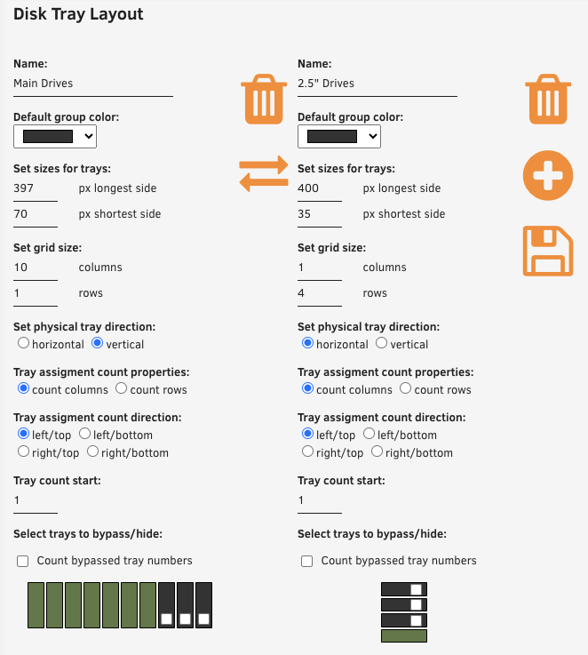

2 things I am noticing when I looked at this today:
My 'Layout' starts like this:

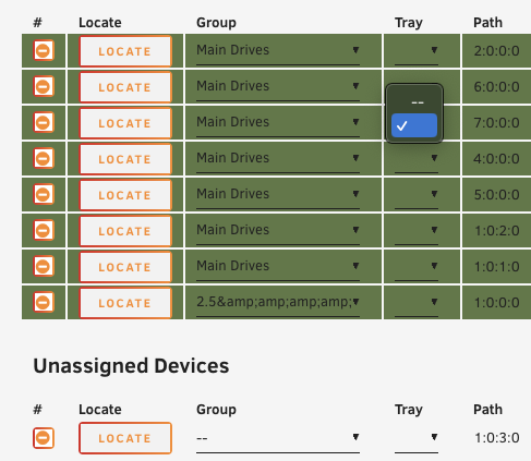

But if I save the 2.5" Drives then it ends up as 2.5" Drives :

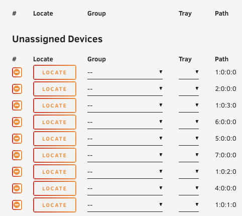

On the 'Tray Allocations' tab, the tray dropdown is empty for all of my drives (for both groups):
And when I try and assign that 'Unassigned' disk to the 2.5" group and click save, it just ends up removing all of my assignments (presumably because the 'Tray' is blank for all of them maybe?):

5 hours ago, devalias said:
Unraid: 6.12.10
Disk Location: 2025.05.25
Haha, whoops!
This likely happens that you have hidden numbers on the trays, and why underneath it can't connect TrayID with Physical tray number :P I didn't have that in my mind, but it should probably be easy to fix.
The 2.5" problem seems to be catching on a htmlspecialchars/htmlentities loop where it tries to format itself. This should be easy enough to fix as well. But I believe the name will extend every time you save it with additonal "amp;".
Update 2025.05.26
  • Commit #438 - MINOR: htmlspecialchars duplicate where it tries to format itself in the group names. Removed htmlspecialchars from the variable to be stored in json array, it's not needed as it is read by htmlspecialchars.
  • Commit #437 - BUG: Assigning not working and deletes all assigned devices if tray numbers are hidden. Added bypassed variables to the array instead of variables that were unset.
@devalias should be fixed now :)
