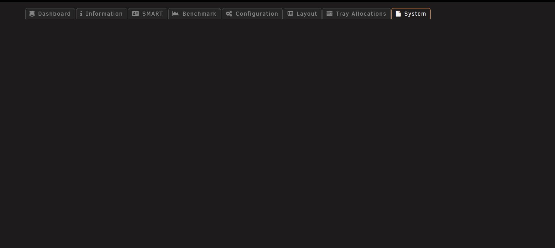

dude you have be awesome. but it is now throwing this error and "system" tab won't render. have tried to uninstall and re-install.
[28-May-2025 10:23:58 America/Chicago] PHP Fatal error: Cannot use isset() on the result of an expression (you can use "null !== expression" instead) in /usr/local/emhttp/plugins/disklocation/pages/page_system.php on line 357
Yes I can confirm I have the same issue, the system tab is just blank for me I have only just installed the plugin for the first time.

Im experience the same error with the "System" tab.

I'm another "blank system tab" person. Running 7.1.2. Looked like an interesting plugin, but I can't get it configured as the first step says, "Go to the system tab" but nothing is there.

Same error as some others here, blank system tab and unable to create layout or change location etc after updating the plugin to 2025.05.28. Running 7.1.2.
The log output shows this error:
May 28 21:23:59 ****** webGUI: error: /Tools/disklocation - missing csrf_token

Update 2025.05.29
  • Commit #446 - BUG: Fatal error in page_system - causing furious rage in the forums :P Syntax error, misplaced parentheses 😅
@Mr Q I have an idea for you. Why don't you save your own health by deleting this plugin then? 😅 I don't think anybody forced you, if I'm wrong, then they're bad people!
The rest of you: well.. update :P

Thanks for the update. Systems tab is working and I was also able to remove the old disk.

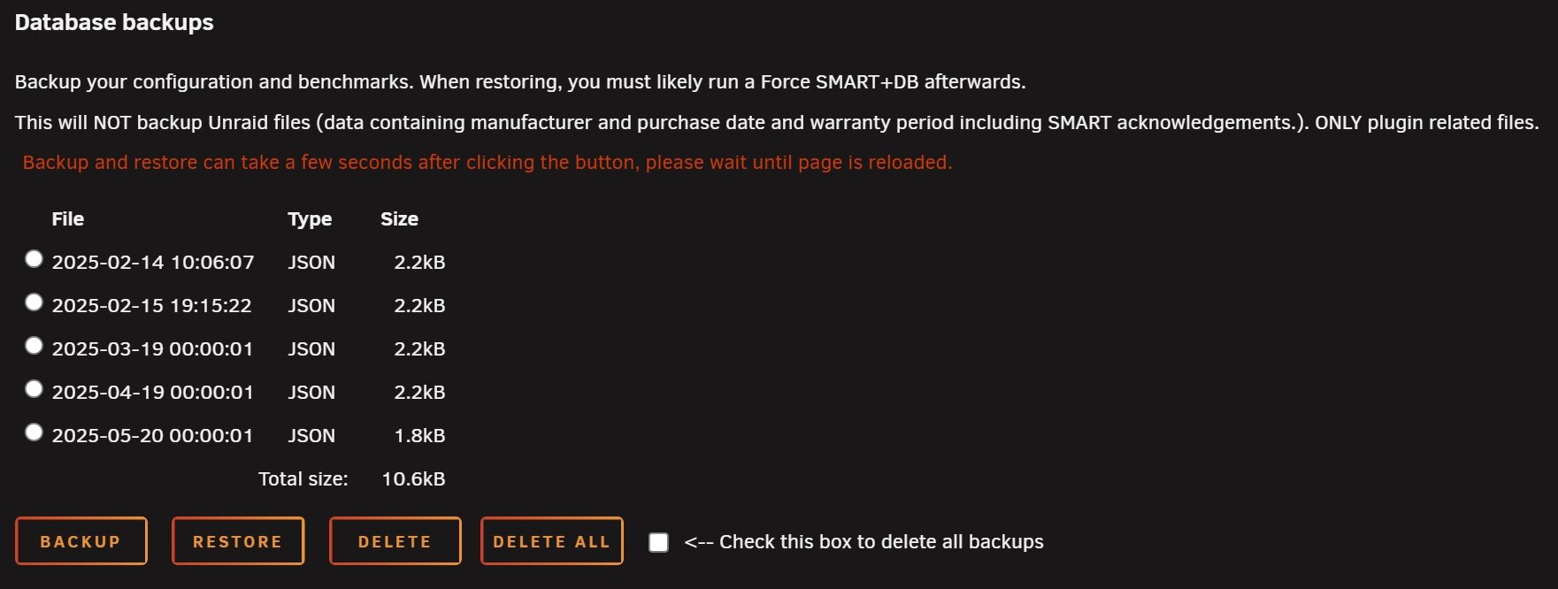

I have noticed an issue with automatic backups.
I have configured it to take backups every 30 days but nothing seems to happen.
During updates I get the following output
Backup was made in the recent 0 days or backup is disabled, skipping.
Even through the last manual backup is several days old.
Manual backups work fine however.

@Starfiresg1 I have seen the "Backup was made in the recent 0 days or backup is disabled, skipping." message too when updating. I never put much thought into it because the backup did eventually run on its own. I made the assumption that the backup would run 30 days from my last manual backup, but it did not work that way. The screenshot below is from my server showing the last 3 backups as automated.
@FlamongOle I don't know how you have the backup date/time coded but would it be possible for the user to set a specific date/time in a future release? I leave my server on all the time, for me when the backup runs is not a big deal but others who put their servers to sleep it might be. When would the backup run for a server that is put to sleep, would it run after startup from missing the date/time you have set the auto backup? Just curious. Thanks!

How old? It will only create a new one if the oldest is MORE than 30 days (unless configured otherwise). Either by plugin update or midnight cronjob.
It will only create a new one if the oldest is MORE than 30 days (unless configured otherwise). Either by plugin update or midnight cronjob. @SShadow remember there's less days in February, so the jump is larger. It's only 30 days, not specific day each month.
If you want to schedule your own backup plan, this has been available since launch but never added to "Help" :P I think I wrote it in here once for the specific update. Anyway, disable automatic in the plugin config, then use "User Scripts" plugin or add this to your own crontab:
php -f /usr/local/emhttp/plugins/disklocation/pages/page_system.php backup silent
("silent" is optional. Right now the output is silent regardless, but it will change next release)
Help text is added in next release, planned later today/tomorrow, but this is added:
  • Configuration tab help: Run auto backup every set full days, 0 to disable. Disable this if you plan to schedule auto backup on your own. See help under "System" tab.
  • System tab help: If you want to schedule your own backup cycle, disable "Auto backup" under "Configuration" tab. Then add this command into your scheduler (e.g. User Scripts or crontab):
    php -f /usr/local/emhttp/plugins/disklocation/pages/page_system.php backup [silent]
Edited by FlamongOle
