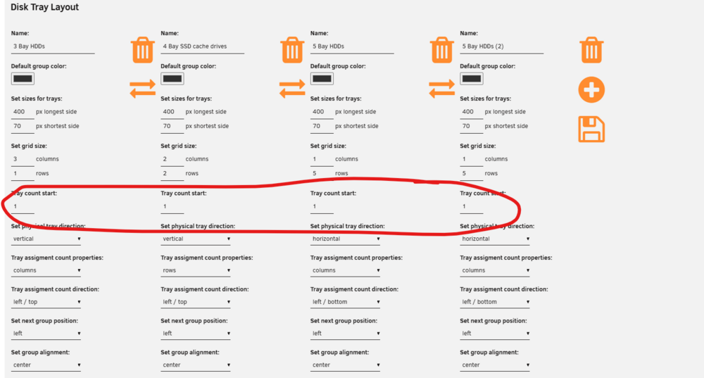

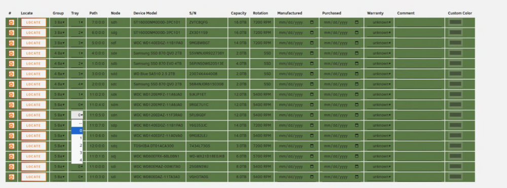

53 minutes ago, FlamongOle said:
Not much I can do with that info. Have you adjusted the start count to be "1" and not "0"? If it can't save, there's something conflicting, like trying to assign 5 if it doesn't exists but in your case could be 4. I don't have your config, so can't test.
I appreciate your reply! Yes all of my tray count starts are set to "1".
But in the tray picker it has me picking trays 0-4
Do you have any suggestions? Thanks again
Edit: I read through some of the other posts and based on this post, I tried to switch the tray assignment count direction from left / bottom to right / bottom and I was able to select the correct tray numbers.
Edited by CtznSnips
Ah, this is a weird bug. But easy to work around:
If you have only 1 column, set "Tray assignment count direction" to either "left/top" or "right/bottom" the two others are mainly only meaningful if you have more than 2 columns and then it works.
You can see it at the bottom, once the assignment is wrong, you will likely see something like disk order: 1 0 0 0 0, instead of 1 2 3 4 5 etc.

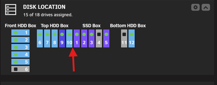

Seems we missed space here between Boxes:

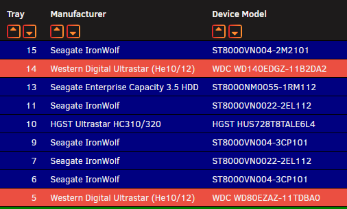

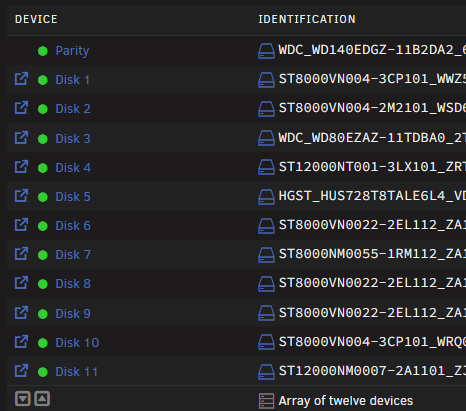

I've been using DiskLocation for ages and really appreciate it!
Unfortunately, I have an issue with the drive color display.
I have this peach/orange color for the parity drives
And my device information screen shows
Which seems cool, except that I only have 1 parity drive (the bottom WD in tray 5), not 2!
On the Tray Allocations page, there's a "Reset All Custom Colors" button and it also says "or choose "Empty" color (first color listed) per device under "Custom Color" to reset, and then hit the "Save" button." but I'm not sure where this "Empty" color is. When I click one of the color buttons on the Config page, I get the standard (really old) Windows color chooser
Is one of these supposed to be the "Empty" color?
I did just try the "Reset All Custom Colors" button and it did reset the tray 14 color to blue (it used to be my parity drive, so it's not totally unreasonable that it would have been the parity color).
I've spent 15 minutes or more messing with this and being confused by it. I guess there isn't any issue per se, but I think that maybe the button could use a title text change (maybe I didn't have custom colors, because they didn't change - I've had this running for ages and am very appreciative of your work!), and the additional text could use some additional clarity - maybe it was written on a non-Windows based system that presents the user with an "empty" color option.
Or.... it just hit me, the "Empty" color is the grey color. Was I supposed to chose that one? Would that have reset just the one parity drive?
Maybe I'm just being dense, but this is a bit confusing to me and there is no help around this particular option.
Maybe the issue is just that I don't know what the default colors are, so having to push the "Reset All Custom Colors" button is a bit scary because I don't know how much work I'd have to do to get it back to the way it is (with the exception of the incorrectly colored drive).
Maybe something that indicates that a color is changed from the default might be helpful. I ended up selecting all the colors and screen shotting the hex codes for them in case I needed to reset everything to these colors because I decided I didn't like the defaults...
@Free Man The colors goes in this priority:
disk > group > common
If "disk" has a custom color, then it will override both "group" and "common", regardless what the others are set to. If "group" has a custom color but "disk" doesn't, "group" color will be chosen over "common"
To reset color per disk or group, the "common empty color" should be used to reset. That is whatever the "empty" color is specified as, not the original Disk Location color, unless if that's being used.
This is rather intentional as it gives more flexibility for various layouts. If you just wanna add an empty section, you can add number "11" and hide it. Or just create a new group consisting of just 1 tray, move it in between, then hide that.
