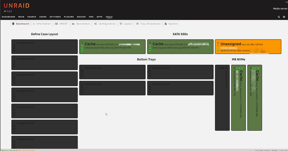

I added two drives (all other drives remained the same), and the entire "Define Case Layout" column no longer has my drives assigned.
Will this come back on it's own after the 2 new drives are formatted (disk clear is in progress) or do I need to do something else to restore the config? The two new drives are currently formatting (20+ hours and counting)

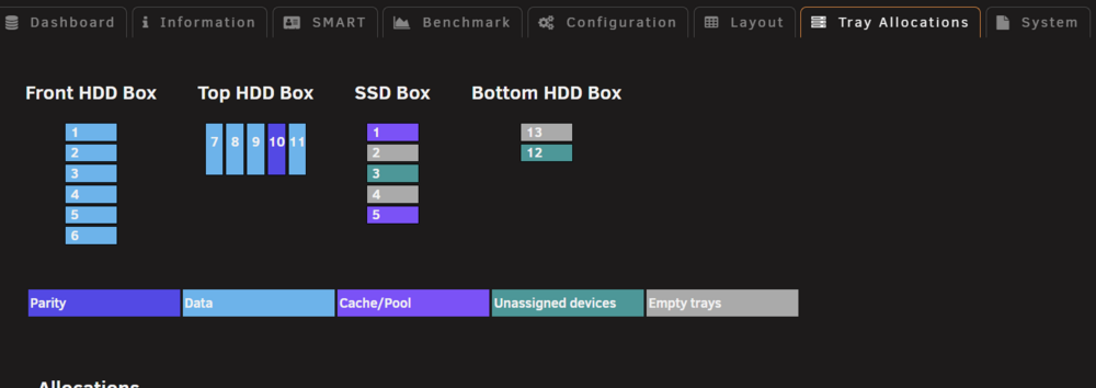

New drives must be added under "Tray Allocations", after they are added and saved, they should not dissappear. Doesn't matter what content is on the disks, it only care about the hardware itself.

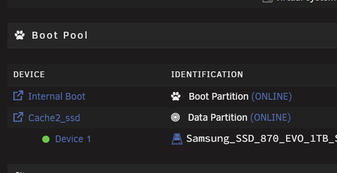

But can you tell me what flash2 was? Usually "flash" is the Unraid USB memory, flash2 would then be like a mirror or so, or just another USB drive? Maybe you use Unraid 7.3 already with the system on disks instead?
Reason I ask is if flash2 is a typical device name in Unraid somehow, or if it's sort of "hidden" behind "flash" and that's why it didn't acknowledge it.
Ooh yeah, that makes sense for the full 100%.
I had an failing USB drive with Unraid OS so I had to migrate ASAP to the Internal Boot function in the beta (no worries, no prod or customers env).
Replaced the USB flash disk so it's only being used now for licensing.
Thanks for the help!
2 hours ago, FlamongOle said:
nope
Flash and flash2 will be the drives in an internal mirrored boot pool.
SSD Box disk 3 = Boot data Pool , but has color is of unassigned disk , can be fixed or need plugin updates ?
Use custom colors, no ETA on implementation yet.

Custom colors must be reset to use the default colors, but that's optional. For split devices between flash/boot and other pools on the same disk, only the "Boot" is listed as the name.

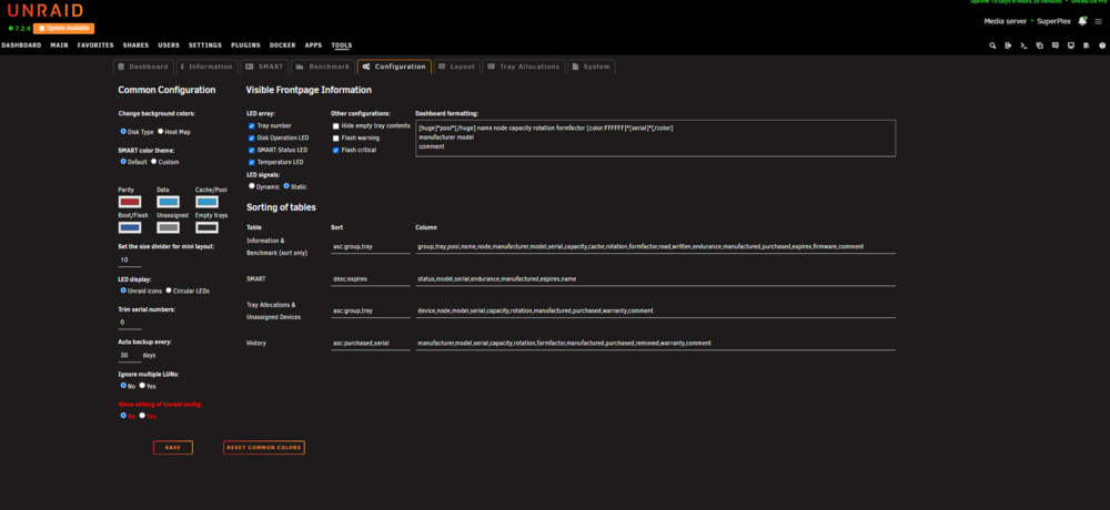

Can't do much without debugging file. I would also like a screenshot of your "Configuration" page please. I'm unable to reproduce this without any additional information.

2026-06-05 17_50_08-Greenshot.pngdisklocation-2026-06-05.log
Understood, Here you go. Disk8 is currently flashing but will actually pass SMART.
