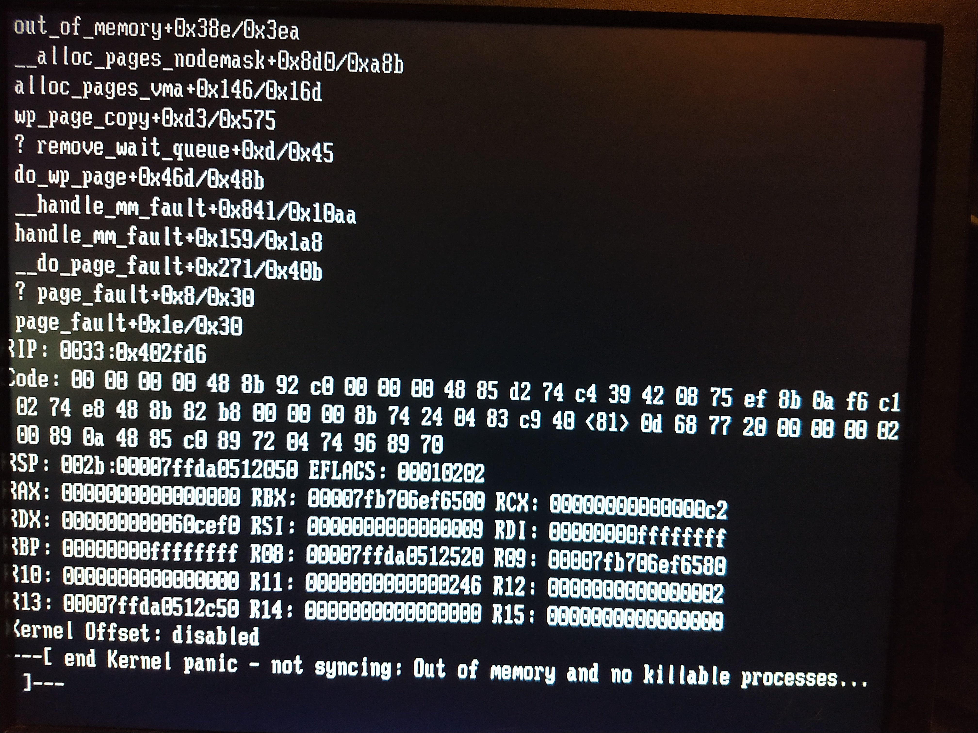

Been having multiple issues recently and haven't been able to complete a parity check for a couple of months as after a few hours of running the check the server freezes with this output:
It also sometimes has a kernel panic if not doing a parity check if left powered on for a couple of days. I have 7 other example kernel panic photos I can attach if anyone wants to see as only the bottom 3 kernel lines are the same each time.
I've run 6 passes on memtest (about 6 hours) and no issues found but I know it's recommended to run that about 24 hours to be sure. Happy to do that if advised.

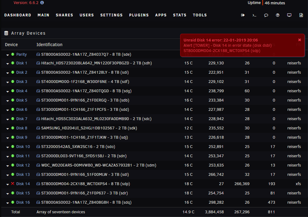

The new disk is using a different SATA port and cable to the errored one but again tonight when I've powered the server up it has disabled disk 14 again (screenshot below) with a load of errors across the disks on my 8 port SATA card (SuperMicro AOC-SASLP-MV8 PCI-E x4 8-Port SAS). Disks 10 to 16 and the original errored one are on it which leads me to think that might be failing.
Could that cause an out of memory issue?
Seems to be picking them off one by one! I don't have any other spare SATA ports to move disks around to test unfortunately. BTW the GUI looks gorgeous using Dark Reader :)
After a reboot there have been no further errors whereas before the logs were full of red ata lines in the "tower-diagnostics-20190122-2010 emulated disk 14 errors.zip".
I've seen in the link below that the kernel panic out of memory issue can be caused by processes on the server consuming all the memory. How would I check for that please?

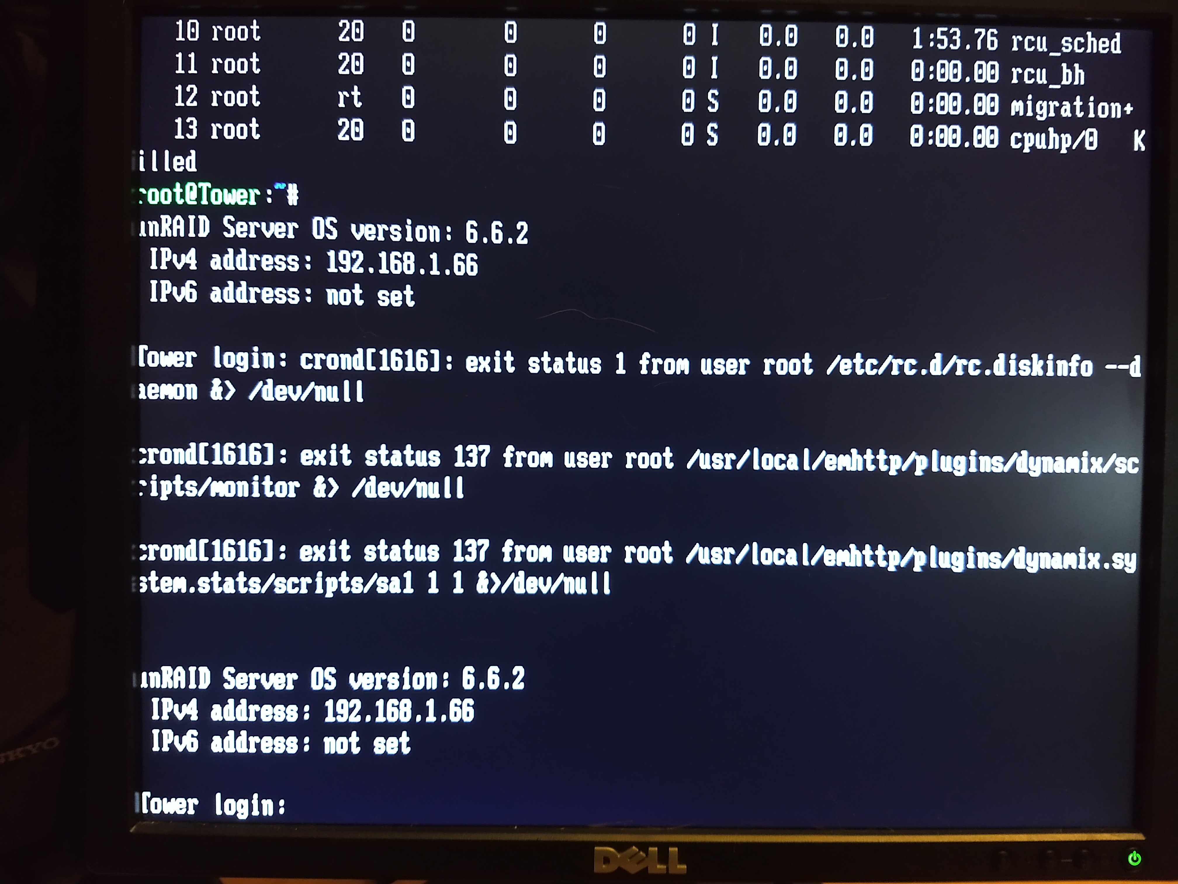

There was one time when it froze it displayed the output below when I'd left top running to try capture anything when it froze. I'm guessing that was just stating which process were being stopped to free up mem. When I logged in it immediately did the kernel panic.

There appears to exist a problem with the SASLP controller, some syslog errors, it's not passing SMART info and not spinning down disks, because of this it's spamming the log and making it very difficult to analyze, it could also be what's causing the problems, and since those controllers are not recommended anyway for other reasons I would suggest you try with a different one, preferably an LSI HBA.
