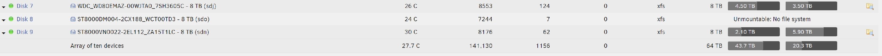

Came back up and my disk 8 (never had any issues before) is now unmountable (no file system). diagnostics attached.
I was going to do an xfs repair, but wanted to check in with the pros first :)

Looks like that is the way to go.
you can confirm if this is likely to fix things by:
  • Stopping the array
  • Starting the array in Maintenance mode
  • clicking on the problem disk in the Main tab
  • select the option to run a file system check
The initial check is read-only, but assuming that gives sensible output you can rerun without the -n flag to actual fix the disk
that worked - thanks!
